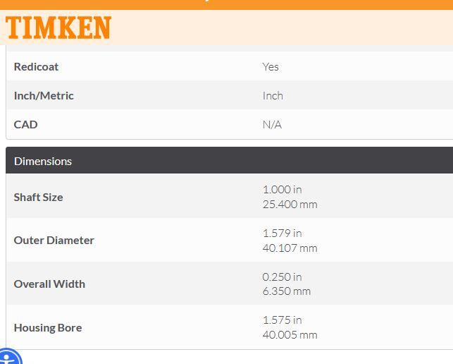

peter lena 9,559 #9 Posted February 21, 2022 @Pilgrimtim maybe this Timken # will work , 473380, from one grampa to another , pete Share this post Link to post Share on other sites
pfrederi 19,278 #10 Posted February 21, 2022 I do not think the timken one will work if the OD is 42 mm as shown on the baggie for the tuff torque part Share this post Link to post Share on other sites
