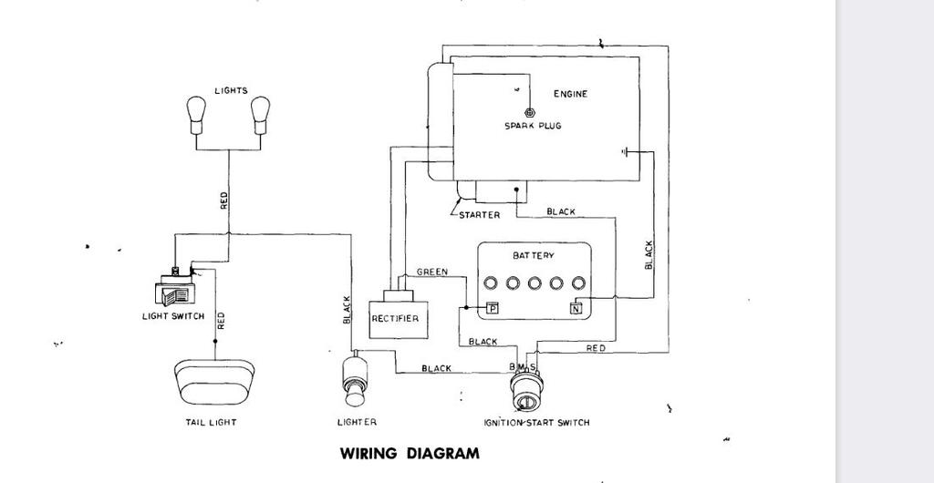

pfrederi 20,062 #3 Posted February 12, 2022 You have a magneto points ignition system. Your battery is only used to crank the engine and run the lights. The stator provides AC power to the voltage regulator which converts it to DC. It is attached to the battery via the R terminal on the ignition switch. Not using lights a fully charged battery will start you many many many times. Hook up your multimeter you should show 13.5 to 14.5 when the engine is running 6 Share this post Link to post Share on other sites
pfrederi 20,062 #4 Posted February 12, 2022 (edited) I just noted yours is a 68 It would have a 3 terminal ignition switch Your regulator is wired directly to the battery not through the switch Edited February 12, 2022 by pfrederi 3 Share this post Link to post Share on other sites

Floyd Pink 44 #6 Posted February 12, 2022 22 minutes ago, pfrederi said: I just noted yours is a 68 It would have a 3 terminal ignition switch Your regulator is wired directly to the battery not through the switch Everything is wired correctly. Must be the switch as I discovered the terminal is loosen inside of the switch or the new battery is defective 2 Share this post Link to post Share on other sites

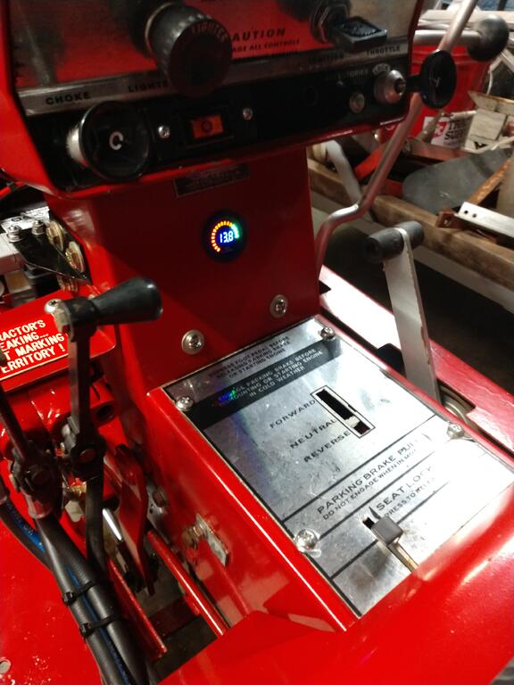

kpinnc 17,499 #18 Posted February 13, 2022 (edited) Add a voltmeter. They are cheap (6-8 bucks on Fleabay) and you can attach the positive to the orange wire that powers the cigar lighter. Negative straight to a ground. It only powers when the keyswitch is in the run position. Even at idle, mine charges pretty good. At least this way you know whether you have a charging issue or a weak battery. Full throttle it charges at about 14.5 vdc. With the engine off, you should read about 12.6- 12.8 vdc. Edited February 13, 2022 by kpinnc 3 Share this post Link to post Share on other sites

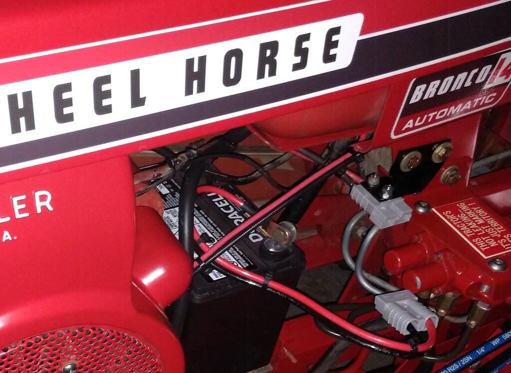

kpinnc 17,499 #23 Posted February 13, 2022 (edited) I've got two of the "Duracell" batteries from Costco this year. I can't yet speak for longevity yet, but they have been great so far. 300CCA- only about $34 with a core. Edited February 13, 2022 by kpinnc 1 Share this post Link to post Share on other sites
