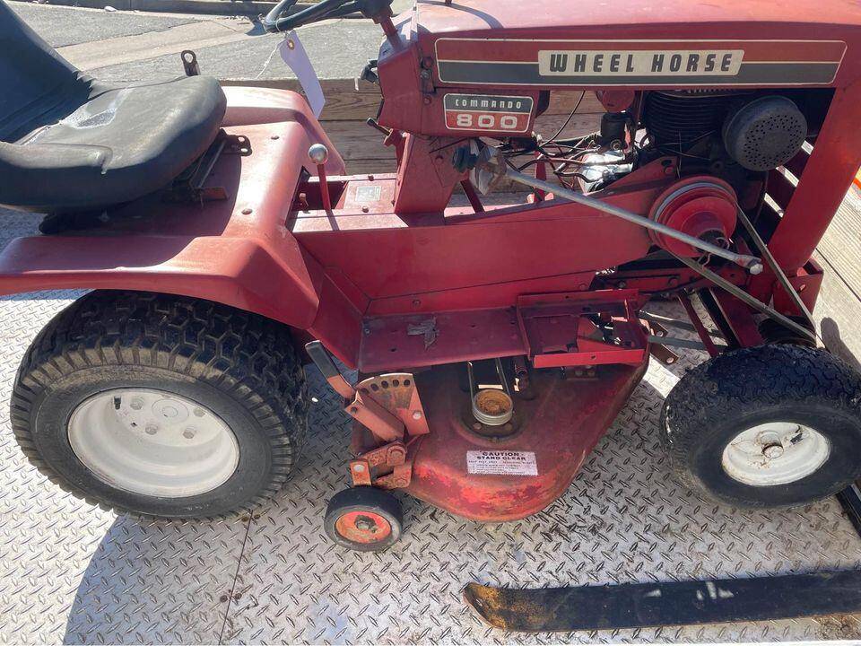

Fishroe 261 #1 Posted February 11, 2022 What are the differences between these 2 this 800 came up for sale. What is it worth running or non- running. Would the plow blade on my 414-8 fit on this commando 1 Share this post Link to post Share on other sites
Pullstart 68,860 #2 Posted February 11, 2022 6 hp and less gear selection. The 414 plow should fit just fine 2 2 Share this post Link to post Share on other sites
Pullstart 68,860 #3 Posted February 11, 2022 The Commando is also a much shorter machine. It’s still quite capable for just 8 hp. 3 Share this post Link to post Share on other sites
Fishroe 261 #4 Posted February 11, 2022 Thanks for the quick response does it have the 1 1/8 inch axle is it as strong as the 414 i’m just looking for a back up tractor is it 3 forward speeds and one reverse 2 Share this post Link to post Share on other sites
kpinnc 17,147 #5 Posted February 11, 2022 It has 1 inch axles and a 3 speed transmission. Same as the 414 without the low range and a slightly lighter duty differential. Still much more rugged than anything available these days. The tractor also has smaller wheels and tires all the way around. Think of it as a scaled down version of the 414. But still a tough little machine. Most attachments will interchange between the two, but there is a difference in clearance underneath (about an inch) and hp. 1 Share this post Link to post Share on other sites
Fishroe 261 #6 Posted February 11, 2022 It looks to be in decent shape for a 50 year old tractor seller is asking $400 Says it’s been sitting for years. Did that model have an hour meter 2 Share this post Link to post Share on other sites
kpinnc 17,147 #7 Posted February 11, 2022 (edited) No hour meter. Looks to be missing a battery too. I'd want to see it run for that much. Edited February 11, 2022 by kpinnc 3 Share this post Link to post Share on other sites

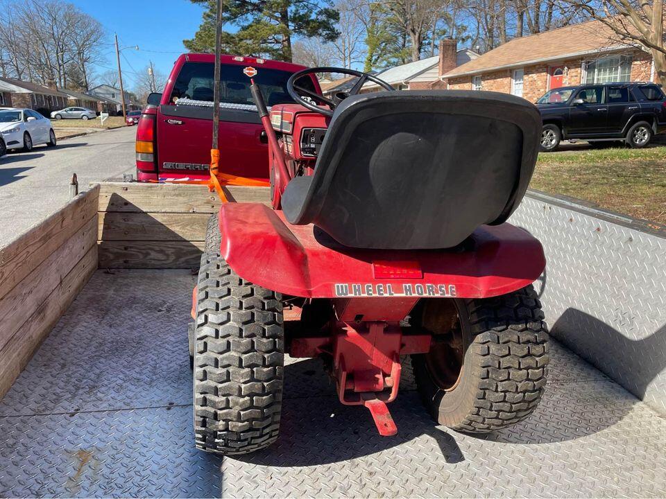

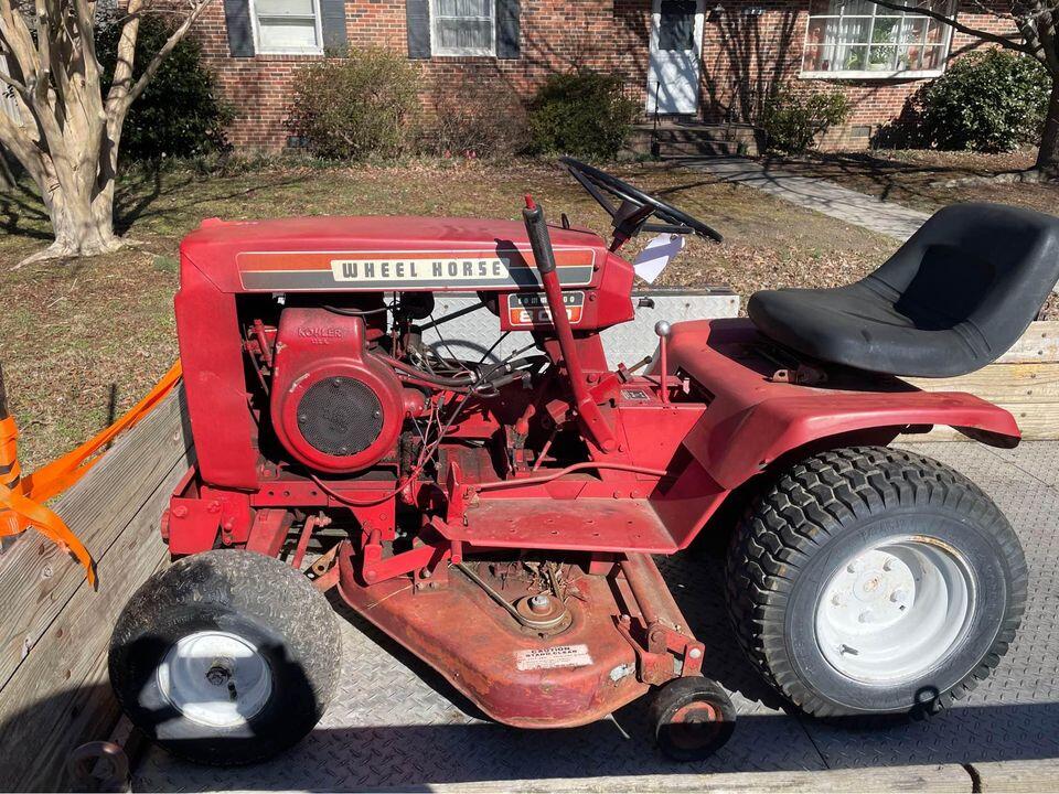

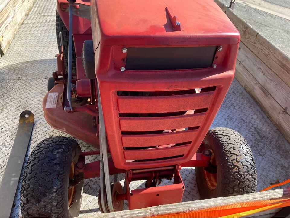

Fishroe 261 #14 Posted February 11, 2022 Here are the rest of the pics. 2 2 Share this post Link to post Share on other sites

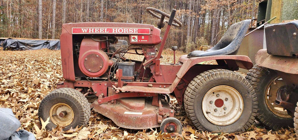

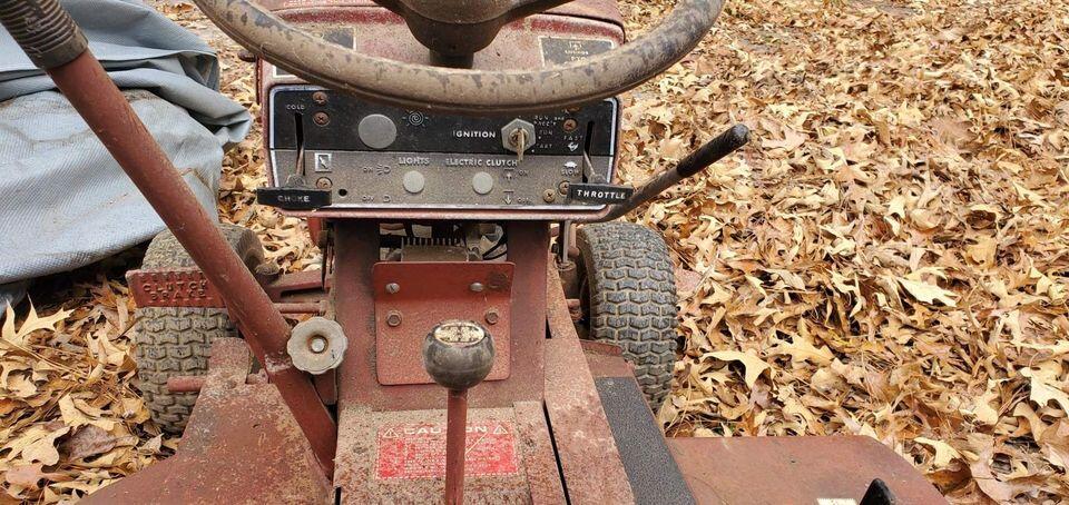

Fishroe 261 #20 Posted February 11, 2022 (edited) This is in the equation too. Just like the commando. Been sitting a while does this one have the 1 1/8 axle Any red flags on this model? Looks similar to the commando does the commando have an electric clutch worked the dog crap out of the 414-8 today its a wonder something didn’t break Edited February 11, 2022 by Fishroe 2 Share this post Link to post Share on other sites
pfrederi 19,872 #21 Posted February 12, 2022 no electric clutch originally on Commando... easy add on at some point 1 Share this post Link to post Share on other sites
Fishroe 261 #22 Posted February 12, 2022 I think I would rather have a pto rather than electric 2 Share this post Link to post Share on other sites
pfrederi 19,872 #23 Posted February 12, 2022 26 minutes ago, Fishroe said: I think I would rather have a pto rather than electric Manual would be my choice also... 2 Share this post Link to post Share on other sites
kpinnc 17,147 #24 Posted February 12, 2022 (edited) The 800 and the 8 horse 4 speed are basically identical, with the latter just being a little newer. Everything produced around the time of the company sale to AMC are now commonly referred to as "no name" tractors. Shortly afterward came the A, B, C, and D series machines. And neither had 1.125 axles. Both had 1 inch axles and 4 pinion diffs. They also had very long axles, with about 2.5 inches extended out of the tranny case on both sides to compensate for the wheel offset which is less than a traditional Wheel Horse. Internally, the trannies are the same as any other 4 speed. Edited February 12, 2022 by kpinnc 1 Share this post Link to post Share on other sites
