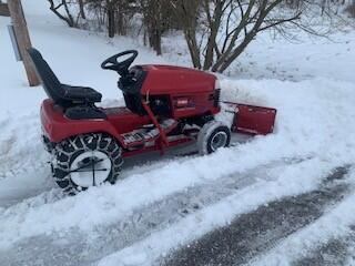

Jhawkins 43 #1 Posted February 8, 2022 WHILE USING MY 520 XI IVE NOTICED THE HYDRO LIFT IS VERY LOUD. EVERYTHING WORKS GREAT, ITS JUST LOUD. IT HAD A NEW FILTER PUT ON IT THIS LAST SUMMER I WAS TOLD. ANY IDEAS ON WHAT I COULD DO? 1 Share this post Link to post Share on other sites
