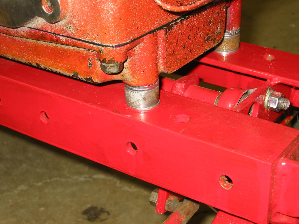

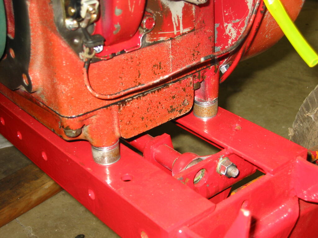

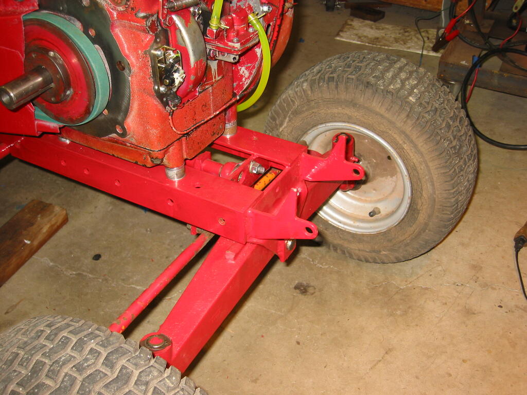

pfrederi 19,881 #2 Posted February 7, 2022 Or do away with shaker plate and use 3/4 inch spacer and a couple washers like this. It will be in exact same location as shaker mount PTO. You may have to drill 2 holes in the frame. i did not but it is an older frame. Yo also have to source or make a lower PTO bracket that bolts to the frame. 6 3 Share this post Link to post Share on other sites

pfrederi 19,881 #8 Posted February 7, 2022 The spacers i used in the picture above came from a shaker mount 8 hp K181. #13 WH# 106340 1 Share this post Link to post Share on other sites
