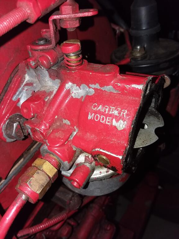

wh1075 6 #1 Posted February 6, 2022 I have a model 1055 with a K-241 engine. It has issues with flooding when trying to start. The carb is getting fuel. The float dose not seem to be stuck open as it doesn't overflow and leak gas when sitting. I have gone over the ignition side (new points, condenser, plug) and have strong spark. I have double checked the timing and believe that it is correct. Fresh gas and fuel filter make no difference. I had the carb soaked and gone over (not rebuilt) at a local shop and installed with new gaskets and air filter with no difference. I have adjusted it as well as I am able to from my experience but would like specific instructions. My next step is identifying the carburetor. It says Carter model N. The Kohler manuals that I have reference either a Kohler built adjustable jet or a Walboro fixed jet version, neither of which seems to match this one. I know that Carter made carburetors for many years just never saw one on a Kohler engine before. I would like to try to rebuild this one before spending the money to get a name brand oem replacement. Any help would be appreciated. 1 Share this post Link to post Share on other sites

wh1075 6 #17 Posted February 9, 2022 I made sure the battery was fully charged and did the compression test. The results were 87 psi. I don't know if that is good or bad for this engine. Also I am trying to add a picture of the carb. Thanks for all the help so far. Also the carb settings when it came back from the shop, I am not sure where they were at this point. It didn't start so I tried to follow the manual to adjust it. Don't believe that it was far off but can't confirm Next time I will be recording where it starts from. Share this post Link to post Share on other sites
squonk 45,531 #18 Posted February 9, 2022 Awful lot of paint on that carb for it to have been " soaked " Also that bowl gasket doesn't look new to me either. Share this post Link to post Share on other sites
pacer 3,179 #19 Posted February 9, 2022 I too have some doubts as to that carb having been around any 'soaking' I havent seen any thing mentioning spark.... A wet plug could also mean its not firing - and so wouldnt run. Have you checked the ignition on it - see if the spark plug IS sparking? Share this post Link to post Share on other sites
