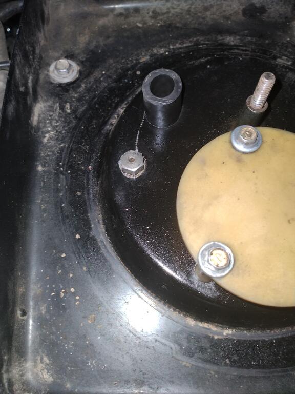

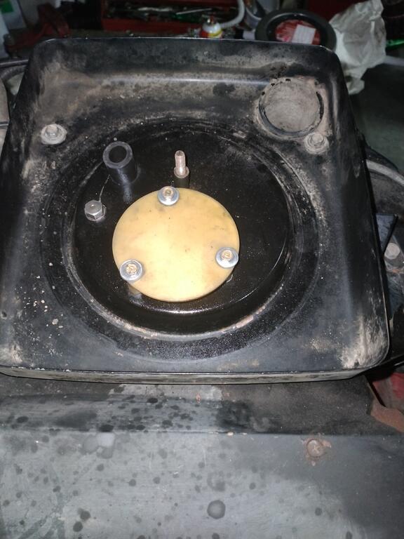

TJ5208 1,841 #82 Posted February 7, 2022 What does this bolt go to? 1 Share this post Link to post Share on other sites
Ed Kennell 46,990 #83 Posted February 7, 2022 If you are refering to the one with the hole, it should go to the dirty air filter pressure sensor on the idiot light cluster. The fitting is usually broken off at the sensor and the tubing is hanging loose. 2 Share this post Link to post Share on other sites

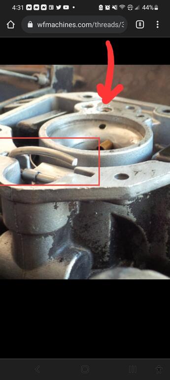

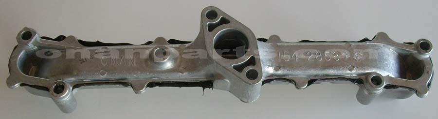

kpinnc 18,886 #84 Posted February 7, 2022 (edited) A cheap and easy option to try would be to seal that intake manifold seam. Two of my Onans surged and had to run full choke until I did that. The manifold is two pieces that are riveted together and is bolted to the carb from underneath. You can seal it without removing it, so no gaskets needed. The seam opens over time (heat cycles and aluminum) and air is allowed in. Just add a small bead of silicone gasket seal to the seam all the way around. It doesn't take much, and I just dabbed a bit on with my fingertip. Doing this greatly improved how my engines ran. Not to mention, if air comes in through a gap, it's bypassing the filter. If it doesn't improve anything, you're out $5. The one below looks.to have been sealed... Sloppily Edited February 7, 2022 by kpinnc 2 Share this post Link to post Share on other sites

Horse Newbie 7,405 #88 Posted February 7, 2022 34 minutes ago, kpinnc said: The one below looks.to have been sealed... Sloppily Edited 26 minutes ago by kpinnc Hey man, how did you get my picture ? 3 Share this post Link to post Share on other sites
RED-Z06 2,720 #89 Posted February 7, 2022 1 minute ago, Horse Newbie said: Hey man, how did you get my picture ? I wonder if a 1pc 3d printed intake would hold up? Could play with the flow/ports where it splits under the carb. 1 Share this post Link to post Share on other sites
Horse Newbie 7,405 #90 Posted February 7, 2022 Just now, RED-Z06 said: I wonder if a 1pc 3d printed intake would hold up? Could play with the flow/ports where it splits under the carb. I don’t know how it would hold up… I do know that it is fairly common for those intakes to have air leaks. Mine did, but it was where the heat shield had rubbed it. The above pic is not mine though… I did a little better job than that … 1 Share this post Link to post Share on other sites
RED-Z06 2,720 #91 Posted February 7, 2022 7 minutes ago, Horse Newbie said: I don’t know how it would hold up… I do know that it is fairly common for those intakes to have air leaks. Mine did, but it was where the heat shield had rubbed it. The above pic is not mine though… I did a little better job than that … I wonder if its related to climate? All ive had ive never seen one leak at the seam..had them up over 2000 hours too. 2 Share this post Link to post Share on other sites
