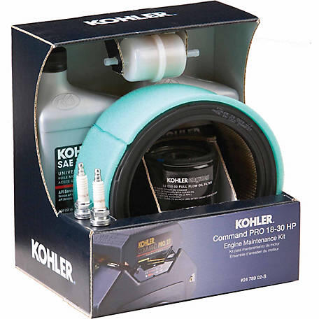

Snoopy11 5,731 #34 Posted February 6, 2022 Little large... in my opinion. Can't really see the fuel running through it either... Don 1 Share this post Link to post Share on other sites
RED-Z06 2,720 #35 Posted February 6, 2022 Just now, Snoopy11 said: Little large... in my opinion. Can't really see the fuel running through it either... Don Looks like a normal kohler filter 2 Share this post Link to post Share on other sites

Snoopy11 5,731 #40 Posted February 6, 2022 (edited) 7 minutes ago, RED-Z06 said: Looks like a normal kohler filter Are those different than other filters... ...I affirm so in my experience... although... maybe out of context in this case... See above filter... Don Edited February 6, 2022 by Snoopy11 1 Share this post Link to post Share on other sites

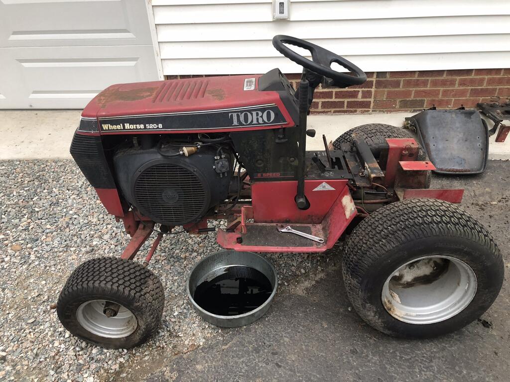

Snoopy11 5,731 #46 Posted February 6, 2022 Looking at the fuel filter actually on the tractor, it is smaller than it initially looked to me. A couple of years ago, I had a similar issue with a napa filter (designed for tractor) that I put on one of my machines. I tried using it since I needed the machine back online immediately. However, it was WAY too big. AND... thus why I am a bit wary of fuel filters. I put a smaller filter on my machine, and it ran like nothing ever happened. Looking at the filter on TJ's machine somewhat leads me to believe it may be something deeper, like @RED-Z06 has mentioned here. Maybe some gunk flaked off and got into the carb... I would definitely examine all fuel lines!!! Don 1 Share this post Link to post Share on other sites
Snoopy11 5,731 #47 Posted February 6, 2022 THIS looks MASSIVE to me... Don 1 Share this post Link to post Share on other sites
Snoopy11 5,731 #48 Posted February 6, 2022 Here is one like I put on my machine... and thus why TJ's filter brought back a memory... Did not work... period... Don 1 Share this post Link to post Share on other sites
