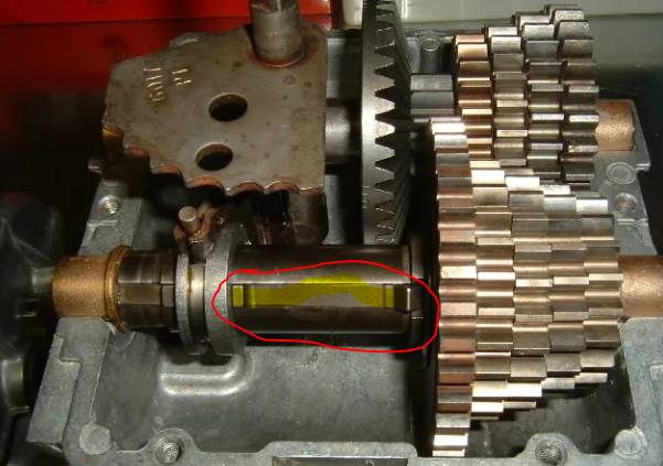

MrJ 2 #1 Posted February 6, 2022 Hi , new member here from Germany . Need advise with a gearbox problem on my recently acquired 210-4 (my first Horse ) . It goes into reverse fine but not forward gears and if it does then its "jerky" . I believe its a 900 029 Peerless box which after trawling ebay etc seems to be as rare as hens teeth ! Any thoughts ? 1 Share this post Link to post Share on other sites
Maxwell-8 4,368 #2 Posted February 6, 2022 Gutentag ! multiple peerless transmissions will fit in your tractor. Sounds like you have a bad shifter selector Have had a this same issue Share this post Link to post Share on other sites

Maxwell-8 4,368 #5 Posted February 6, 2022 4 hours ago, MrJ said: Hi , thanx for that , so how did you solve the problem ? I was thinking I could replace it with one from a 212-5 which seem to be more available but whether the bolts would all line up.... ? Not 100% sure, but most of them have the same bolt locations. I opened the tranny, cleaned it well and bended the shifter piece down until it would enter into the gears. 2 Share this post Link to post Share on other sites
