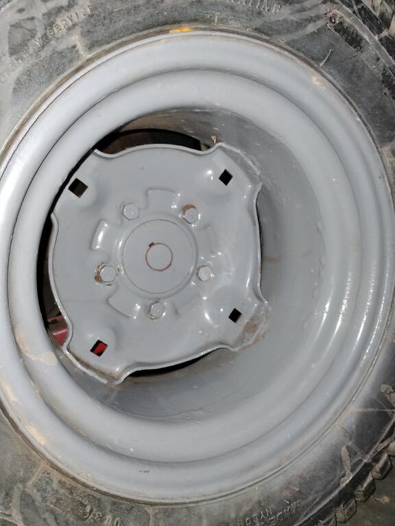

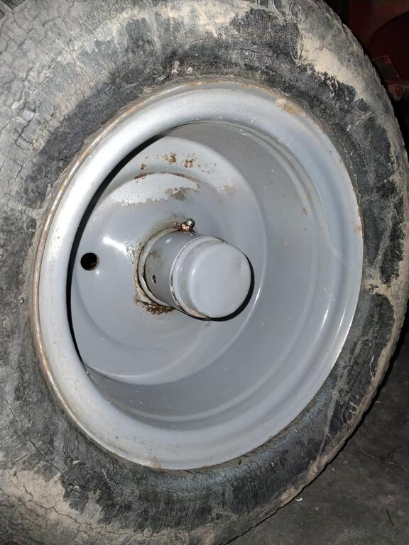

TJ5208 1,841 #1 Posted February 3, 2022 How would I go to getting this overcoat off and getting back to the original without destroying its original paint. on the fronts on the insides. All the rest of it is gray except the insides of the front rims 1 Share this post Link to post Share on other sites
Achto 29,794 #2 Posted February 3, 2022 Easy Off oven cleaner should get that grey paint off. Try a little spot first. Spray it on, let it sit for 10min and then wash it off with soap & water. Just a heads up, I would guess that some one painted them trying to improve their appearance. You may not like what you find under that paint. I guess that if you don't like what you find you could always repaint the rims once it warms up out side. 4 1 Share this post Link to post Share on other sites
SylvanLakeWH 29,304 #3 Posted February 3, 2022 and wear rubber gloves while doing it… that stuff is nasty… 3 2 Share this post Link to post Share on other sites
EB-80/8inPA 1,917 #4 Posted February 4, 2022 31 minutes ago, Achto said: You may not like what you find under that paint. Agreed. It’s impossible to imagine anybody would have repainted those wheels because they loved that color gray. Original paint was probably roached. 3 Share this post Link to post Share on other sites

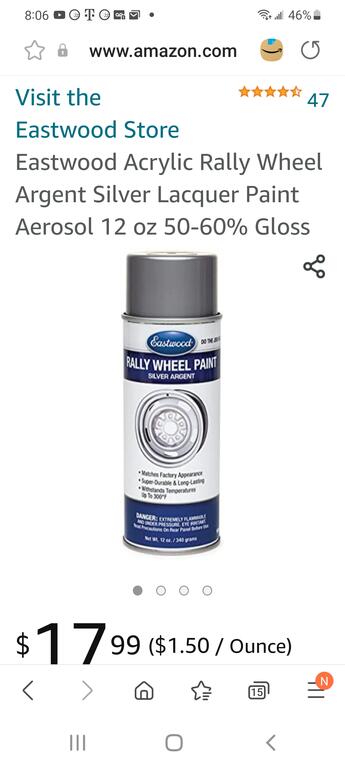

jeepdan 337 #6 Posted February 4, 2022 41 minutes ago, AMC RULES said: How many cans would it take to do all four wheels inside and out? 2 Share this post Link to post Share on other sites
AMC RULES 37,232 #7 Posted February 4, 2022 I would think two should do it, couple coats each rim. 4 Share this post Link to post Share on other sites
EB-80/8inPA 1,917 #8 Posted February 4, 2022 10 hours ago, AMC RULES said: I would think two should do it, couple coats each rim. Is that product a match to the Wheel Horse gray for wheels? At that price, I’m guessing it’s high quality stuff in any case. 4 Share this post Link to post Share on other sites
AMC RULES 37,232 #9 Posted February 4, 2022 Yes, it is a perfect match, and yes, you get what you pay for. 1 1 Share this post Link to post Share on other sites
