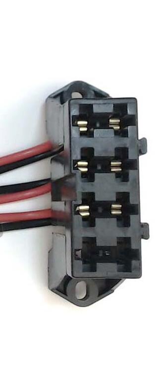

You might have to share that. I have used just regular blade style fuse holders as pictured below. Changing out the original to original would be a real chore. Lots of wires stretched piano wire tight  under it. Below the fuse block is a cluster of plug in relays check that area as well.
The upgrade fuse panel i found was actually sold thru another wheel horse forum online shop
Its a similar style, but does seperate all 3 fuses and has 12g wire included (and fuses i think)
its 22 dollars, but according to the description it says "correct this issue for the last time" or something along those line.
heavier wire, 3 seperate fuses all for 22 dollars and hopefully put a  end to fuse block issues
i did watch a youtube video last night on a guy working on his 520h. It was a no start situation, however towards the end of the video he found out that if he took a fuse, and bent the "fines" on the fuse slightly, it fit more snug in the fuse block and his tractor fired up
What if that is what i have. Fuse is just loose in there. Once i hit a bump, the fuse looses contact and tractor dies?
I want to clean each wire connection just to be safe, but still. What if the fuse looses contact in the holder and thats is my issues all along !

Once you pull the fuse holder and look at the bottom, the questions may be answered.  Heat from a corroded connection can weaken or burn the metal and melt the plastic.  If you clean, repair or replace the fuse block, coat all connections with a bit of No-Ox to prevent corrosion.  Adding a cover will keep moisture holding debris out.

Ahh you mean this one then... same fuse holder just has the pigtails pre-attached for a bit easier install.
Bending the fuse blade is just dealing with the symptom not the cause. In fire fighter speak you are getting rid of the smoke but not putting out the fire.

Last was the fuse block. Removed screws and fuses. I looked at the fuse block and it looked great. Little dirty, but no burning, no melting, no hot spots on the wires. (a big relief for me)
blasted it multiple times with contact cleaner and compressed air. I got some junk out, but not much.
Here is where it gets interesting. I looked closely at the top of the fuse block itself. Where the fuses slide in
2 out of the 3, the gap seemed wider than the other. One fuse, fit in rather snug. The other 2 fuses are tight but no where near as tight as the 15 amp fuse.
Thinking maybe that was my issue???
Anyway, cleaned and reinstalled fuses, this time with dielectric grease on each blade of the fuses.
Took it out and "knock on wood" it worked
Only time will tell at this point, however Im thinking that fuse block should be replaced sooner than later. If those fuses are a little loose, that could lead to heat and melting.
So that is my next step. I have a friend who has the tool to remove the wires from the fuse block.  I think ill do that and use a standard fuse block again (thinking about all the splices in the upgrade) not really wanting to mess with that

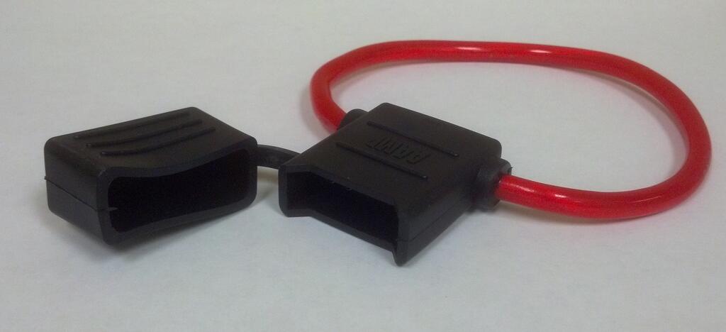

Last question for you all. I read somewhere you can take a wire out of the 9 pin connector and it removes alot of load from it. Someone wired in a inline fuse to save the 9 pin connector
I can do that, but can someone tell me what wire it is? and what size wire and fuse to use?
I dont have any issues now, just trying to save my 520h from melting anything. Id rather blow a in line fuse than melt a harness

You can leave things as they are and add a wire from the B+ terminal on the voltage regulator down to the battery connection on the solenoid.   Put an inline fuse where it is convenient.
