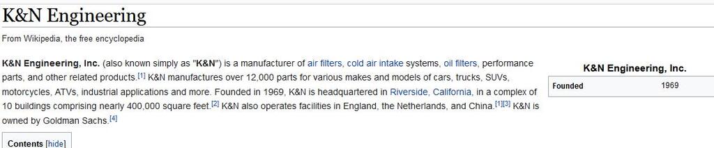

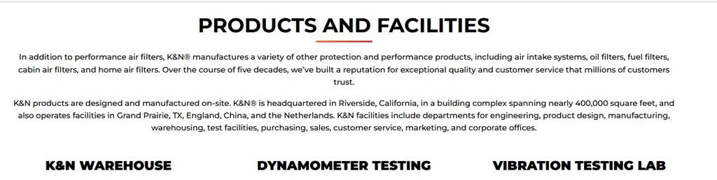

Snoopy11 5,731 #59 Posted February 7, 2022 (edited) 26 minutes ago, RED-Z06 said: K&N filters were all made under the Fram/Champion Labs I'd need a source for that. Not to mention... it has no relevance to quality for filtration purposes, comparatively among filters... Anyone who has cut different branded oil filters open... knows that there are differences in filtration material quality... additionally... I think there are copious amounts of pictures/video/etc... documenting the differences in filtration material in these filters. Fram usually being the worst for filtration purposes... Mobil-1 and K&N being the top tier... with Mobil-1 having better filtration, and K&N having solid filtration and a better flow rate. Don Edited February 7, 2022 by Snoopy11 1 Share this post Link to post Share on other sites
pfrederi 21,145 #60 Posted February 7, 2022 Owned by Goldman Sachs 1 Share this post Link to post Share on other sites

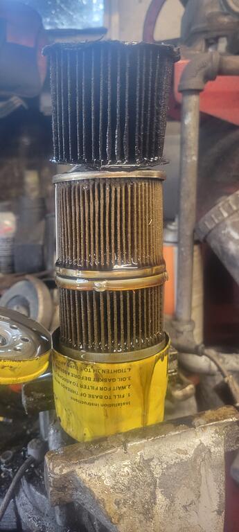

RED-Z06 2,720 #61 Posted February 7, 2022 Bottom to top... Hipa (chinese) Motorcraft FL910S Fram PH3614 The fram does have the fiberous caps but the were both intact, it also had the heaviest case to cut, the bypass valve also had the tightest seal (had to use pliers). The FL910s came apart easiest but has a really nice filter cartridge 1 Share this post Link to post Share on other sites
Snoopy11 5,731 #62 Posted February 7, 2022 What... exactly are you saying... @RED-Z06 Don 1 Share this post Link to post Share on other sites

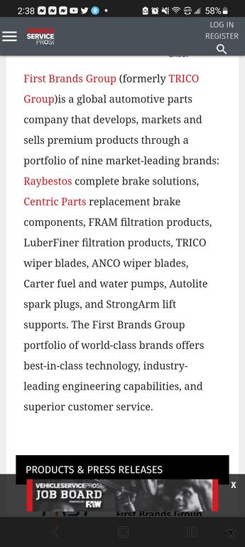

RED-Z06 2,720 #63 Posted February 7, 2022 I did see that Fram was purchased by Champ Labs who was purchased by Trico who became First Brands, who also owns LuberFiner among others including the Private label filters. Share this post Link to post Share on other sites
RED-Z06 2,720 #64 Posted February 7, 2022 8 minutes ago, Snoopy11 said: What... exactly are you saying... @RED-Z06 Don Just showing a few different filters, that fram was on ~250hrs on a Briggs 27hp Twin, I put the engine on new 5 years ago and took off the little stubby filter for the larger fram...he never changed it, he just added oil as needed...oil came out pitch black. Share this post Link to post Share on other sites
Snoopy11 5,731 #65 Posted February 7, 2022 This... says it all... I guess if hard times come... and I want to go cheap... I'm going to go to Walmarts and buy a supertech filter... would be better quality that Fram cardboard glued paper mush... You learn something new every day... Don Share this post Link to post Share on other sites

RED-Z06 2,720 #68 Posted February 7, 2022 11 minutes ago, Snoopy11 said: This... says it all... I guess if hard times come... and I want to go cheap... I'm going to go to Walmarts and buy a supertech filter... would be better quality that Fram cardboard glued paper mush... You learn something new every day... Don Again...in the application at hand, they are fine, and clearly hold up to abuse well beyond what could be expected...this is personal experience, over many years, not youtube mechanics. I wouldnt use one on my car...but in low pressure applications with a 50hr recommended service interval, the PH3614 and FL910s do very well...and the heavy fram case is nice to have when the filter feels glued on. Share this post Link to post Share on other sites

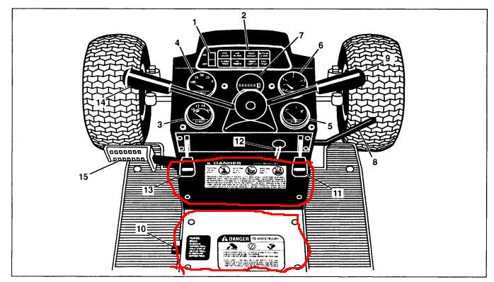

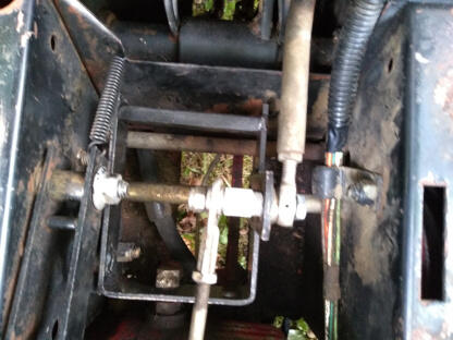

Chestnut 315 #73 Posted February 8, 2022 19 hours ago, stegs said: Then it hit me. I bet its the neutral safety switch!!!. I turned the key to the start postition and wiggled the drive lever and IT CRANKED!! not knowing where the neutral safety was located at the time, i cranked it while wiggling the drive lever. Cranked over but would not fire. Took a look a the fuel filter (which i replaced with a new one) and had no fuel going to the filter Now I just need to figure out how to adjust the creep out of the hydro trans. Ill mess with that this week sometime Congratulations on the new tractor. Horse Newbie was correct about the procedure for adjusting the creep out of the Hydro. However, since you also have an issue with the neutral safety, there's a possibility that the PO or their shop "adjusted" you into both problems. Before I adjusted anything and with the tractor off I'd remove the vertical access panel below the dash and the horizontal one between the dash and seat pan. Four large Phillips screws each. The neutral safety switch is behind the vertical panel. You should be able to see the switch being opened and closed as you move the motion control lever through its range. When you depress the brake motion control rod should move to the position where the safety switch is activated. If it's not, there's a possibility the PO or their shop "adjusted" one of the links on the motion control cam. The motion control cam links to the brake system and should bring everything to neutral when you press the pedal. As you can see from the photo there are threaded links from each side of the motion control cam that could have been moved. I'm sure there will be someone on this forum will have the procedure for re-centering the whole linkage if need be.. If you do make any changes either to the linkage or to the cam on the hydro drive, make sure the rear tires are jacked off the ground and supported when you attempt to start the engine. 1 Share this post Link to post Share on other sites
stegs 327 #74 Posted February 8, 2022 3 minutes ago, Chestnut said: Congratulations on the new tractor. Horse Newbie was correct about the procedure for adjusting the creep out of the Hydro. However, since you also have an issue with the neutral safety, there's a possibility that the PO or their shop "adjusted" you into both problems. Before I adjusted anything and with the tractor off I'd remove the vertical access panel below the dash and the horizontal one between the dash and seat pan. Four large Phillips screws each. The neutral safety switch is behind the vertical panel. You should be able to see the switch being opened and closed as you move the motion control lever through its range. When you depress the brake motion control rod should move to the position where the safety switch is activated. If it's not, there's a possibility the PO or their shop "adjusted" one of the links on the motion control cam. The motion control cam links to the brake system and should bring everything to neutral when you press the pedal. As you can see from the photo there are threaded links from each side of the motion control cam that could have been moved. I'm sure there will be someone on this forum will have the procedure for re-centering the whole linkage if need be.. If you do make any changes either to the linkage or to the cam on the hydro drive, make sure the rear tires are jacked off the ground and supported when you attempt to start the engine. I did take the panel off. The Lever rod does make contact with the NSS. The NSS has a small bend in the metal, and that is where the rod stops. Im not having that issue anymore and the tractor starts up and the touch of th key What i have now is the motion lever is halfway up before the tractor begins to move. I feel as if the tractor should move as soon as i push the motion lever forward....but it doesnt 1 Share this post Link to post Share on other sites
Chestnut 315 #75 Posted February 8, 2022 3 minutes ago, stegs said: I did take the panel off. The Lever rod does make contact with the NSS. The NSS has a small bend in the metal, and that is where the rod stops. Im not having that issue anymore and the tractor starts up and the touch of th key What i have now is the motion lever is halfway up before the tractor begins to move. I feel as if the tractor should move as soon as i push the motion lever forward....but it doesnt Sounds like you found the source of the electrical issue. A search through old posts will show a few discussions about the problems with this connector. A picture of the cam on top of the hydro unit would help. Some of them can be worn or "modified". One of mine requires the motion lever to be moved a lot to go forward as well. I don't know the answer. 1 Share this post Link to post Share on other sites
