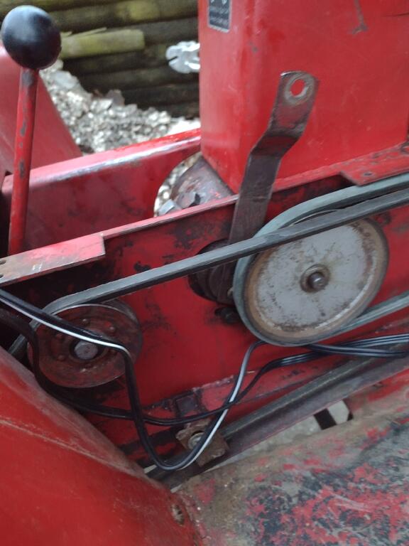

The lever for the hydraulics doesn't return to neutral on its own will it still work and how do you repair this lever
oldlineman
Not familiar with this item but may just need moving parts lubricated, Peter help!
The spring that will return the handle to center is inside the pump reservoir on the 953/1054. Remove the pump to see which spring you need and then contact Lowell at Wheel Horse Parts and More for the spring and all the seals that go with it.  https://wheelhorsepartsandmore.com/
You can find more information by searching HY-2 on this site.
