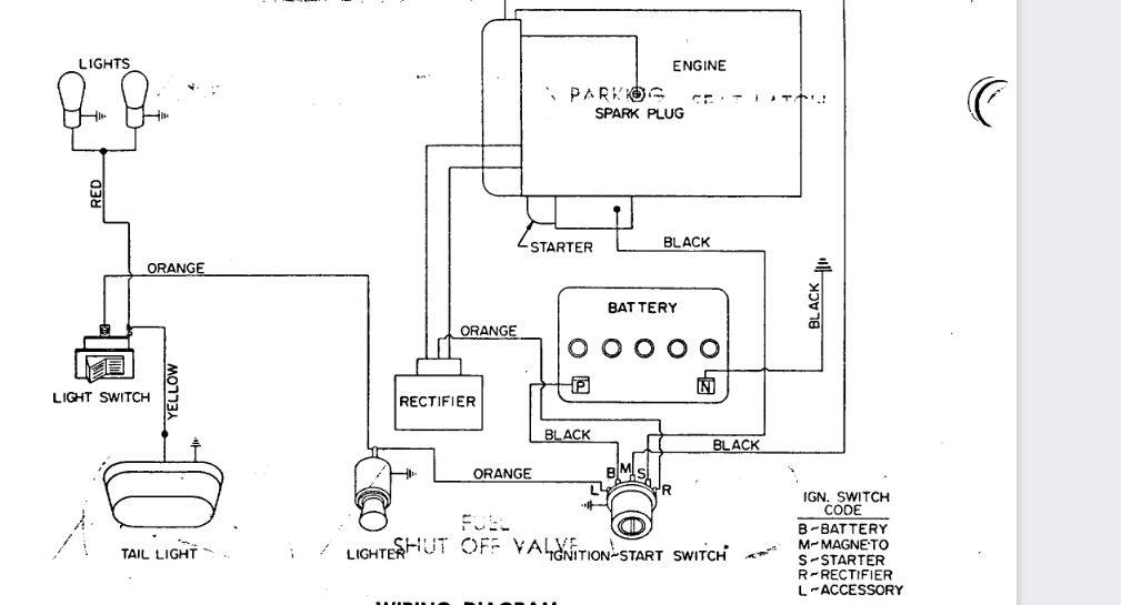

tallen4392 71 #1 Posted February 3, 2022 while using my charger during the last storm the lights quit it seems the orange wire from the ignition switch has a fuse in it that is good that orange wire lost power seems simple it is a short fused orange wire goes right to headlight switch can it be anything beside the switch before i buy a new one thanks Share this post Link to post Share on other sites
oldlineman 1,595 #2 Posted February 3, 2022 Test by jumpering over the switch. Bob Share this post Link to post Share on other sites
tallen4392 71 #3 Posted February 3, 2022 if i run a jumper to the headlight switch all lights work Share this post Link to post Share on other sites
oldlineman 1,595 #4 Posted February 3, 2022 Which side of the switch, the feed side or load side? Share this post Link to post Share on other sites
tallen4392 71 #5 Posted February 3, 2022 the orange wire from the ignition to light switch is dead if i run a hot wire from the battery to the light switch the light work fine Share this post Link to post Share on other sites
pfrederi 19,278 #6 Posted February 3, 2022 Chargers had no fuses (real men do not use fuses) so what you have is an add on. Orange wire from ignition switch went to the cigar lighter then the light switch... 1 Share this post Link to post Share on other sites
tallen4392 71 #7 Posted February 3, 2022 this has no lighter no hole for it either wiring looks factory and original just trying to figure out if the reason the orange wire from the ignition switch to the light switch that is no longer hot could be a bad ignition switch Share this post Link to post Share on other sites
