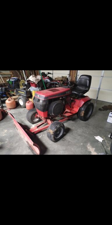

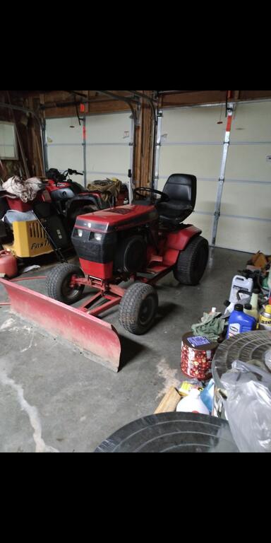

TJ5208 1,841 #68 Posted January 26, 2022 Got the 520-8 waxed up. 3 1 Share this post Link to post Share on other sites

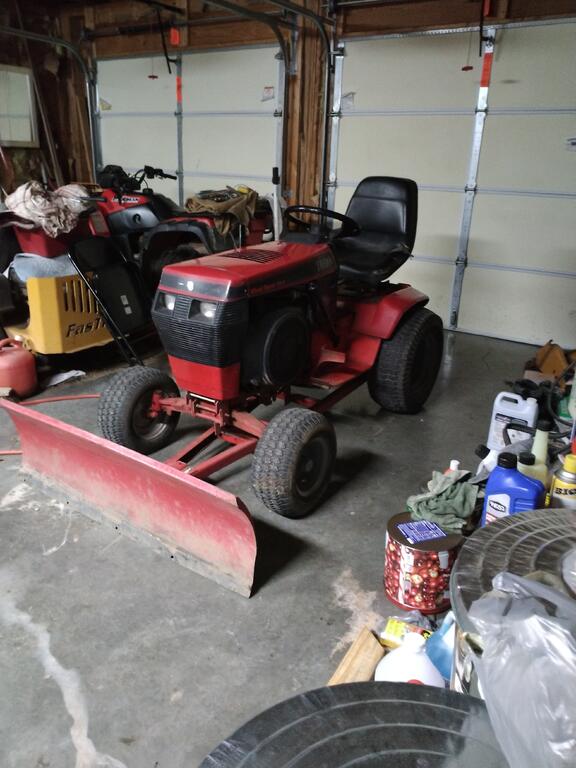

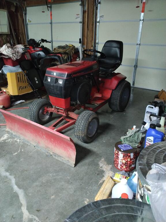

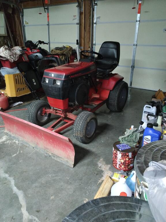

TJ5208 1,841 #69 Posted January 26, 2022 Before and after 2 1 Share this post Link to post Share on other sites
