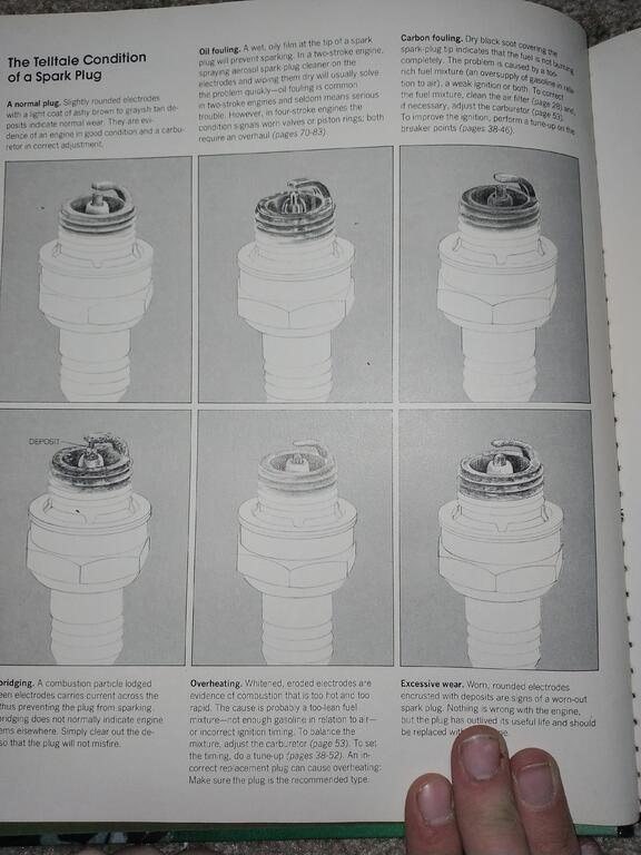

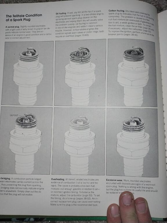

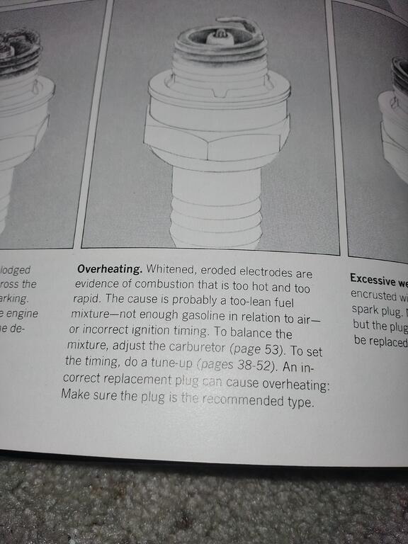

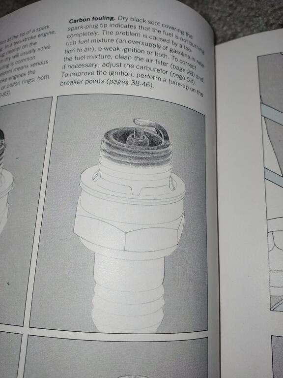

Wheelhorse#1 1,879 #9 Posted February 2, 2022 Here’s a chart not sure if it’s very accurate though.kinda hard to read between the different symptoms and pics given. 1 Share this post Link to post Share on other sites
