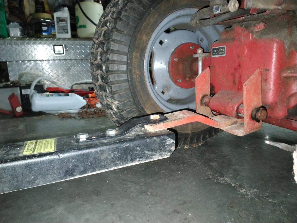

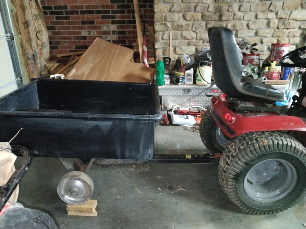

TJ5208 1,841 #1 Posted January 28, 2022 (edited) You guys have any recommendations without having to do a lot of modifications to get this trailer to level out. The boards underneath it match how tall the tires are. Just got to buy some tubes but they're getting expensive. I thought about where the tongue is raise that up and stick washers in between the tongue and the hitch. Could the lean actually help. Edited January 28, 2022 by TJ Salyers Share this post Link to post Share on other sites
gwest_ca-(File Mod) 11,878 #2 Posted January 28, 2022 I don't like loose pin connections because they just add more rattles. Have 1-7/8" trailer balls on everything. If you could add a trailer coupler to the tongue that would put the top of the tongue even with the top of a ball. 5 2 1 Share this post Link to post Share on other sites
Maxwell-8 4,370 #3 Posted January 28, 2022 11 hours ago, gwest_ca said: I don't like loose pin connections because they just add more rattles. Have 1-7/8" trailer balls on everything. If you could add a trailer coupler to the tongue that would put the top of the tongue even with the top of a ball. And a ball gives more articulation! Share this post Link to post Share on other sites
