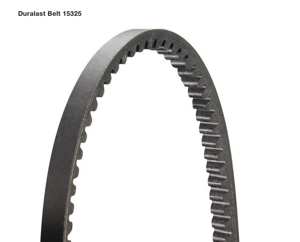

Cog belt?
wallfish
5 hours ago, 8ntruck said:
Cog belt?
wallfish

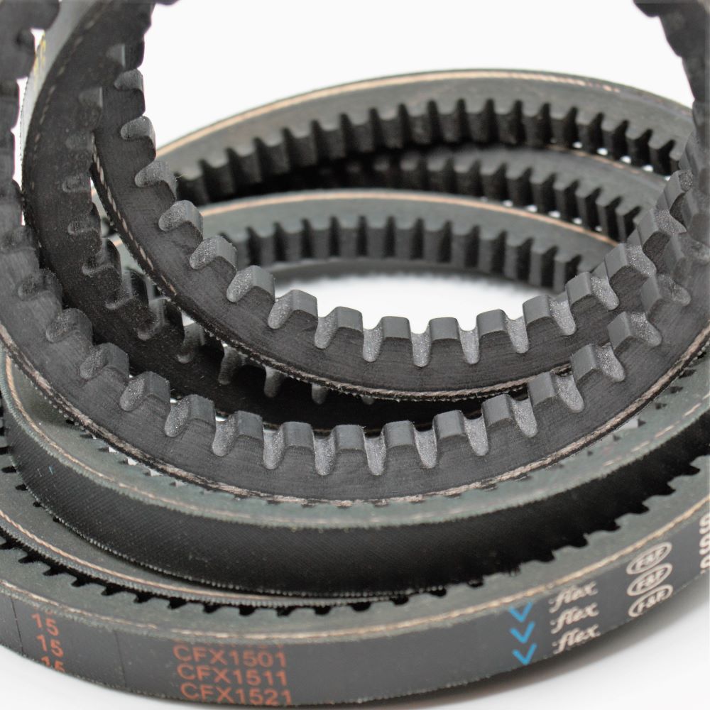

Here's another option

7 hours ago, 8ntruck said:
Cog belt?
1 hour ago, wallfish said:
This is what I have that’s slipping.  Possibly a different brand wouldn’t slip as much?  Maybe I should try a GT wrapped belt?

A rubber sided belt will grip better than a cloth wrapped belt.

8ntruck
I like the double V belt idea.
When I said cog belt, I was meaning something like a timing belt or a blower drive belt that runs on flat, toothed pulley.
Couple reasons I haven’ gone that route.
1, and some might giggle at this, money.  Those systems are quite pricey.
2, it seems that what I need and what is available are two different spices.  I just haven’t found what I like, without #1 getting in the way.
It’s out of the shop now and my personal rush is slowing on it.  I am going to reverse engineer @Achto’s Huyabusa chain idea and see what fpm speeds they are running.

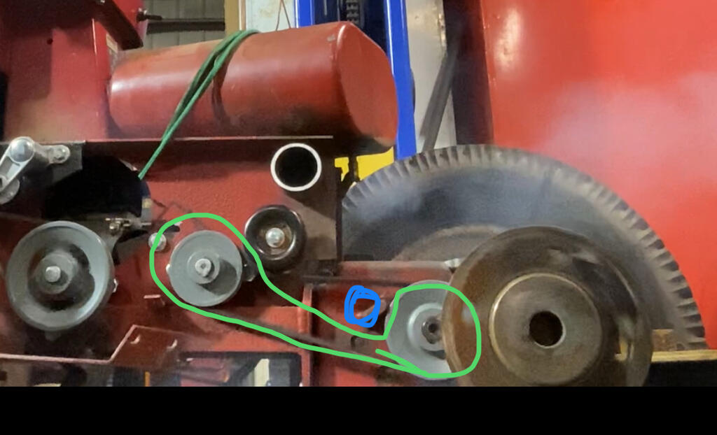

1 hour ago, Oldskool said:
I was checking out your slooooowwwwww mooooootion video.
Would it be beneficial to add a static idler pulley to the final reduction to get more belt wrap on the pulleys?
Like this?
Oldskool
8 minutes ago, Pullstart said:
Like this?
Yup that. Quick and easy. Just a thought.
If I can find a belt in my pile, I have more idlers,  I wouldn’t be out anything.  It’s worth a shot before I hit the chain shop up.
