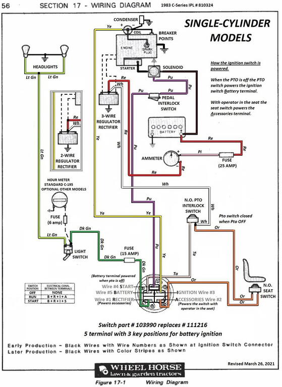

Joe Sullivan 18 #1 Posted January 24, 2022 Hey all, I’ve got a wheel horse c165 that is not charging, I’ve had issues in the past with this tractor not charging. Which was resolved by swapping out the voltage regulator, I tried that again this time, and this time that is not the problem. Where would you guys start? Thanks! Share this post Link to post Share on other sites

Achto 30,872 #4 Posted January 25, 2022 1 hour ago, Joe Sullivan said: Where would you guys start? I always start at the stator. With a multi-meter set to AC power, plug the leads into the 2 stator wire (outside or top 2 terminals on the regulator plug) Start the tractor and rev it up to 3/4 to full speed. You should have between 30 and 40 volts AC. If you do not, check for broken wires. If wiring looks good then I would suspect a bad charging stator. If your AC voltage is good, then you are back to a regulator issue. 3 Share this post Link to post Share on other sites
953 nut 63,985 #5 Posted January 25, 2022 If what Dan @Achto suggested isn't your problem (30 to 40 volts AC from stator) you might want to look at the wiring from the ignition switch to the R/R. The rectifier/regulator has to have 12 volts from the battery applied to the output terminal to work. Could be a connection is corroded or needs to be tightened. 2 1 Share this post Link to post Share on other sites

rmaynard 16,843 #7 Posted January 25, 2022 (edited) I would first take my multimeter set to DC and check the voltage at the battery with the engine running at mid-speed. Charging voltage must be checked with a battery attached. The voltage should be between 13.5 to 14.5 volts. If not, I would suspect 1. Connections, 2. Ammeter, 3. Fuse, 4. Regulator. Edited January 25, 2022 by rmaynard 1 Share this post Link to post Share on other sites
grinchsr 655 #8 Posted January 25, 2022 I am having the same problem so I am following. Can the ammeter be bypassed ? 1 Share this post Link to post Share on other sites
WHX?? 54,573 #9 Posted January 25, 2022 3 minutes ago, grinchsr said: Can the ammeter be bypassed Yes... if the ammeter is open it will not charge. 1 Share this post Link to post Share on other sites
johnnymag3 2,634 #10 Posted January 25, 2022 37 minutes ago, grinchsr said: I am having the same problem so I am following. Can the ammeter be bypassed ? Yes it can be....try a wire from R/R to Battery positive and eliminate ammeter in circuit path Share this post Link to post Share on other sites
grinchsr 655 #11 Posted January 25, 2022 Thanks for the replies. Will try the wiring bypass Share this post Link to post Share on other sites
johnnymag3 2,634 #12 Posted January 25, 2022 3 hours ago, grinchsr said: Thanks for the replies. Will try the wiring bypass If it proves to be successful, then the Ammeter is junk. It is just a link in the 2 wires to monitor Voltage......... Share this post Link to post Share on other sites

Joe Sullivan 18 #14 Posted January 28, 2022 Thank you all for the awesome support! My issue has been resolved, turns out, I simply had a faulty ignition switch, replaced the switch, now I’m charging great! 1 Share this post Link to post Share on other sites
