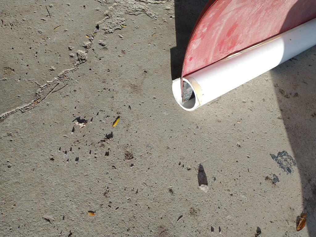

squonk 47,375 #27 Posted January 29, 2022 3" With a slot cut into it. 1 1 Share this post Link to post Share on other sites
Sparky-(Admin) 25,935 #28 Posted January 29, 2022 4 hours ago, squonk said: 3" With a slot cut into it. How long could that possibly last? Seems like it would need replacing often. Share this post Link to post Share on other sites
squonk 47,375 #29 Posted January 29, 2022 2 minutes ago, Sparky said: How long could that possibly last? Seems like it would need replacing often. So it's cheap and keeps the stones out of the yard. When it wears out, pop another on. Worked really well on our first snow. Didn't tear up the grass either. Share this post Link to post Share on other sites
Reddart 213 #30 Posted January 29, 2022 I’m going to have to try that I think. I have a long gravel driveway. 1 Share this post Link to post Share on other sites

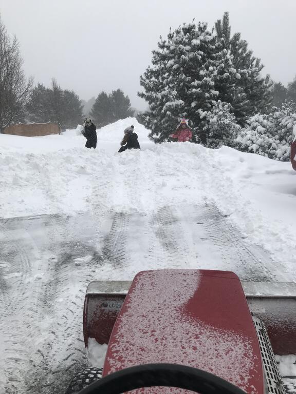

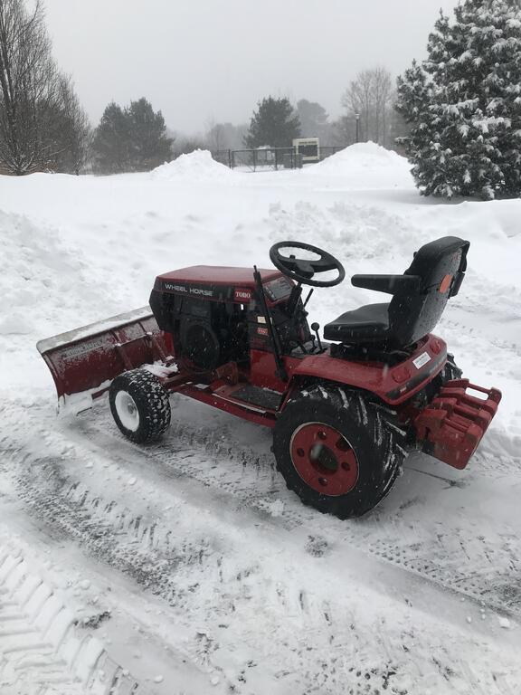

Newstuffsucks81 90 #33 Posted January 30, 2022 Used mine today. Good time. Made the youngsters a long snow pile. Big plans for a fort. 1 2 Share this post Link to post Share on other sites

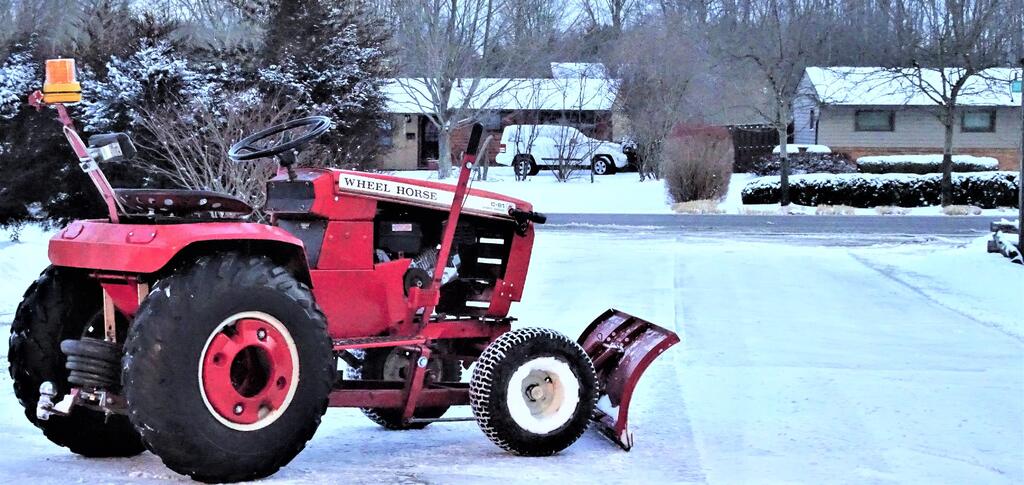

giddyap 1,574 #35 Posted January 30, 2022 The winter of 2020 this mild custom pushed snow like crazy. The 212 Predator with 26x8-12 atv tires may have skid once or twice and that was on ice. The hood was chopped 2" and had rechargeable LEDs and a blinky on the back. No chains, 25# wheel weights and 60#s on the hitch. Great Fun and then I sold it. 1 3 Share this post Link to post Share on other sites
slim67 2,825 #36 Posted January 30, 2022 33 minutes ago, giddyap said: The winter of 2020 this mild custom pushed snow like crazy. The 212 Predator with 26x8-12 atv tires may have skid once or twice and that was on ice. The hood was chopped 2" and had rechargeable LEDs and a blinky on the back. No chains, 25# wheel weights and 60#s on the hitch. Great Fun and then I sold it. I’m sure you’ll have another one on the drawing board if you don’t already! 2 Share this post Link to post Share on other sites

EB-80/8inPA 2,047 #38 Posted January 30, 2022 (edited) 21 hours ago, squonk said: 3" With a slot cut into it. Thanks. That looks like it’ll work well on the terrain and what passes for paving that I need to plow. I’ll probably try 2” as that’s what I have on hand. Actually, I may need to buy a piece of the correct diameter to engage the wear bar. 🤬 The price of PVC is stupid expensive these days! Edited January 30, 2022 by EB-80/8inPA Share this post Link to post Share on other sites
