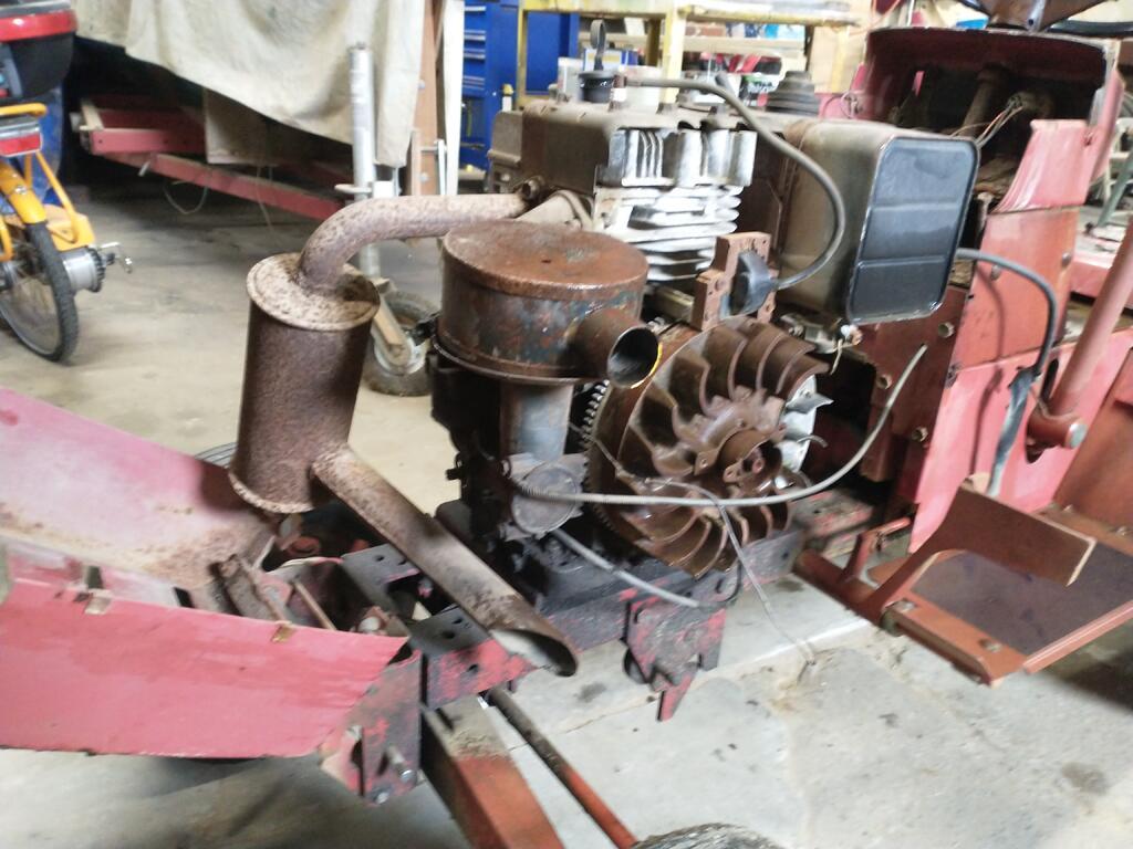

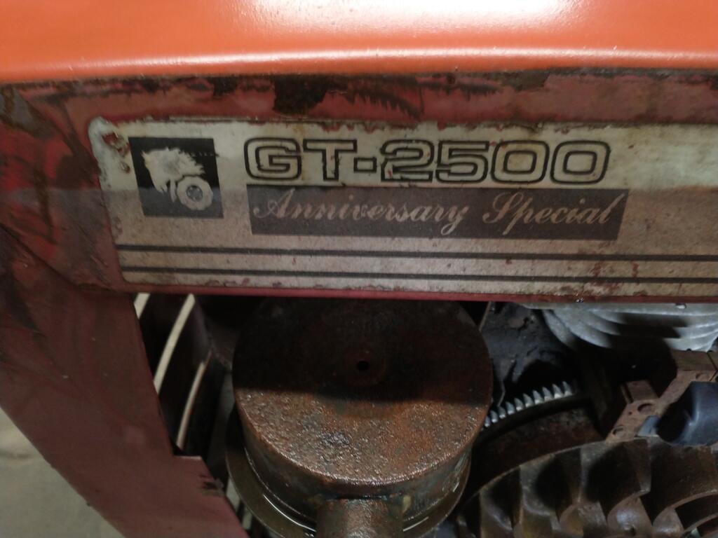

BubbaJ 6 #1 Posted January 23, 2022 Picked this up at the scrap yard the other day and would really like to rebuild it. Problem is, I don't have a clue what it is.I know it's a Kohler but no horsepower or model. My guess is that it it's a K but not sure which one. The fan shield is missing. The hood says GT-2500. The carb is in front and to the left with the air filter on the left. I'm new to Wheel Horse. Any help would be appreciated. 3 Share this post Link to post Share on other sites

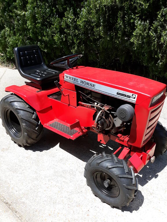

sgtsampay 117 #2 Posted January 23, 2022 That model was a one year only model and made with a 11hp Briggs. Just a basic aluminum version. Still have the though 8speed trans and able to use all of the normal attachments. 3 Share this post Link to post Share on other sites

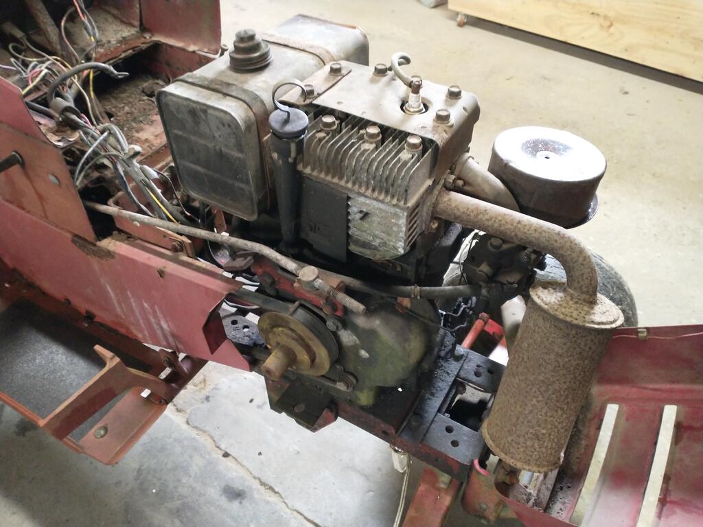

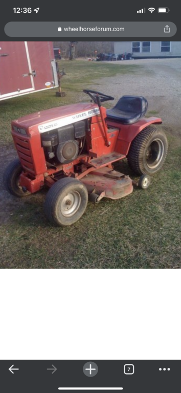

war eagle 80 #4 Posted January 23, 2022 It appears to be a 1981 GT 2500 Anniversary Special with an 11 hp Briggs B-252417. My neighbor and I have one here in Pace, Fl. 5 1 Share this post Link to post Share on other sites
