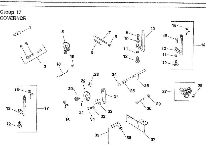

pfrederi 19,881 #7 Posted January 22, 2022 (edited) There is no bushing in a K181 governor #25 is a spacer. #3 is the governor shaft Edited January 22, 2022 by pfrederi 2 Share this post Link to post Share on other sites
