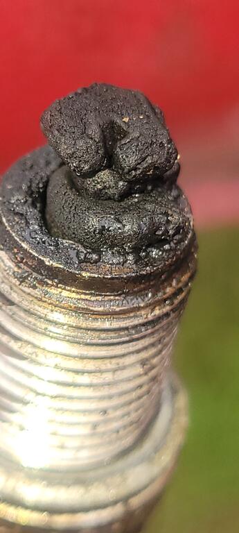

RED-Z06 2,718 #34 Posted January 21, 2022 I pulled these out of a 25hp Briggs Pro in a Z654 Deere at 63X hours yesterday...told the guy it was hurt, needs a refresh immediately...he said "put plugs in it...ill run it til it vents the block". Both plugs looked the same and she was down on power badly. These plugs only had about 15 hours on them according to him. 2 Share this post Link to post Share on other sites

lynnmor 8,914 #39 Posted January 22, 2022 18 hours ago, RED-Z06 said: I pulled these out of a 25hp Briggs Pro in a Z654 Deere at 63X hours yesterday...told the guy it was hurt, needs a refresh immediately...he said "put plugs in it...ill run it til it vents the block". Both plugs looked the same and she was down on power badly. These plugs only had about 15 hours on them according to him. Any chance that is one of the many Briggs that had the stupid wide spacing between head bolts? Those would blow between the cylinder and the opening for the push rods, causing extreme oil consumption Cheap, easy fix most of the time. As always, a compression test is needed.. 1 Share this post Link to post Share on other sites
RED-Z06 2,718 #40 Posted January 22, 2022 8 minutes ago, lynnmor said: Any chance that is one of the many Briggs that had the stupid wide spacing between head bolts? Those would blow between the cylinder and the opening for the push rods, causing extreme oil consumption Cheap, easy fix most of the time. As always, a compression test is needed.. Nah, Vtwin, "professional" model with the large canister filter. Somehow it ate alot of dust. I replace alot of head gaskets on the briggs singles, always at the push rod galley. 1 Share this post Link to post Share on other sites
