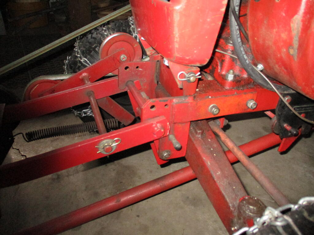

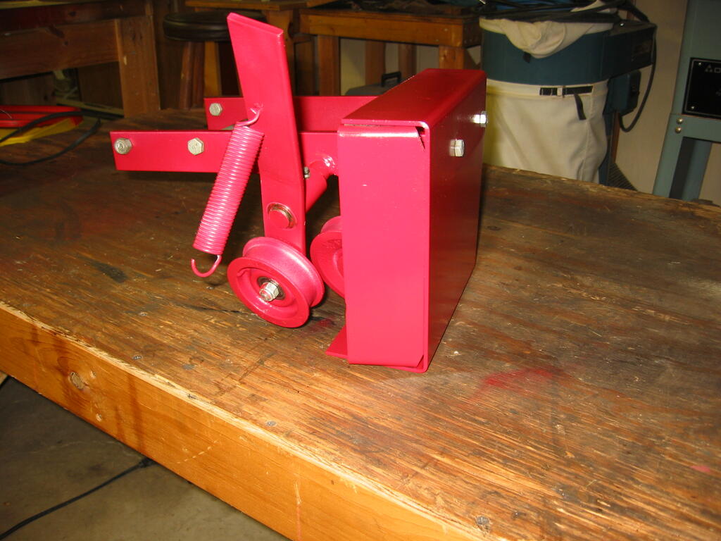

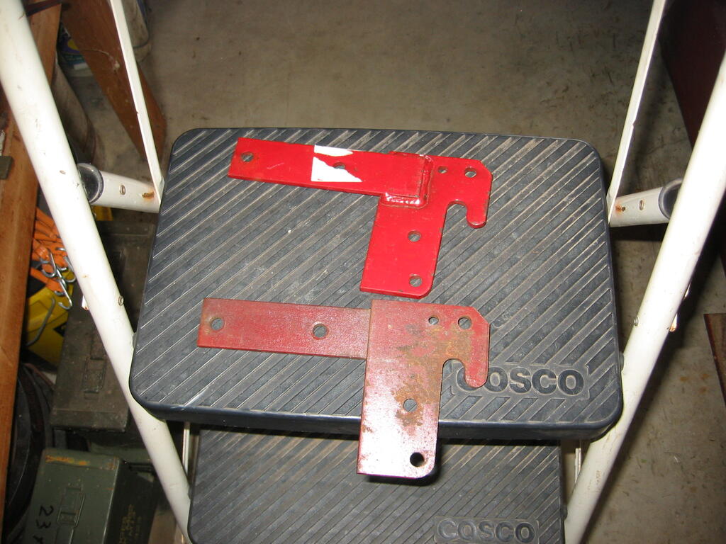

pfrederi 19,376 #2 Posted January 18, 2022 You will have to fix up the front tachmatic. There is an adapter plate set that I use part Number 8-5551. Picture 1 pic 2 shows then mounted on a Charger Search here other have bolted a regular front tach matic to the front of the tractor frame. 3 2 1 Share this post Link to post Share on other sites
