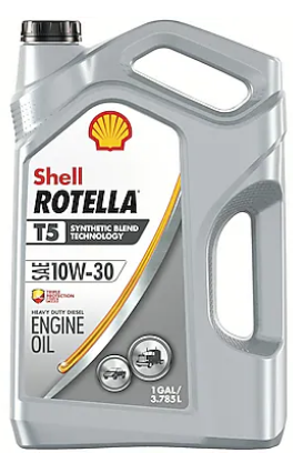

wh5208speed 677 #39 Posted January 15, 2022 Just to throw another option on the table. Shell Rotella also has a synthetic blend 10W-30 diesel oil that has good zinc content 1,200 PPM. 2 Share this post Link to post Share on other sites
