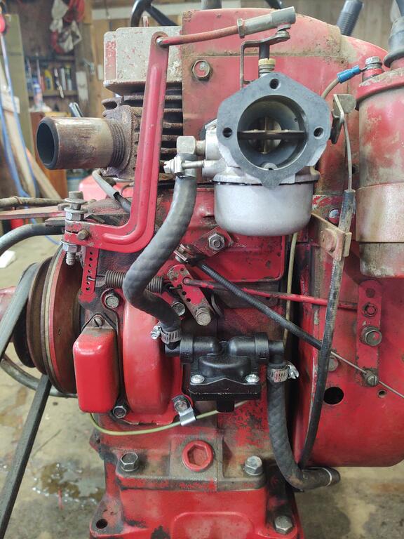

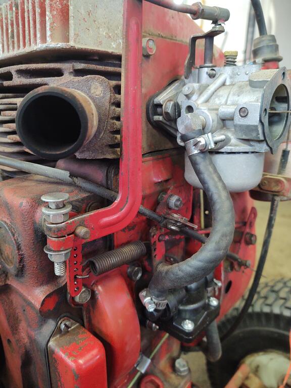

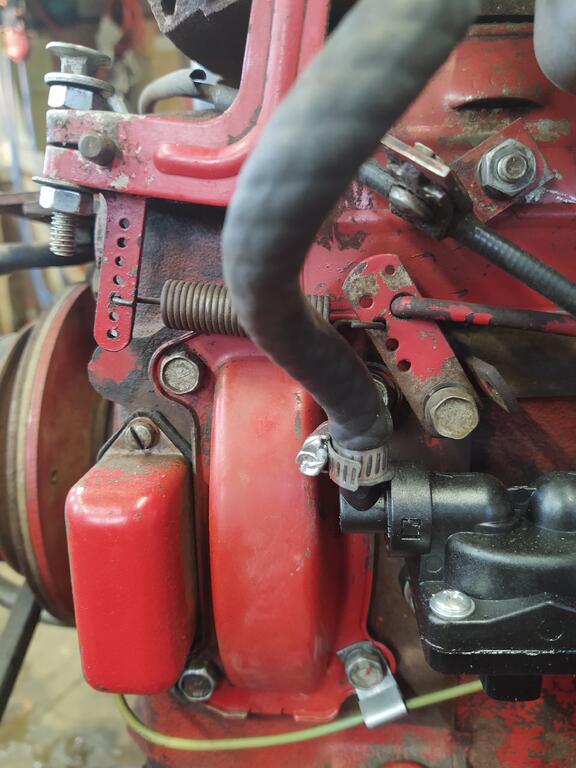

Joe 77 B100 84 #29 Posted January 13, 2022 Here are a couple picks with the throttle all the way down. Share this post Link to post Share on other sites

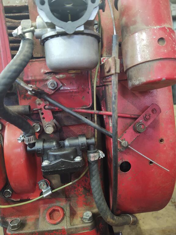

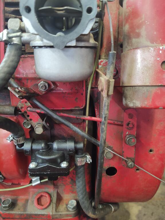

Joe 77 B100 84 #30 Posted January 13, 2022 And here with the throttle up or high. 2 Share this post Link to post Share on other sites
Jeff-C175 7,209 #31 Posted January 13, 2022 (edited) Pretty much where mine is set. I believe this is the 'factory' setting: If the engine holds steady RPM when going from no load to load, leave alone. If engine bogs when loaded, move left up one hole. Heat damaged throttle cable caused by too close to cylinder/exhaust. Could have been avoided by PO if he had put more 'slack' in the cable by clamping further out on the solid center wire: Edited January 13, 2022 by Jeff-C175 Share this post Link to post Share on other sites

Joe 77 B100 84 #34 Posted January 13, 2022 54 minutes ago, Jeff-C175 said: Pretty much where mine is set. I believe this is the 'factory' setting: If the engine holds steady RPM when going from no load to load, leave alone. If engine bogs when loaded, move left up one hole. Heat damaged throttle cable caused by too close to cylinder/exhaust. Could have been avoided by PO if he had put more 'slack' in the cable by clamping further out on the solid center wire: I think it WAS lower on the wire. About where you pointed. But, I moved it trying to get it to run at a higher rmp while I was using it. I thought it seemed like a quick fix. Put back to where you are pointing? But, yes, the muffler installed when I got it sits about 1" away from all of those fuel lines and plastic parts and exhausts down to the lower left as you sit on the mower. Down where the hood clamps to the frame. Is that right? Share this post Link to post Share on other sites
pfrederi 20,885 #35 Posted January 14, 2022 None of my big blocks have three holes in the bell crank. Try moving your to the outer hole... Share this post Link to post Share on other sites
Jeff-C175 7,209 #36 Posted January 14, 2022 1 hour ago, Joe 77 B100 said: Put back to where you are pointing? My suggestion is to move BOTH of those points in order to move the cable away from the cylinder. 1 Share this post Link to post Share on other sites
Joe 77 B100 84 #37 Posted January 14, 2022 1 hour ago, pfrederi said: None of my big blocks have three holes in the bell crank. Try moving your to the outer hole... Sorry buddy, but you can't use technical lingo with me. I cannot follow. Can you use one of the pics I posted and be more direct? Share this post Link to post Share on other sites
Joe 77 B100 84 #38 Posted January 14, 2022 37 minutes ago, Jeff-C175 said: My suggestion is to move BOTH of those points in order to move the cable away from the cylinder. Ditto. Too technical for me and I am not sure what you're talking about. I don't know what a cylinder is. Keep in mind I am a biology professor who happened to be given a Wheel Horse. I have a strong desire to fix it and learn but I might be called what you folks call an "idiot" when it comes to engines. You gotta talk to me like I am a kindergartener. 1 Share this post Link to post Share on other sites
Jeff-C175 7,209 #39 Posted January 14, 2022 (edited) 1 hour ago, Joe 77 B100 said: Sorry buddy, but you can't use technical lingo with me. I cannot follow. Can you use one of the pics I posted and be more direct? Joe, I believe Paul is referring to this and suggesting that you move the rod to the next hole up, but I have no idea why. It appears that the rod has always been in the lower hole from the factory, there's no evidence that it was ever in the top hole. And here's my 1980 K301, not in the top hole, never was. Pay no attention to the length of the cable, the one on my machine has been replaced and whoever installed it either bought one a little too short, or cut it too short. That bar with the holes is referred to as a 'bellcrank'. Edited January 14, 2022 by Jeff-C175 Share this post Link to post Share on other sites

Jeff-C175 7,209 #41 Posted January 14, 2022 (edited) 1 hour ago, Joe 77 B100 said: move BOTH of those points That cable is real close to the engine cylinder in the area circled in yellow. The cable plastic sheath is already melted so it's sorta a moot point, but if you move the entire cable up by loosening both clamps, you will have more distance between the cable and the engine: If you loosen both and move the cable away from engine and don't change the relative distance between the two points, there will be no change in operation. Edited January 14, 2022 by Jeff-C175 Share this post Link to post Share on other sites
