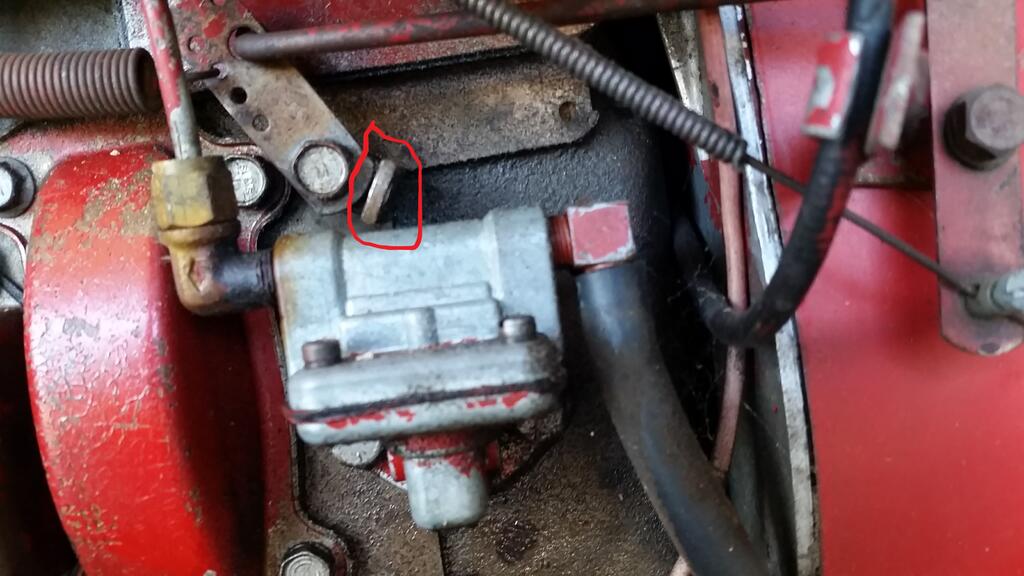

Joe 77 B100 84 #1 Posted January 12, 2022 Hey there folks. I got my 77 B100 running but I had to adjust a lot to get to that point. I think I got the carb back together well but I DID have to adjust the governor arm and the wire from the lever on the dash. When full throttle, the engine doesn't really sound like its in full throttle and the snowblower was definitely "weak" when I tests it out. I think I need to adjust the governor and get it to work at a higher rpm. But, someone said to make sure I don't just do it and end up burning up the engine. 1) How does one know that the engine throttle settings/governor are set right and 2) Can someone send me to a thread with pics or a video or, better yet, to a YouTube video that shows me how to make sure I have it set right and/or adjust it? I can send a video of it on full and low throttle but maybe you cannot know it is set right just by sound. Thanks in advance for your help. Share this post Link to post Share on other sites
oliver2-44 11,214 #2 Posted January 12, 2022 Do you have access to any sort of RPM measuring device? When you say you adjusted the governor arm, do you mean the adjustable rod between the governor and carb, or the governor itself? Since getting a tach, I feel more confident doing tuning and Governor setting. Just setting by ear, my engines were all running slow on the lower end (1250) and the upper end (3600) Here's some Tach reference material. https://www.mechanicwiz.com/small-engine-tachometers/ If you get something like this make sure it has a replaceable battery, looks like most of them do now. Several years ago I bought one of them an battery was not replaceable, so it was trash in a year. https://www.amazon.com/gp/product/B07DZB57H5/ref=as_li_qf_asin_il_tl?ie=UTF8&tag=mechanicw-20&creative=9325&linkCode=as2&creativeASIN=B07DZB57H5&linkId=6cd6ea5b3598026c50dffc8189f4e501 https://housetechlab.com/how-to-measure-engine-rpm-with-a-multimeter/ https://www.fullyinstrumented.com/best-tachometer/ https://www.fullyinstrumented.com/best-tachometer/ I have the Neiko 20713A Lazer Non Contact Digal tachometer $24. You put a little piece of reflective tape on the shaft or flywneel for the lazer to read and it works good 2 1 Share this post Link to post Share on other sites
rmaynard 16,866 #3 Posted January 12, 2022 Before doing anything, use the static timing method to be sure you have the correct timing. Use this link: https://mgonitzke.net/cubcadet.html Click on HowTo and download the pdf file. Follow the instructions in the Kohler manual to the letter when adjusting the governor. Tune the carburetor as the Kohler manual says. However, I am the type of guy who starts with the basic Kohler info, then I tune by ear. In other words, even it might not be exactly by the book, if it sounds good, it usually is. Checking RPM is a simple as buying a $20.00 laser tachometer from Amazon. It was only $8.00 when I got one in 2011. That's inflation for you. https://www.amazon.com/gp/product/B001N4QY66 2 Share this post Link to post Share on other sites

WHX?? 55,005 #10 Posted January 12, 2022 1 hour ago, rmaynard said: $20.00 laser tachometer from Amazon. I been eyeballing that one Bob ... The one I got is a piece of crapadoodle. Gonna pull the trigger you say it's good enough for a backward hammer mechanic. Guessing you have a manual Joe? If not we can get you one the procedure for adjusting the guv arm is in there. Also if your motor has the thing circled in this pic it is the rev limiter It should be adjust upward so the bellcrank arm hits it at full throttle at 3600 RPM. . Its way off in this pic. Some pics of how your linkage is set up would help us help you alot. 1 Share this post Link to post Share on other sites

Jeff-C175 7,207 #18 Posted January 13, 2022 (edited) 53 minutes ago, Joe 77 B100 said: setting of the governor lever ...sounds correct. Which holes is the governor spring in? @WHX?? posted a pic of the top end limit, is yours in a similar position? That one is a bit on the lower [edit:] HIGHER speed side, further counterclockwise would be more normal. Edited January 13, 2022 by Jeff-C175 2 Share this post Link to post Share on other sites

Joe 77 B100 84 #25 Posted January 13, 2022 18 minutes ago, Jeff-C175 said: Which holes is the governor spring in? @WHX?? posted a pic of the top end limit, is yours in a similar position? That one is a bit on the lower speed side, further counterclockwise would be more normal. Yeah. When I pulled off some of the items to get to the carb, I didn't take pictures to be sure where it was- but I am not even sure the PO had it in the right hole. If there is a "right" hole, why are there the 5 or 6 in the arm? I will take pics and post them for you folks later after I get some work done today. Share this post Link to post Share on other sites
