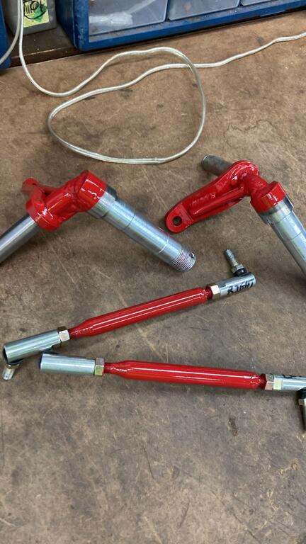

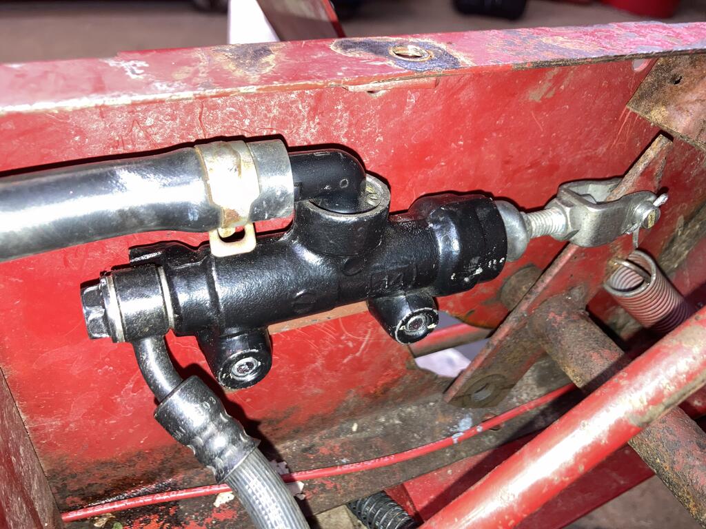

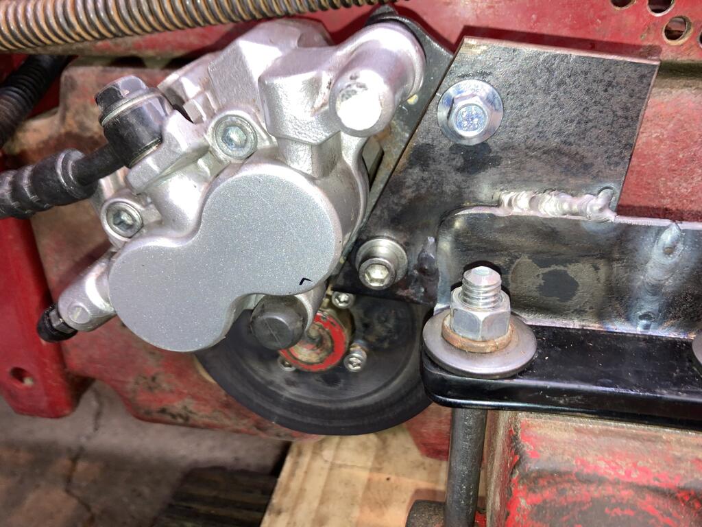

Crazy_Carl 254 #41 Posted November 27, 2023 (edited) Hello! I haven't been on here in a while. These videos go very in depth. Enjoy! I combined new wheel horse spindles with trailer spindles to create a bulletproof spindle with heavy duty tapered roller bearings. Now I have cast iron trailer hubs that I have drilled and tapped for a 45 degree grease fitting. I also had to lengthen and rebuild my tie rods. Flawless braking performance has been achieved🥳 Note: Thunderstruck by AC/DC is the best test drive song to have on repeat in your Beats. It's so nice having a well engineered and executed brake system that works just as well stopping you in reverse as it does going forward. The pedal feel is perfect and very similar to a hydraulic rear disc brake on a Polaris Trailblazer that I had. Also it's weird running hot laps around your house when it's pitch black out at 6 PM. Great test of the Tiny Tach too as it is handy to have. Also this engine really likes cold 32 degree air and no drag from the jenky brake band. This thing goes from 0-15mph in a hurry starting in 2nd and shifting into 3rd on the fly Edited November 27, 2023 by Crazy_Carl 3 3 Share this post Link to post Share on other sites

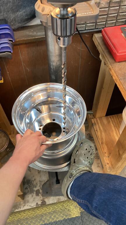

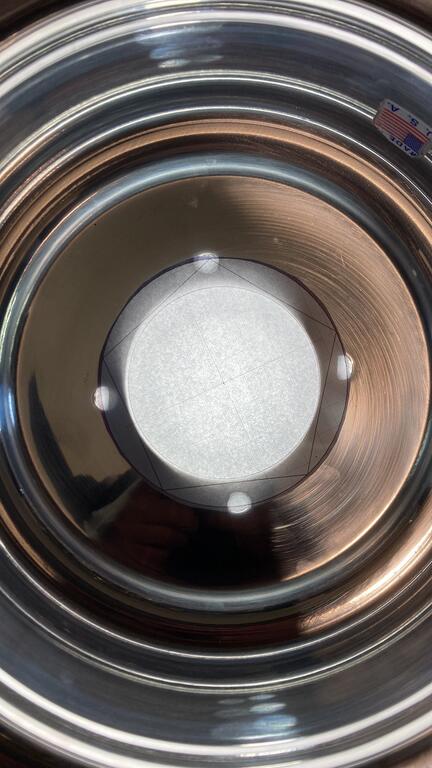

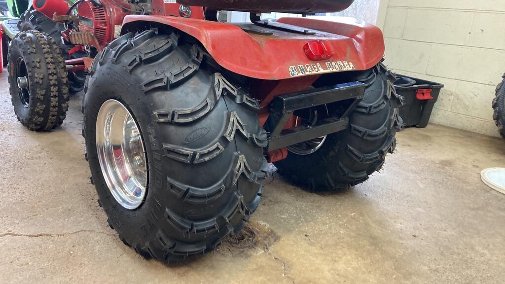

Crazy_Carl 254 #42 Posted December 9, 2023 Well after upgrading my Mac OS so I could run FreeCad and make a template for a 5 on 4.5" bolt hole circle to re-drill my brand new ALUMINUM RIMS, RED STAG has a new pair of shoes! 25x11-10 ITP Mudlites to be exact. I like the trusted mud performance and how squishy they are. Then I used some scales to weigh what the tractor weighs with me on it with the help of my Dad to read the scales and it comes to a light 665 lbs with rider with a 100 lb difference between the front and rear axles. This doesn't include the toolbox or beers in the trunk lol. 1 1 Share this post Link to post Share on other sites
