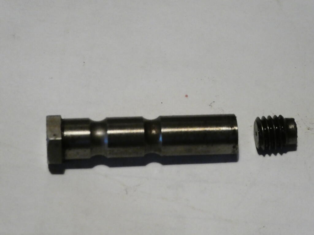

Stormin 9,987 #1 Posted January 8, 2022 (edited) Couple of months or so ago, I lost low speed on my C81. So the trans was stripped and I found the hi/low selector fork was broken. Friend of mine successfully welded it up and I got it back last week. Today I set too to reassemble the trans. Using one of Steveasaurus's videos so I would get things back as they should be. I did notice as I replaced the hi/lo selector, that the bolt had a slight wobble. Anyway it did go in ok and the selector worked ok. Getting the detent balls in was another thing. Three times the last one dropped down into the case bottom. I had to take the hi/low selector out to recover it. Now I think the bolt must have got ever so slightly bent below the shoulder and the fitting and removing of it weakened it at that point. The result is in the photo' below. As you can see, I managed to get the broken bit of thread out after much fiddling and Hopefully I can get a replacement or if push comes to shove, another trans'. Edited January 8, 2022 by Stormin 6 Share this post Link to post Share on other sites
stevasaurus 23,619 #2 Posted January 8, 2022 Norm, can't believe you broke that bolt. Anyway, TORO sells those parts for the fork assembly either as a unit or by the individual part.. "bolt - detent" part # 7213. Try the "Wanted Classifieds". Some one may have an old fork assembly they replaced. 3 Share this post Link to post Share on other sites
Stormin 9,987 #3 Posted January 8, 2022 43 minutes ago, stevasaurus said: Norm, can't believe you broke that bolt. I think the damage was done when the fork broke. I'm not that heavy handed. Just finished it off. 3 Share this post Link to post Share on other sites
ranger 1,844 #4 Posted January 8, 2022 Bad luck Norm, but a good excuse to put in some ‘Lathe’ time! 1 Share this post Link to post Share on other sites
Stormin 9,987 #5 Posted January 8, 2022 It's a hardened bolt, Doug. Share this post Link to post Share on other sites
ranger 1,844 #6 Posted January 8, 2022 28 minutes ago, Stormin said: It's a hardened bolt, Doug. You could machine it out of a 12.9 socket head cap screw and harden it, or, mild steel and ‘Case’ harden it. (In the wood burner). 2 Share this post Link to post Share on other sites
8ntruck 8,609 #7 Posted January 9, 2022 4 hours ago, Stormin said: It's a hardened bolt, Doug. Or use a ceramic cutting tool in the lathe. Share this post Link to post Share on other sites

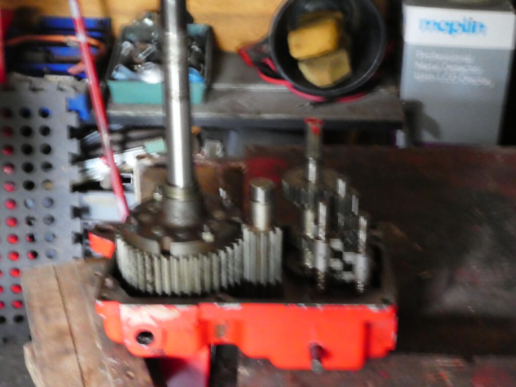

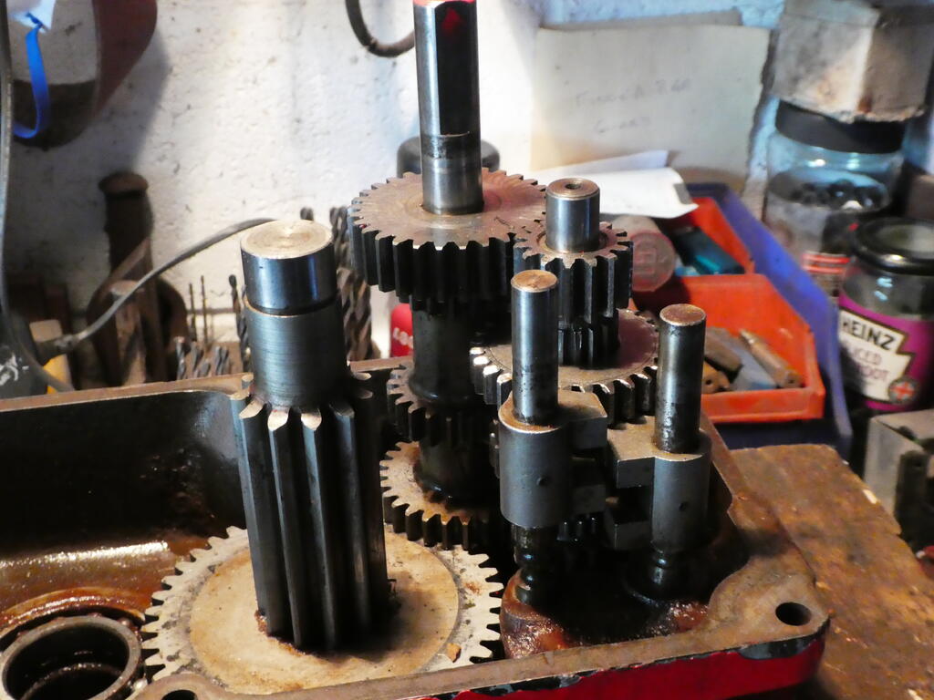

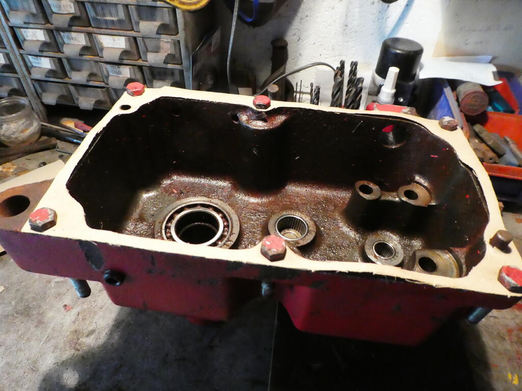

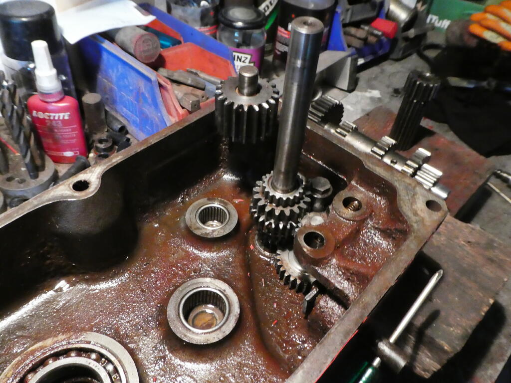

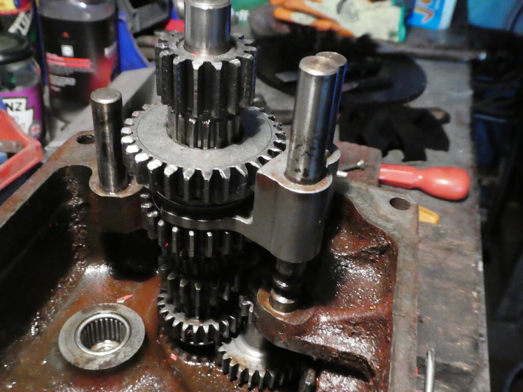

Stormin 9,987 #13 Posted May 22, 2022 Had a go at the trans today and to save some earache, took some photo's. Had to make a gasket. Everything seemed free so fitted the other case half. Trying the gears something didn't sound just right so split the box. I can't see anything amiss. Everything seems to work ok but I've called it a day for now. May get back to it tomorrow or Tuesday if not required at the farm. These things are sent to try us. 1 Share this post Link to post Share on other sites
