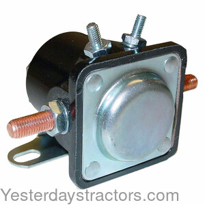

953 nut 64,126 #2 Posted January 8, 2022 (edited) Any lawn mower of garden tractor solenoid will get the job done. I prefer the old style FORD ones because they should last a lifetime. https://www.yesterdaystractors.com/311006_Starter-Solenoid_32639.htm?gclid=Cj0KCQiAieWOBhCYARIsANcOw0wef6wamDn9J_p_GYpzPDX9T0813PeH7y7Ud0H4oL98PnxayFj2noQaAsthEALw_wcB The "I" terminal will not be used on this unit and it is grounded internally so no ground wirer is needed. Edited January 8, 2022 by 953 nut 3 1 Share this post Link to post Share on other sites
