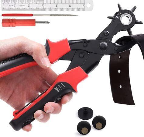

wallfish 19,312 #8 Posted January 11, 2022 Even a cheap set of paper hole punches makes quick accurate work for the smaller bolt holes. Or the leather punch. The punch type you hammer on work too but these leave nice clean hole edges on both sides. 2 Share this post Link to post Share on other sites
