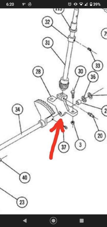

TractorChild97 158 #1 Posted January 7, 2022 I need a bronze bushing. Not sure what size to get. Thanks for any help! Share this post Link to post Share on other sites

8ntruck 8,014 #4 Posted January 7, 2022 (edited) I've never worked on this part of a Wheel Horse, but I don't think they came from the factory with a bushing there. You can probably find a 3/4" ID bushing in the small parts section of your local hardware store. Get one and drill/ream the hole in part #28 to match whatever the OD of the bushing is. Since there are gears involved here, you will want to make sure you don't move the center of the hole when you enlarge it to fit the bushing. Edited January 7, 2022 by 8ntruck 1 1 1 Share this post Link to post Share on other sites
Jeff-C175 7,206 #5 Posted January 7, 2022 (edited) 3 hours ago, TractorChild97 said: Not sure what size to get Why not get the correct one for the machine? That highlighted round item with the number off the screen shot is the bushing you need. Edited January 7, 2022 by Jeff-C175 3 Share this post Link to post Share on other sites

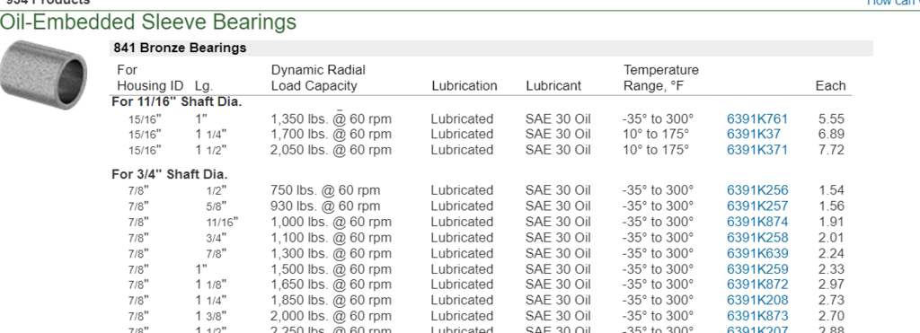

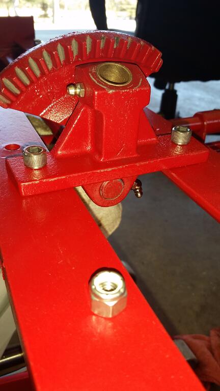

WHX?? 52,269 #10 Posted January 7, 2022 (edited) 3/4 X 7/8 the way it looks. Should be in the Hillman drawers at hardware stores but luck of the draw. May have to trim to length. McMaster has a nice selection as well. One resto I put a zerk there just for Mr Lena. Edited January 7, 2022 by WHX?? 2 1 Share this post Link to post Share on other sites
EB-80/8inPA 1,893 #11 Posted January 7, 2022 28 minutes ago, WHX?? said: One resto I put a zerk there just for Mr Lena. It’s the least one could do in appreciation of his stalwart efforts to keep this place friction free. 4 1 Share this post Link to post Share on other sites

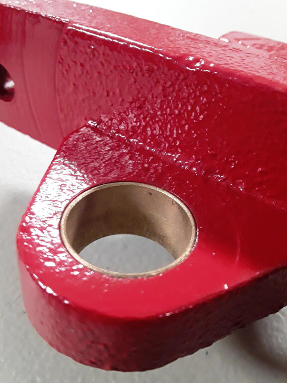

pacer 3,177 #12 Posted January 7, 2022 36 minutes ago, WHX?? said: 3/4 X 7/8 the way it looks. I agree with @WHX?? on the 3/4x7/8 .... I had one so wallowed out/oval shaped that the 7/8 diameter would/nt cover - so I took it out to 1" (they do make them with thicker OD walls) 3 Share this post Link to post Share on other sites
