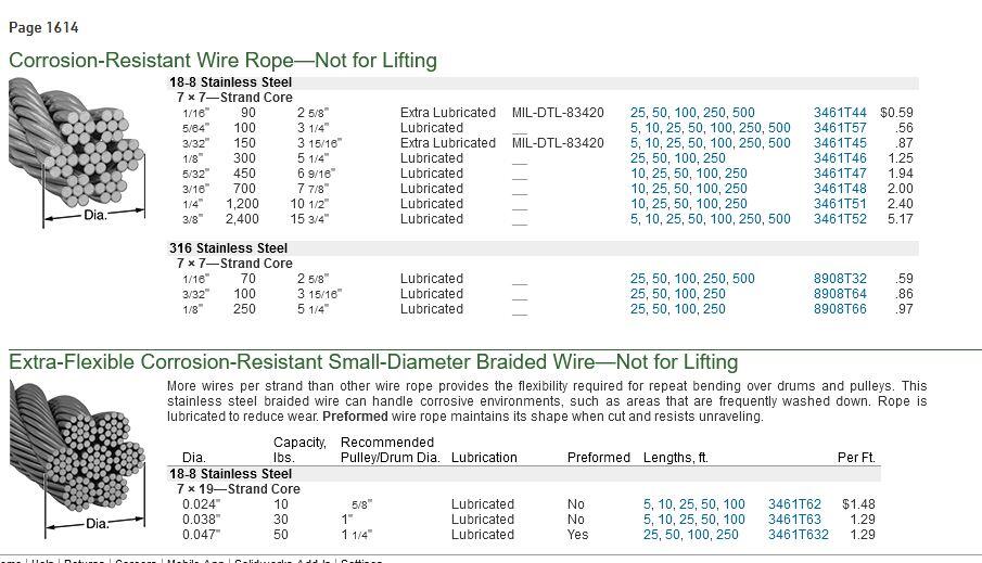

pfrederi 18,863 #26 Posted January 17, 2022 (edited) You want extra flexible wire rope. The stuff in most hardware stores will probably be 7x7 and is too stiff I am using the 7X19 1/16" stainless Edited January 17, 2022 by pfrederi 2 1 Share this post Link to post Share on other sites

Jeff-C175 7,206 #32 Posted January 24, 2022 On 1/17/2022 at 11:06 AM, pfrederi said: You want extra flexible This is what I used, took a chance being it was so cheap, but so far it seems to be working out well. Not sure of the stranding, but it is quite flexible 1 Share this post Link to post Share on other sites

peter lena 9,394 #34 Posted January 26, 2022 @Joe 77 B100 agree with jeff, above on the 1/16 stainless cable pull , did it a few times with fishing line to verify what works , then replaced with the cable. notice your spring pulled idler / drive pulley frame forward end of frame , has dry powdery " swing movement points ". if those swing points are lubricated , your belt drive will be more efficient , another area often neglected is the chute base to blower housing mount , super lube / teflon aerosol lubricant on the base and inside the chute area , makes it smooth and helps release snow. also lubricate the cable guides on the outside of the chute to cable pull , replacing lubricant for rust , is easy , its showing itself to you , also keep that auger drive chain / gear lubricated , never let it dry out , 1/ 2" play on that drive chain . pete 1 Share this post Link to post Share on other sites

Joe 77 B100 84 #39 Posted January 27, 2022 (edited) On 1/23/2022 at 9:08 PM, Jeff-C175 said: This is what I used, took a chance being it was so cheap, but so far it seems to be working out well. I bought new wire and now have extra length to play with which helped a lot when trying to place it correctly on the spindle and chute. And, I found that making sure it winds tightly around the spool at the end of the hand-crank also makes things much more smooth. Edited January 27, 2022 by Joe 77 B100 2 Share this post Link to post Share on other sites
