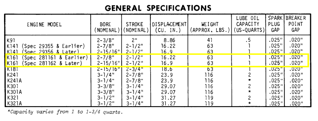

WheelhorseBob 1,550 #1 Posted January 4, 2022 Fellas, I have a 161 that has a .030 piston and is badly scored. It’s a 1961 vintage and dare I say not a Horse😬. Anyway you blokes never steer me wrong. I’m being told 161’s came in two different bore sizes? Is that a true statement? If so can the smaller bore be bored out to the upper end of a large bore? Share this post Link to post Share on other sites
rmaynard 16,771 #2 Posted January 4, 2022 (edited) 12 hours ago, WheelhorseBob said: Fellas, I have a 161 that has a .030 piston and is badly scored. It’s a 1961 vintage and dare I say not a Horse😬. Anyway you blokes never steer me wrong. I’m being told 161’s came in two different bore sizes? Is that a true statement? If so can the smaller bore be bored out to the upper end of a large bore? The K-161 did come in two sizes. Can't tell you about how large either one can be bored. I guess a lot would depend on whether or not over-sized pistons and rings are still available. Edited January 4, 2022 by rmaynard Share this post Link to post Share on other sites
ri702bill 10,973 #3 Posted January 4, 2022 17 minutes ago, rmaynard said: I guess a lot would depend on whether or not over-sized pistons and rings are still available. It is my understanding that there are no oversized pistons nor rings available anymore for the early small bore K161's. Not sure IF you can safely bore the early blocks to the standard bore of the later style. Bill Share this post Link to post Share on other sites
squonk 45,082 #4 Posted January 4, 2022 Might be able to sleeve it and go STD. Share this post Link to post Share on other sites
Pullstart 68,646 #5 Posted January 4, 2022 Wait up. The 141’s and 161’s had identical bore and stroke? What made the difference in power? Share this post Link to post Share on other sites
ri702bill 10,973 #6 Posted January 4, 2022 Just a guess with no actual proof (like that never happened here before !!) perhaps a smaller bore carburetor or less lift on the cam to keep the valves open for less of the 4 stroke cycle??? Bill 1 Share this post Link to post Share on other sites
Handy Don 15,637 #7 Posted January 4, 2022 The Onan P218 and P220 get much of the 2hp difference from a slightly different cam Share this post Link to post Share on other sites
