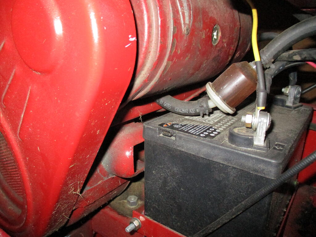

Wheelhorse#1 1,879 #4 Posted January 3, 2022 (edited) Thanks for the responses. This is what I’m looking at at replacing.It’s a 1971 Briggs 8hp.It still runs but has a bad rod knock ,smokes like a freight train ,needs major work/rebuild.It’s been rebuilt 3 times in its life already. It looks like everything bolts up about the same place as the kohler but not sure if bolt pattern is the same.Im guessing it will be different bolts etc. Edited January 3, 2022 by Wheelhorse#1 Share this post Link to post Share on other sites

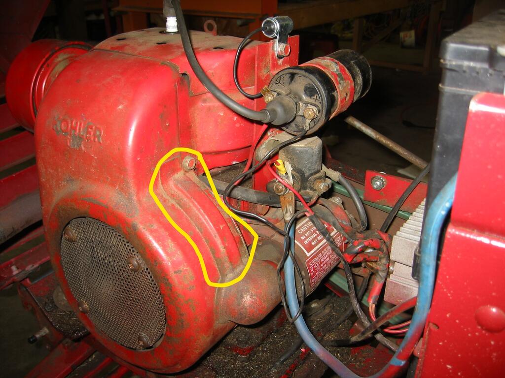

pfrederi 18,971 #5 Posted January 3, 2022 (edited) I am converting a second bendix K-181 to a S/G right now. If you want to reuse your current air shroud it will not allow you to mount a battery in the tray you have to hack off part of the bump out. It doesn't interfere with the S/G itself. If you find a S/G air shroud you will have to take the ring gear off your flywheel. In addition to the bump out for the bendix nose there is an add on space for the flywheel ring gear on Bendix air shroud. Edited January 3, 2022 by pfrederi 1 1 Share this post Link to post Share on other sites
pfrederi 18,971 #6 Posted January 3, 2022 This is what I had to cut on my first conversion where I used Bendix air shroud. 1 1 Share this post Link to post Share on other sites
Wheelhorse#1 1,879 #7 Posted January 3, 2022 2 hours ago, pfrederi said: This is what I had to cut on my first conversion where I used Bendix air shroud. Very helpful info.So it looks like it’s best too use the original Bendix shroud rather than having to mess with the flywheel. Also wondering if the S/G motor on the Briggs will mount onto the Kohler mounts are in same location anyway. Guess I won’t really know until I start disassembling/reassemble all the parts. This pic is where the mounting bracket is on the Briggs.I’m guessing there will be some modifications, it couldn’t be that easy😬 I really like the old school S/Gs, it’s worth it for me to do the extra work. Thanks for your help. Share this post Link to post Share on other sites

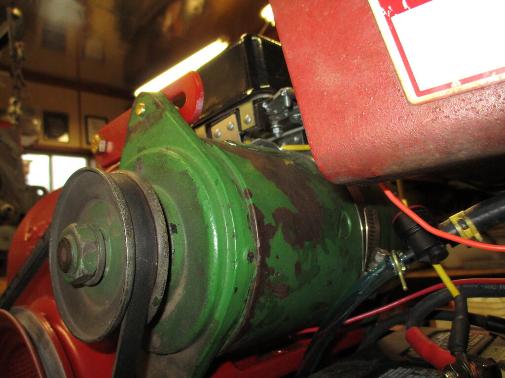

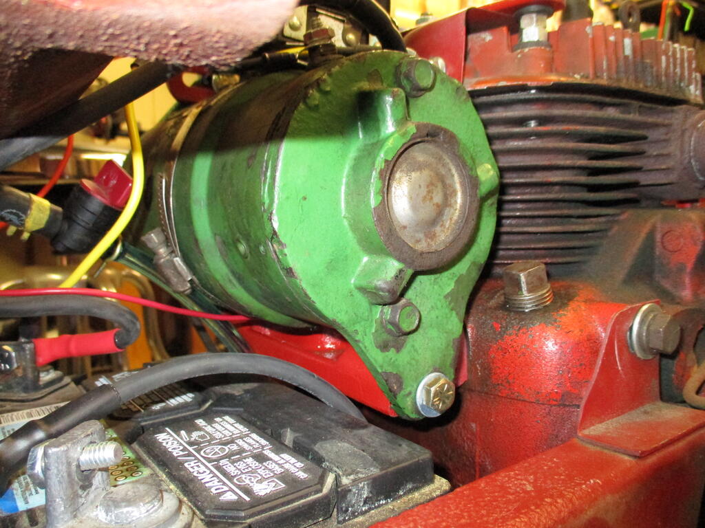

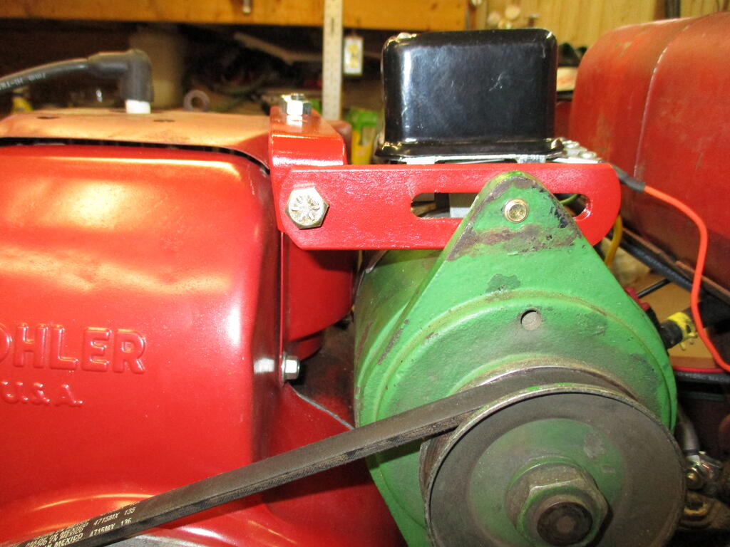

pfrederi 18,971 #8 Posted January 3, 2022 (edited) I would guess (emphasis GUESS) that sine Delco made the generator for many engine manufacturers the unit other than direction rotation and provision for saddle mount regulatror (tapped holes in the housing) would be the same. You would have to round up Kohler lower bracket and two upper ones. The lower tabs on the genny are 8" outside to outside and the top mount tab is 180degrees off the bottom one Some pics of the JD S/G I am putting on a K181 Edited January 3, 2022 by pfrederi 1 1 Share this post Link to post Share on other sites

Wheelhorse#1 1,879 #10 Posted January 3, 2022 36 minutes ago, pfrederi said: I would guess (emphasis GUESS) that sine Delco made the generator for many engine manufacturers the unit other than direction rotation and provision for saddle mount regulatror (tapped holes in the housing) would be the same. You would have to round up Kohler lower bracket and two upper ones. The lower tabs on the genny are 8" outside to outside and the top mount tab is 180degrees off the bottom one Some pics of the JD S/G I am putting on a K181 Great work. Good to know about the mounting brackets.Briefly looked on the flea bay, there’s a few out there available and not too pricey. thanks for your help ! Share this post Link to post Share on other sites
