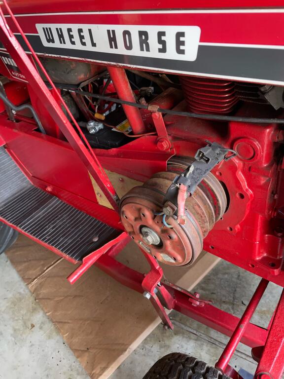

Sodaking27 1,118 #1 Posted January 2, 2022 Working on the Bronco 14 today. Purchased a used working electric PTO to install. Removed the duct tape my father in law installed when he removed the PTO and discovered this. key appears to be bent up and the back edge is rounded. Can someone provide me the size I need to purchase to replace this and can I get it at TSC? Also any good advice on getting the drive belt pulley off. Thanks Don 2 Share this post Link to post Share on other sites

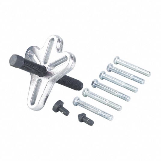

squonk 45,530 #4 Posted January 2, 2022 (edited) You need a harmonic balancer ( bolt grip) puller. Puller bolts into the threaded holes on the pulley. A puller that grabs the edge of the pulley will break it. Edited January 2, 2022 by squonk 7 2 Share this post Link to post Share on other sites

Snoopy11 5,731 #9 Posted January 2, 2022 3 minutes ago, squonk said: I am picking one of those up next time I go to Lowes... looks like about 17$ That could have made my life much easier... days... months... years ago... Don 1 Share this post Link to post Share on other sites

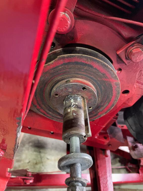

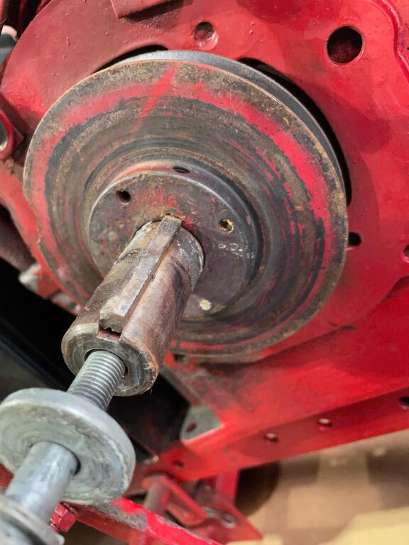

Sodaking27 1,118 #11 Posted January 2, 2022 Thanks to everyone for their input. That’s what makes this site so awesome. I will be picking up one of the harmonic balance pullers tomorrow. Looks like someone else tried removing the pulley from pulling on the side. You can see a chunk is already in the picture.Also going to replace the idler pulley and belt while I have it apart. Toro belt or blue Kevlar from TSC? Thanks again everyone. 1 Share this post Link to post Share on other sites

Wheelhorse#1 1,901 #15 Posted January 3, 2022 5 hours ago, squonk said: You need a harmonic balancer ( bolt grip) puller. I bought a set like this but with more bolt assortments .Not bad, got it at Harbor Fraud 3 Share this post Link to post Share on other sites
squonk 45,530 #16 Posted January 3, 2022 Don't forget to remove the allen screws that hold it on. Also if you have a 1/4' tap it's a good idea to clean the threads on the pulley so the bolts go in far enough to get a solid bite on the pulley. 4 2 Share this post Link to post Share on other sites

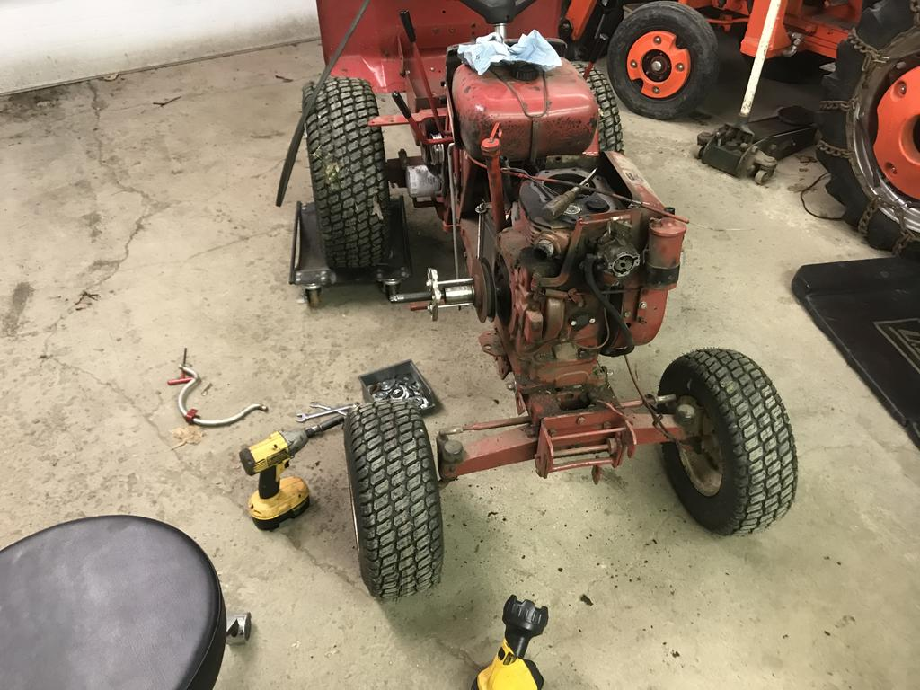

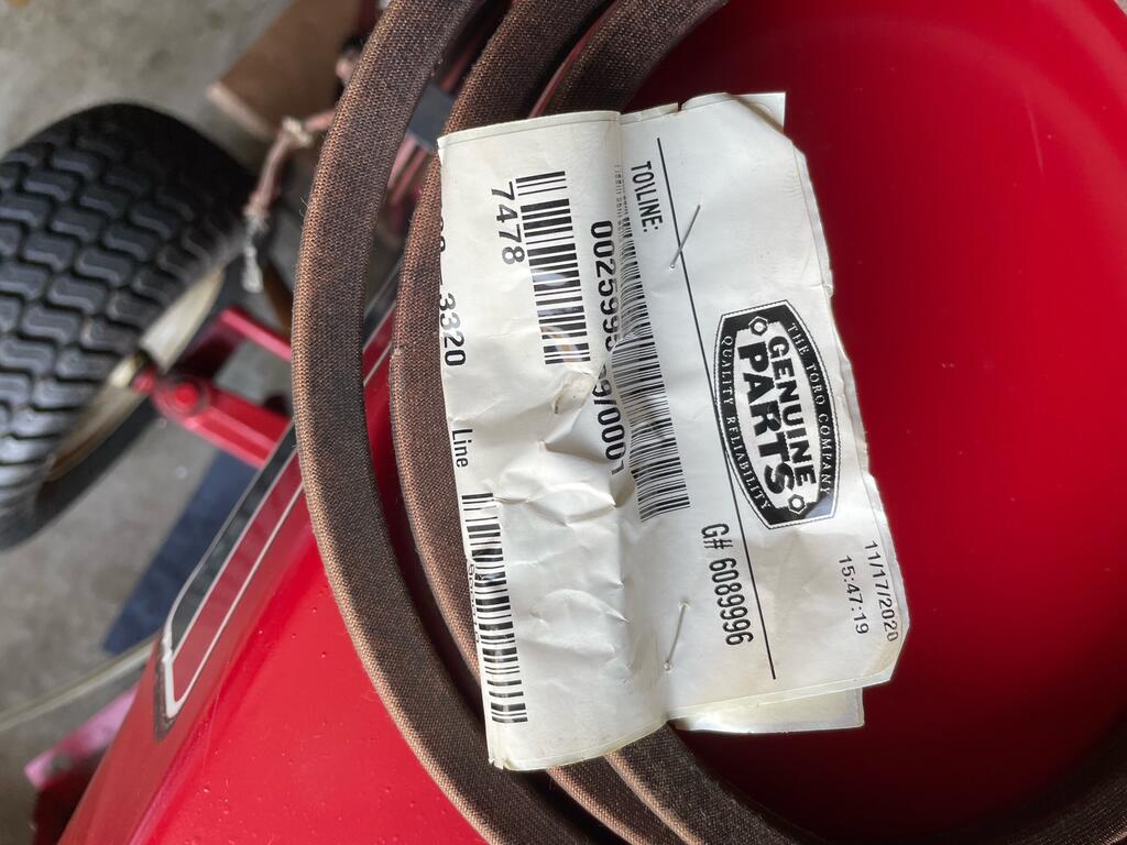

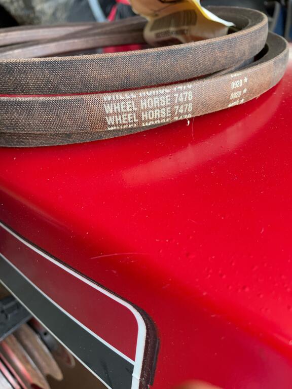

Sodaking27 1,118 #23 Posted January 4, 2022 Thanks to everyone’s advice it’s all fixed. Just waiting on the new connectors for the clutch. Ended up going to my local WH dealer and picking up a new belt. Thought it was interesting the belt actually had Wheel Horse on it. Wondering how old the belt is. Now I need to drop the snow plow bracket and put it on correctly so it moves the leaver back away from the clutch. 2 1 Share this post Link to post Share on other sites

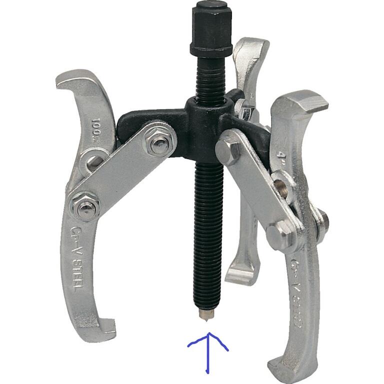

RetroMower 350 #24 Posted January 4, 2022 On 1/2/2022 at 4:03 PM, squonk said: You need a harmonic balancer ( bolt grip) puller. Puller bolts into the threaded holes on the pulley. A puller that grabs the edge of the pulley will break it. This puller has been a longtime resident in my toolbox since forever. You'll likely want an assortment of different bolt lengths and diameters. My only advice with these is the pointy inserts that center in whatever shaft you are trying to rid of its gear or pulley. If used it can dig and flare the end of smaller shafts if great force is necessary. Use a flat insert when possible to break it free and switch to the pointy one with grease to finish removal 1 Share this post Link to post Share on other sites
