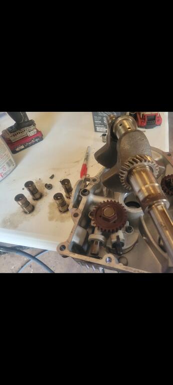

Yes.  Command CH/CV twins and singles used a net lash valve train with full pressure lubrication at all journals and hydraulic flat tappet lifters.
  • Thanks 1
RED-Z06
From a Command Twin i rebuilt in the Fall.
