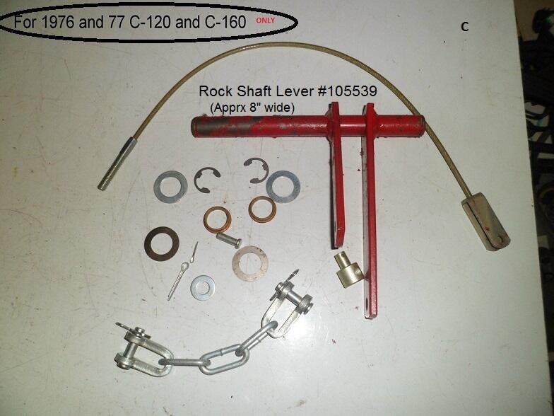

Moparfanforever 886 #1 Posted January 1, 2022 I got this rockshaft #105539 (bottom)thinking it would work on B or C Series tractors but it is two inches longer than the rockshaft above it that came off of a C160. Can anyone tell me what this fits?? Share this post Link to post Share on other sites

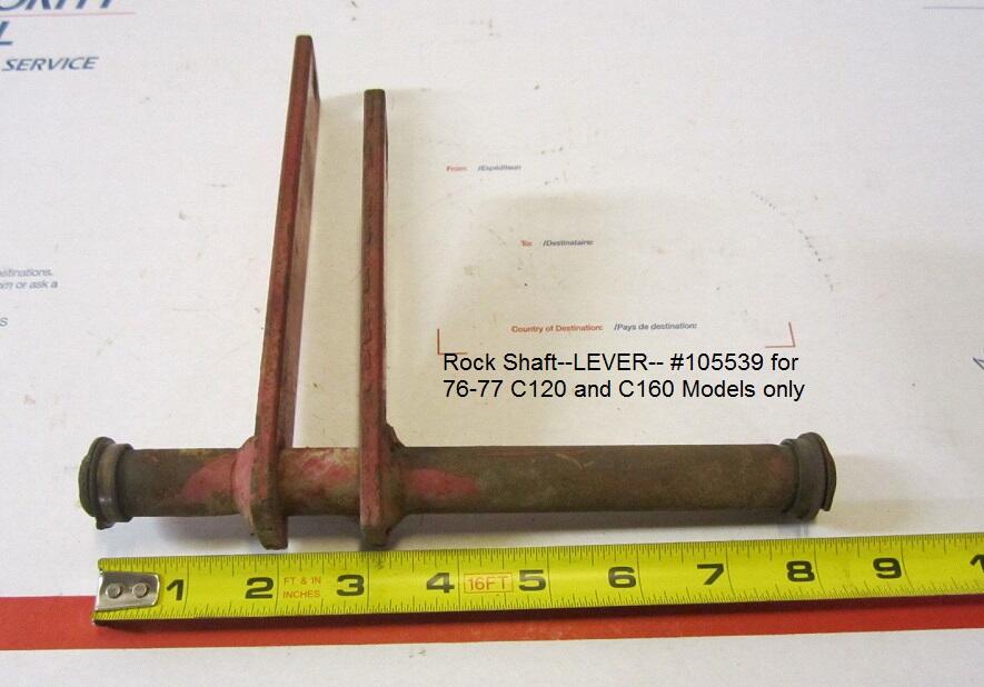

Moparfanforever 886 #2 Posted January 1, 2022 I thought it was part of this 8-5522 . It lists the shaft as a 105539 , but as you can see from the picture above, it is to wide. Share this post Link to post Share on other sites
daveoman1966 3,841 #3 Posted January 1, 2022 (edited) The wider one fits only the 76-77 C1-60 or C-120. It is too wide for other applications...unless it is cut down to fit. The narrow one with fit most other C series and the 300 -400-500 series too. Edited January 1, 2022 by daveoman1966 2 Share this post Link to post Share on other sites
