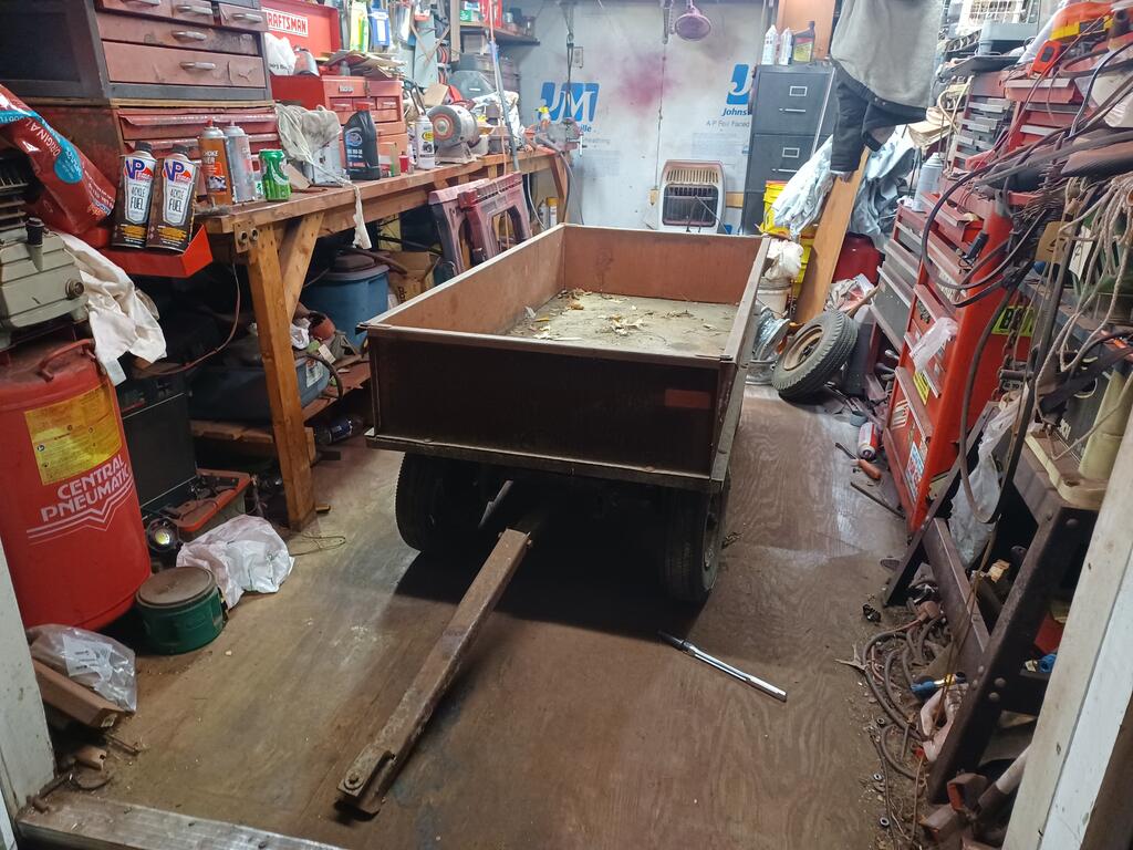

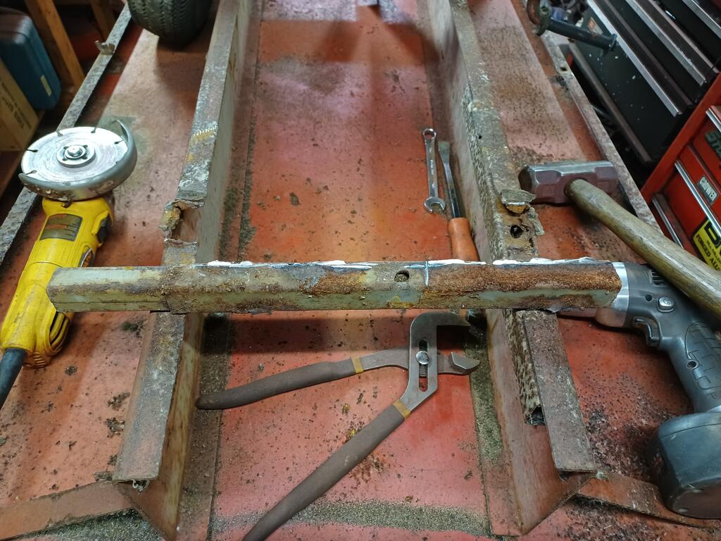

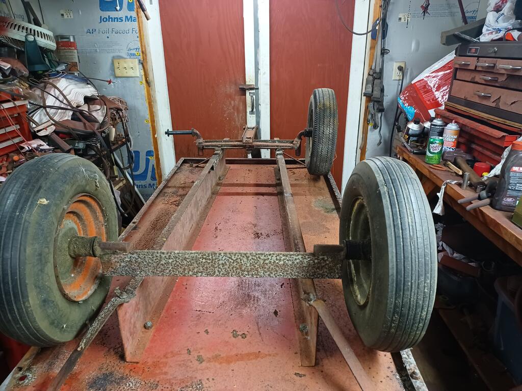

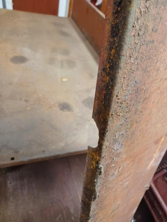

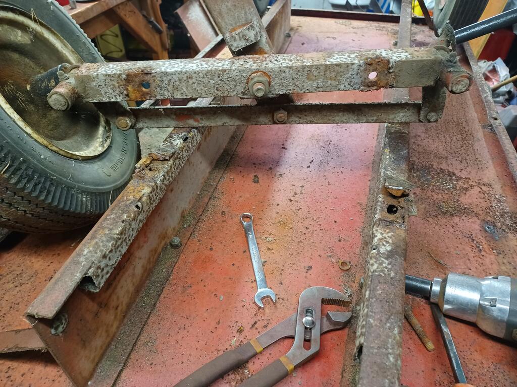

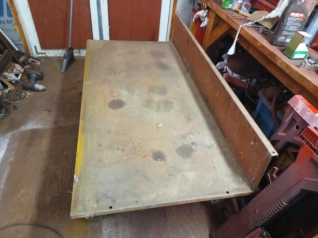

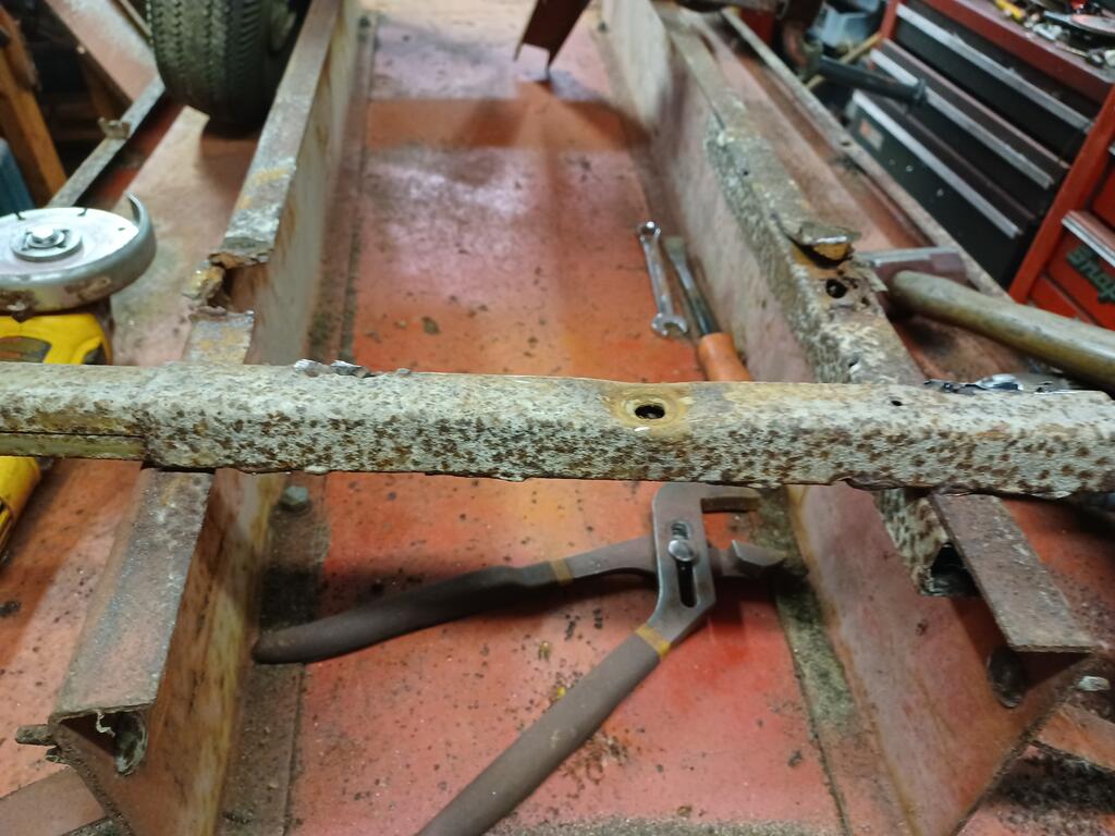

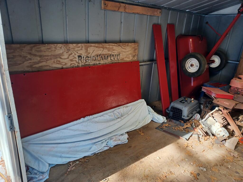

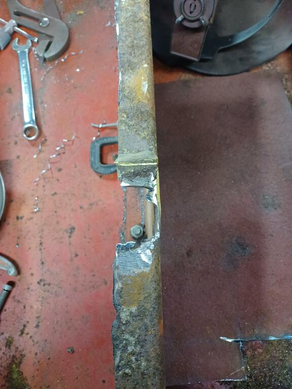

Elkskin's mower junkyard 1,117 #1 Posted January 1, 2022 Decided it was time to get wagon out and fix it. has i was disassembling i thought of ways to fix the front axle because i knew it was messed up. but before that i had to look at the long side panels which the one needs some repairs. now after i got the side panels off i flipped it over and looked at axle. i decided i am going to cut out the square tubing someone tried fixing it with before and i will bolt in some thick angle iron. that should keep it from breaking. i also have another idea for the bolts to hold sides to keep it from crushing the metal because i am not going to use wing nuts on the sides. i will put some sort of spacers in the holes. pictures may be out of order. i do not know model number of the wagon. its missing the decal for the serial and model. i do know i narrowed it down by the side panel decals but cant really remember lol 6 3 1 Share this post Link to post Share on other sites

Elkskin's mower junkyard 1,117 #4 Posted January 1, 2022 56 minutes ago, AMC RULES said: Suggesting that you may want to try putting that wagon back to it's original form as much as possible as there is some value in them as a W-H collectible. i do know that they are worth good money. i have no way of putting the square holes in the side panel once i fix the broken out area. the front axle situation is more along the lines of bracing and improvement. one original rim is missing i think i found a suitable replacement. Share this post Link to post Share on other sites
ebinmaine 76,155 #5 Posted January 1, 2022 11 minutes ago, Elkskin's mower junkyard said: way of putting the square holes I've used a regular drill bit to get the round size right then a triangle shaped file to get the corners squared. A bit of time occupied and works well enough. 4 1 Share this post Link to post Share on other sites

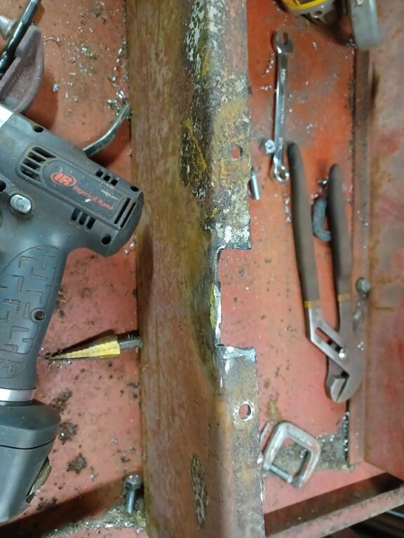

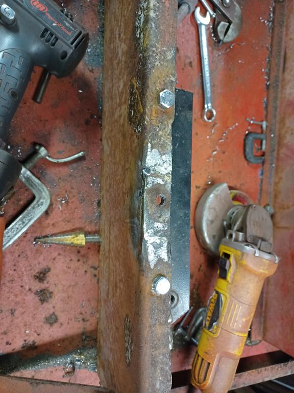

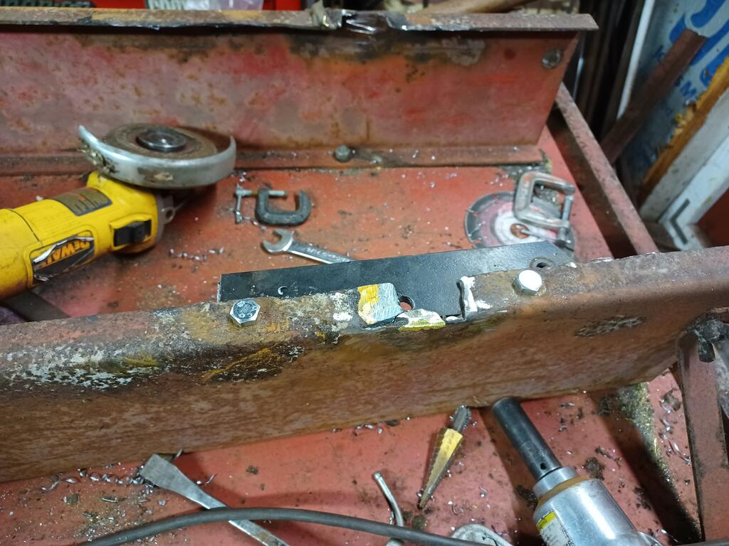

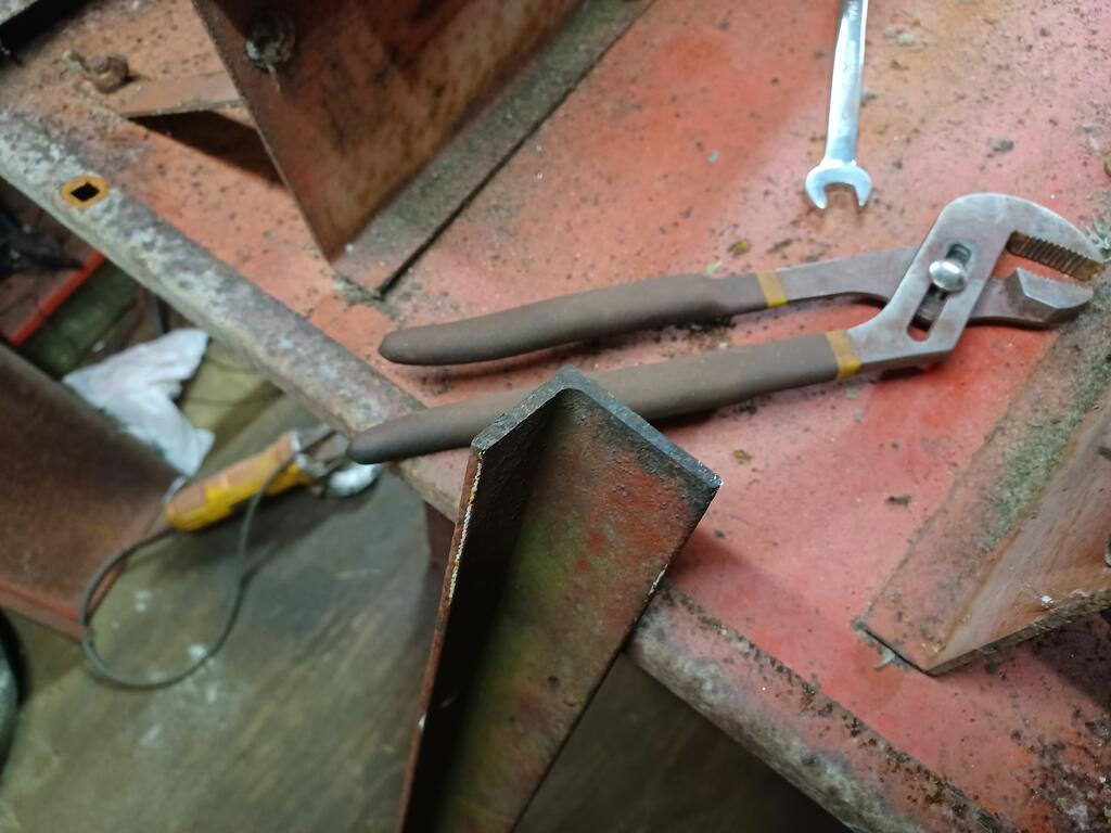

Elkskin's mower junkyard 1,117 #9 Posted January 2, 2022 Got some more done. i thought i would update on some things. so i cut out the square tubing. you can see its way too thin. then i looked at angle iron and didnt like it. so i found a thicker flat bar from a seat support on a simplicity rear engine rider. i cut a piece out drilled the holes and then i cut out the bad section. i found a piece of plate steel i had cut out a piece and welded it in. then i bolted the flat piece on the top drilled hole then put the flat piece back where it goes for strength. now i have to do the other side 4 1 Share this post Link to post Share on other sites

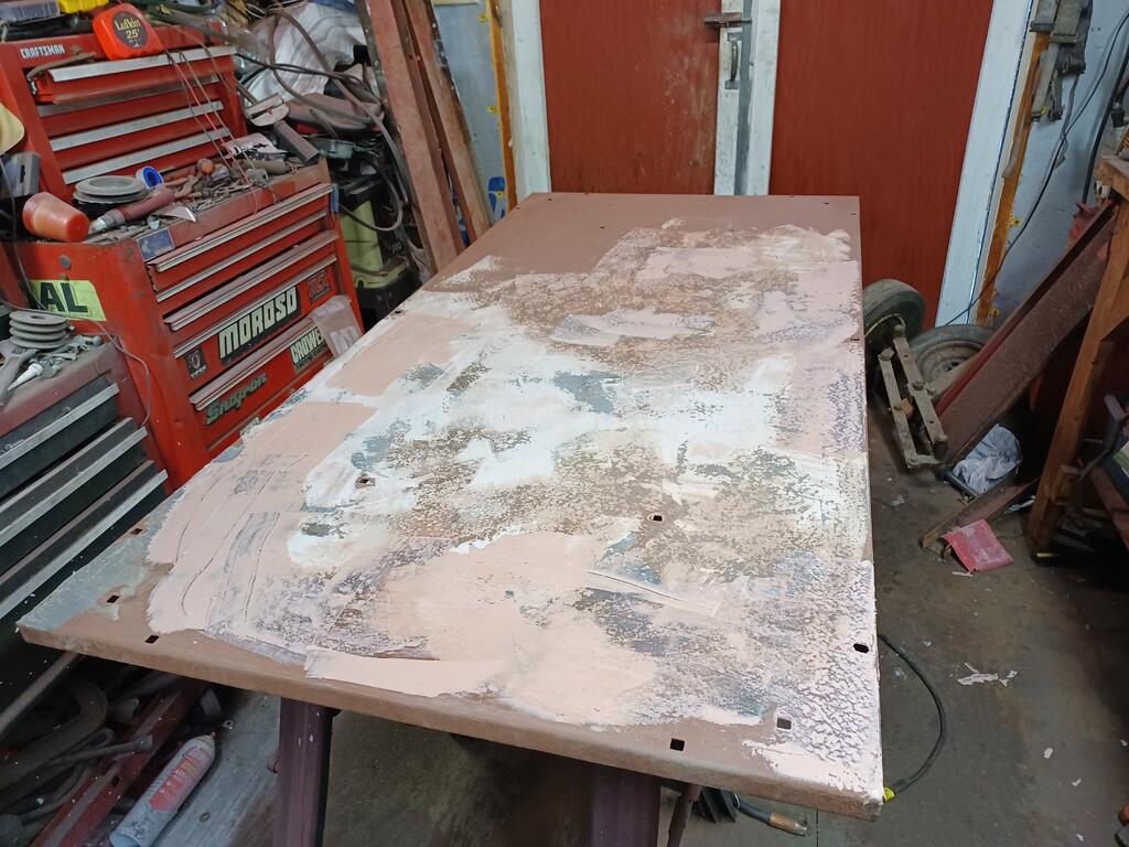

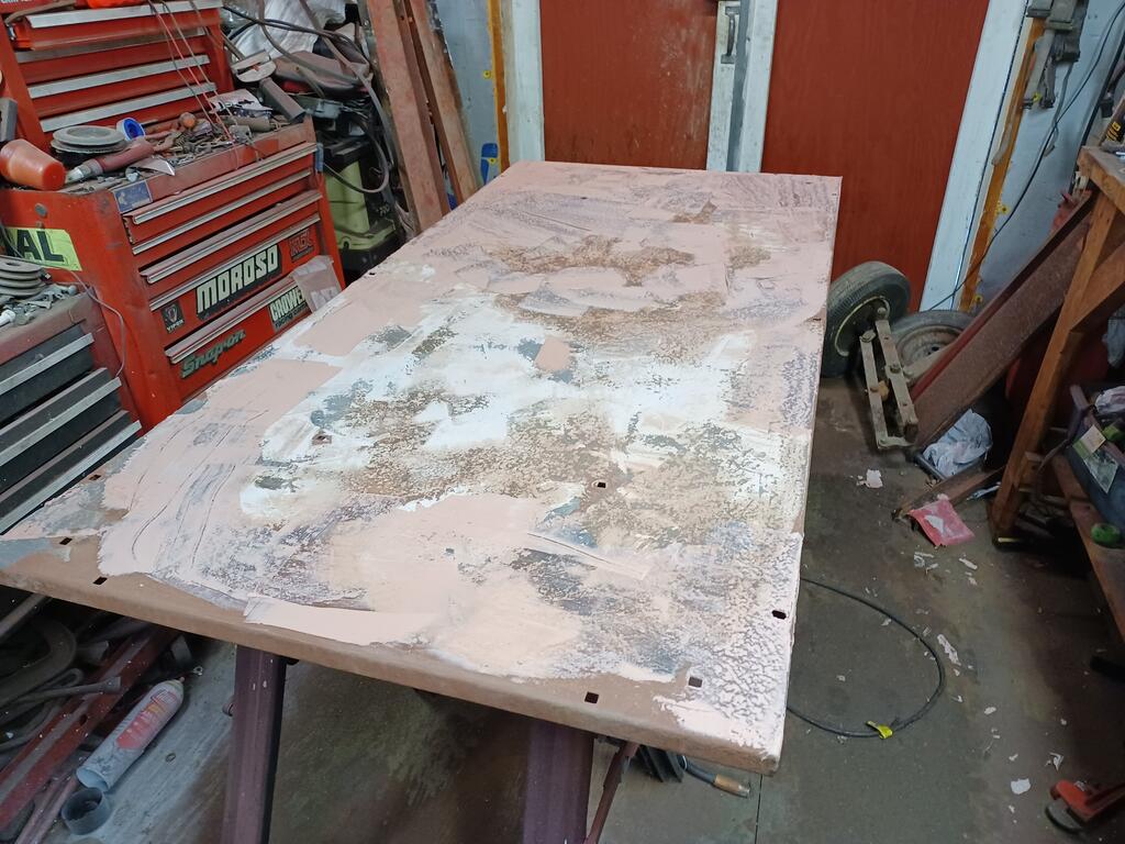

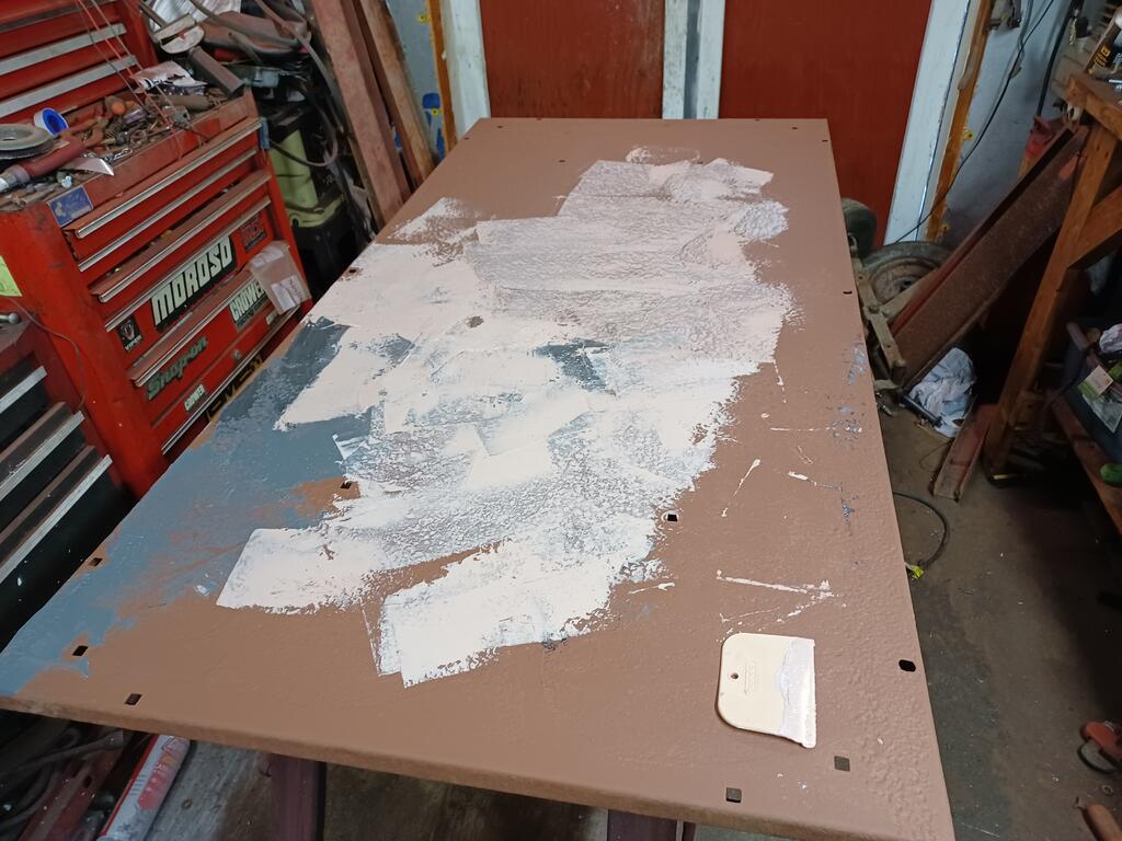

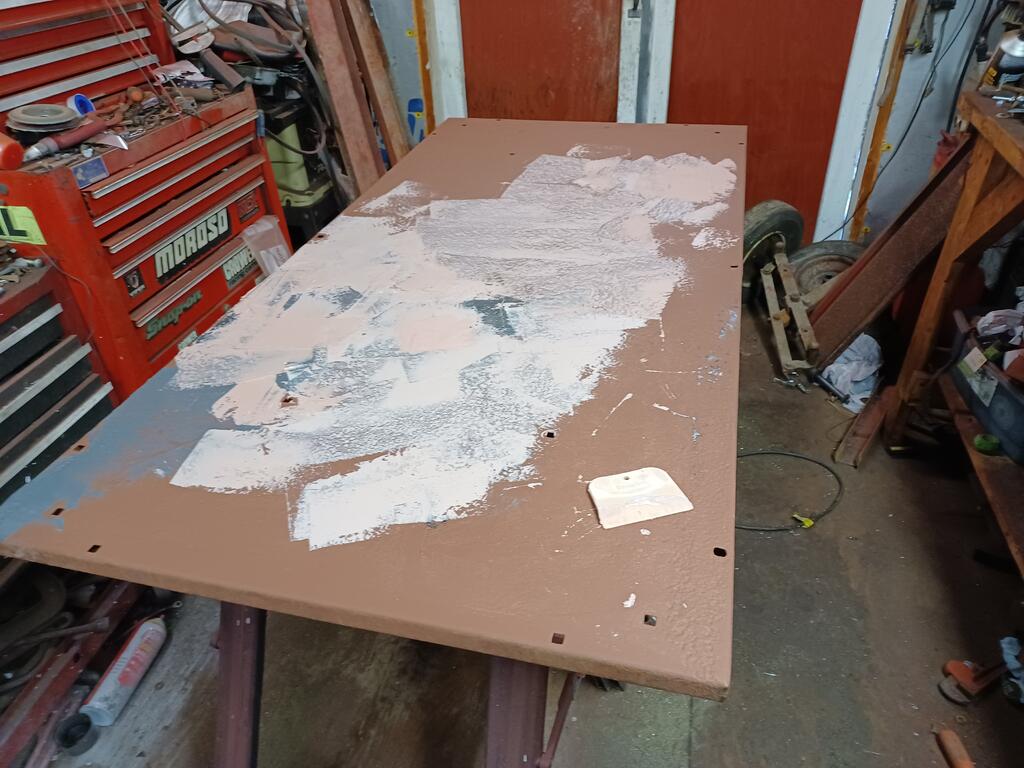

Elkskin's mower junkyard 1,117 #10 Posted January 3, 2022 ok guys a bit of a update. jb weld was taking too long to do it. so even though i dont like using bondo to fix pitted metal i went ahead and bought some anyway. i worked at it all afternoon and my hand and arm said are you done yet lol. so i got it alot smoother than it was. i did sand it down alot more than what the unprimered photos show so dont hopefully it wont crack lol. so i am debating on the bedliner still. it will hide some of the imperfections and add durability. for local shows i might put my 1964 24 inch tiller in the wagon so would be nice to make it where it wont get damaged easily. 4 1 Share this post Link to post Share on other sites

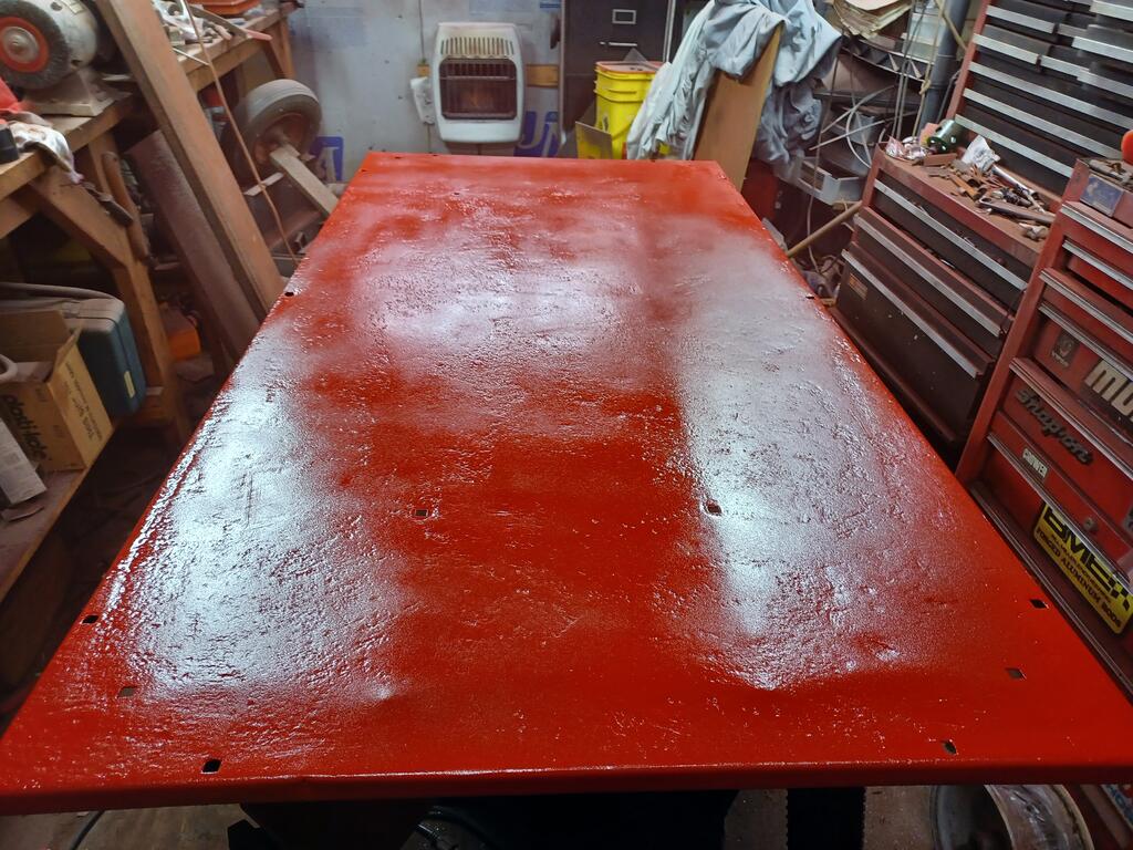

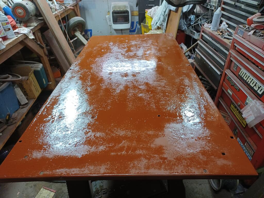

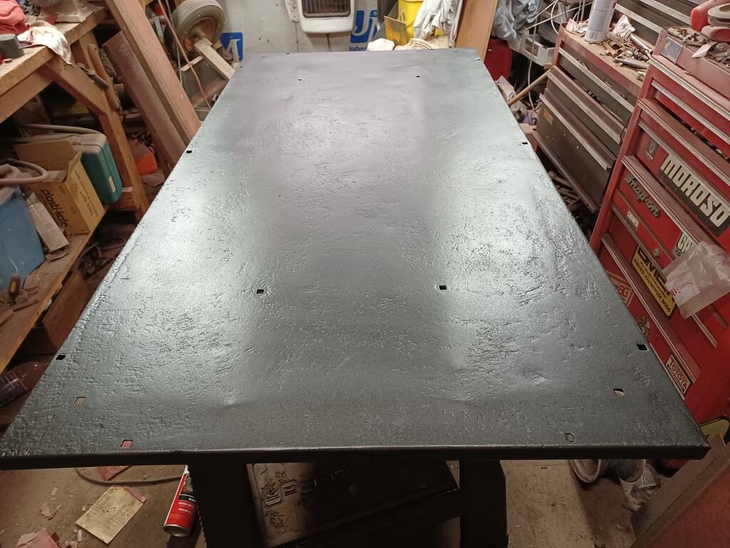

Elkskin's mower junkyard 1,117 #13 Posted January 4, 2022 Got bed liner laid down. It's not perfect but hey if it's too perfect I won't want to use it lol 3 2 Share this post Link to post Share on other sites

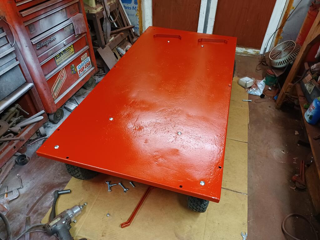

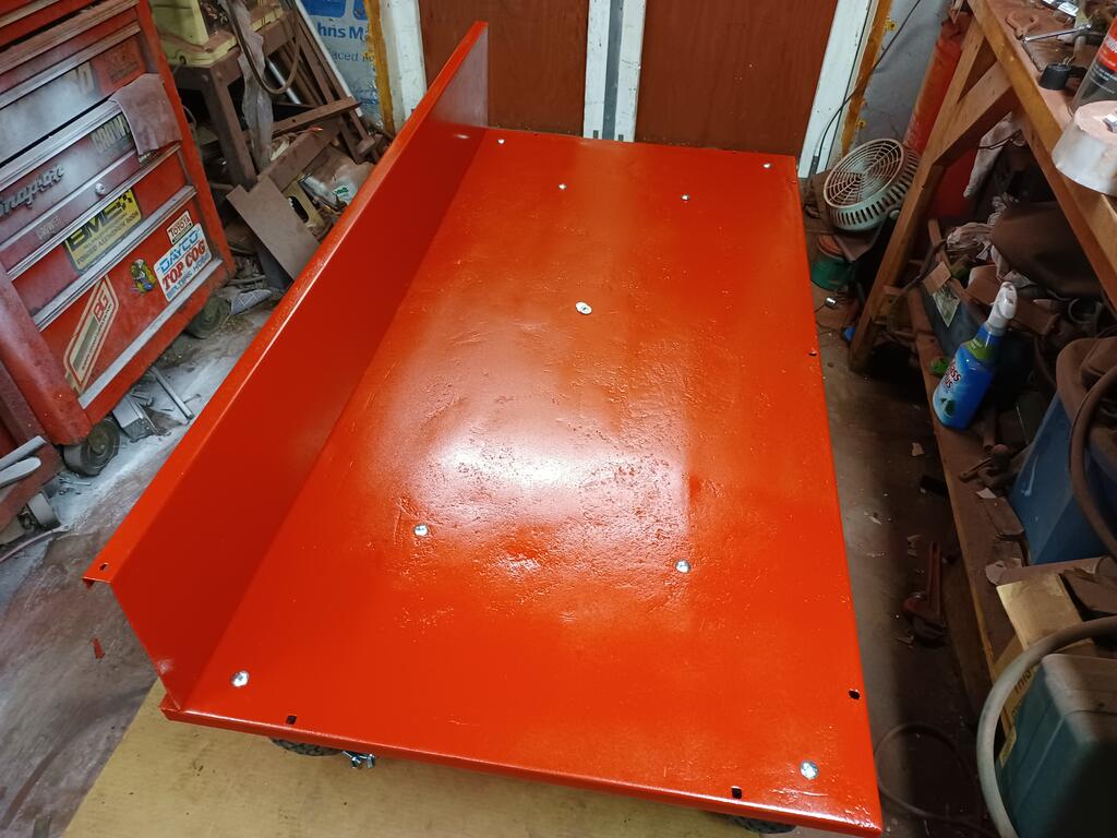

Elkskin's mower junkyard 1,117 #15 Posted January 6, 2022 I done the bottom of floor last night. Tonight I painted the top over the bed liner. Yeah I know bottom may get a couple dings being so fresh but that's not seen every day 3 1 Share this post Link to post Share on other sites
Elkskin's mower junkyard 1,117 #16 Posted January 9, 2022 Not much updates I got 2 long sides done and the frame rails and brackets. They are now in cold storage until I get rest done 4 2 Share this post Link to post Share on other sites

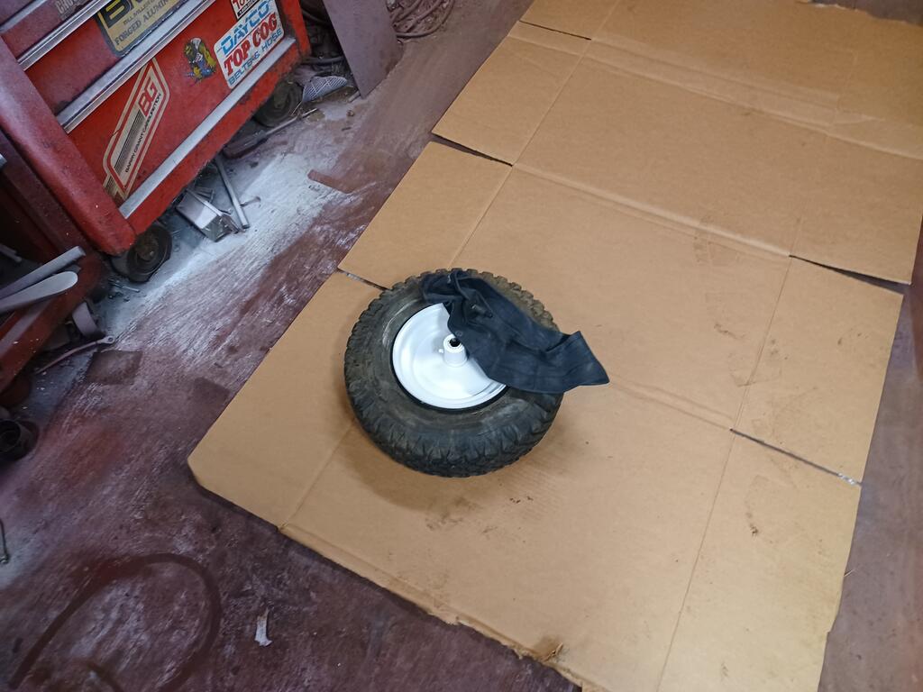

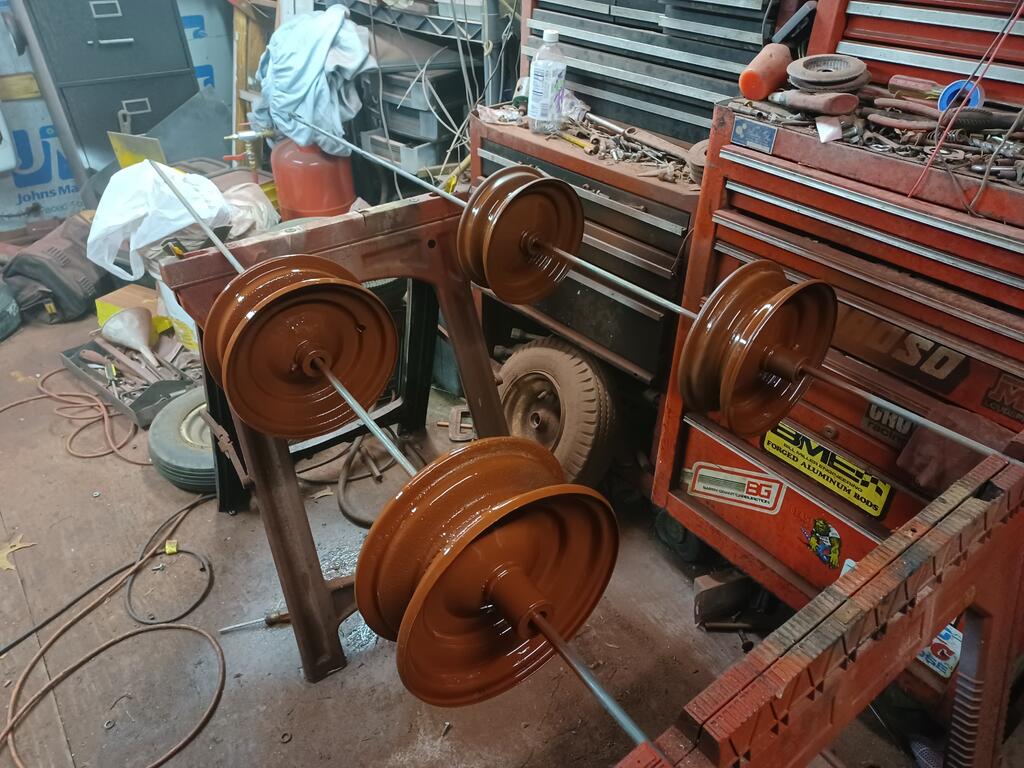

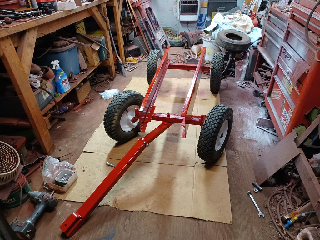

Elkskin's mower junkyard 1,117 #17 Posted January 12, 2022 Ran into a issue today. One of the original 3 rims is heavily pitted on inside. So I am going to work on that one later this year. Instead I had a pair of miscellaneous rims sitting in shed that I will use temporarily. 6 Share this post Link to post Share on other sites
Elkskin's mower junkyard 1,117 #18 Posted January 13, 2022 Assembly is underway. Now is cross breeding tires from John deere snowblowers illegal 🤣. 2 2 1 1 Share this post Link to post Share on other sites

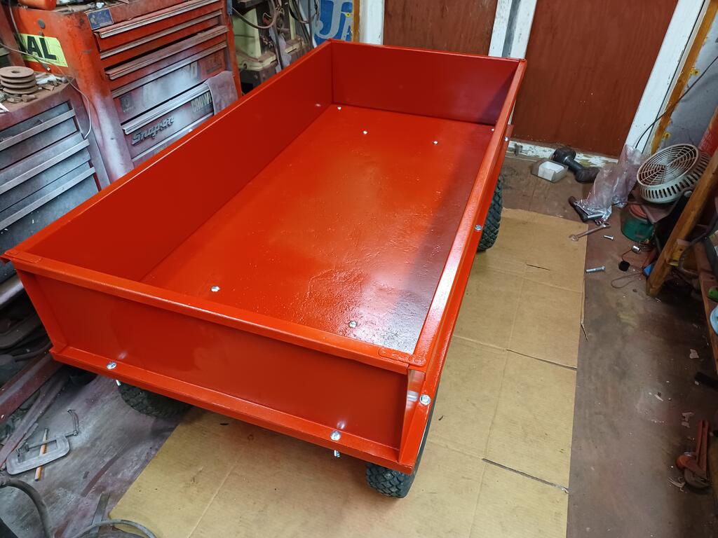

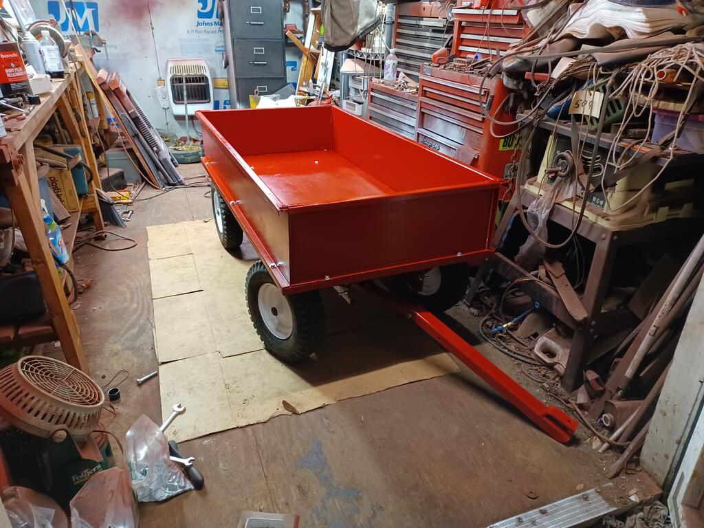

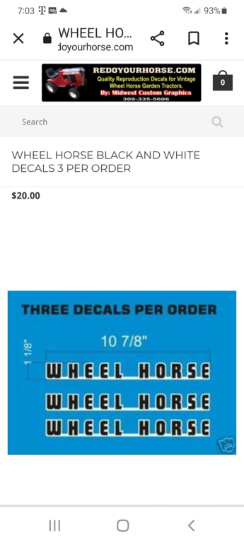

Elkskin's mower junkyard 1,117 #22 Posted January 14, 2022 It's together. I will wait a couple months for decals. But hey it looks a heck of a lot better. I will get better pictures Saturday hopefully. 3 7 Share this post Link to post Share on other sites
