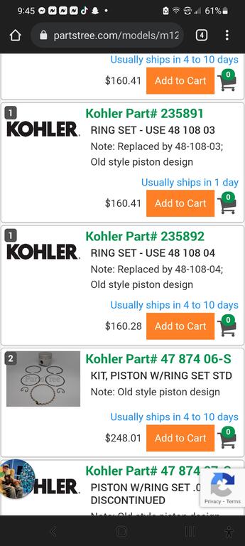

RED-Z06 2,716 #1 Posted December 30, 2021 Was thinking of picking up a set for when i have my M12 apart for a new governor gear next week... Now im thinking it'll be fine...yikes Share this post Link to post Share on other sites
tunahead72 2,617 #2 Posted December 30, 2021 This doesn't help much, but PartsTree has become one of the more expensive sources for genuine Kohler parts. You might try OPE Engines, usually a good bit less expensive, they also carry Stens parts if you're so inclined: Kohler Engines and Parts Store, OPEengines.com 3 Share this post Link to post Share on other sites
ebinmaine 77,350 #3 Posted December 30, 2021 4 hours ago, tunahead72 said: Stens parts That was gonna be my suggestion as well. Them or another reputable aftermarket company. 1 Share this post Link to post Share on other sites
Achto 31,017 #4 Posted December 30, 2021 (edited) 8 hours ago, RED-Z06 said: Now im thinking it'll be fine...yikes The old rings will probably be fine as long as you do not have to remove the piston. If you pull the piston out of the cylinder, the original rings will never seat again and you will have an oil burner. Here is one source for rings, OEM and after market. Note: I have not yet had an issue with the Rotary rings http://psep.biz/store/kohler_piston_rings.htm Also complete rebuild kits. http://psep.biz/store/kohler_rebuild_kits.htm Edited December 30, 2021 by Achto 2 2 1 Share this post Link to post Share on other sites
953 nut 64,127 #5 Posted December 30, 2021 From time to time you will find listings on for NOS Kohler parts at reasonable prices. Smeone clearing out a shop that has closed down liquidating inventory. 3 Share this post Link to post Share on other sites
rmaynard 16,869 #6 Posted December 30, 2021 The last set of Kohler rings that I purchased was about 5 years. The price was nowhere near those prices. They were made in Mexico. I'm pretty sure they came from eBay, but I don't remember who the seller was. Share this post Link to post Share on other sites
76c12091520h 4,115 #7 Posted December 30, 2021 Let me know what you need, I have over 75+ sets on hand, nowhere near those prices. 5 2 Share this post Link to post Share on other sites
Wheelhorse#1 1,901 #8 Posted December 30, 2021 (edited) Flea bay if you have the time to look.You Also have to be careful because some try to sell NOS but not always complete set. Thanks for the links Edited December 30, 2021 by Wheelhorse#1 Share this post Link to post Share on other sites
RED-Z06 2,716 #9 Posted December 30, 2021 15 hours ago, tunahead72 said: This doesn't help much, but PartsTree has become one of the more expensive sources for genuine Kohler parts. You might try OPE Engines, usually a good bit less expensive, they also carry Stens parts if you're so inclined: Kohler Engines and Parts Store, OPEengines.com Im a stens dealer...ive about given up on them, seems like everything i need when ordering is out of stock or 30% more than elsewhere...they used to be main distributor Share this post Link to post Share on other sites

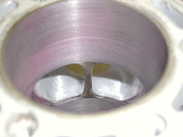

RED-Z06 2,716 #21 Posted January 1, 2022 1 hour ago, Gregor said: I am pretty ignorant when it comes to this real technical stuff, but I can tell you what I have seen on some 2 cycle Lawn Boy engines. I have not seen it often but some pistons are actually cast with a stop in the grooves. The rings cannot rotate. I assume this is to keep the ring gaps from passing over the intake and exhaust ports in the cylinder walls. Why some of them have this, and some don't, I have no idea, Maybe after some actual time in the real use world they discovered it wasn't working out so well. Yes in general 2 strokes use a pinned ring or rings to keep them aligned with solid cylinder wall and keep them awat from the ports. The exception is if the port has a "tonsil" or a full bridge that extends down and provides support for the ring, these older engines were among the longest lived, such as the older homelites, power products engines, etc 3 Share this post Link to post Share on other sites
