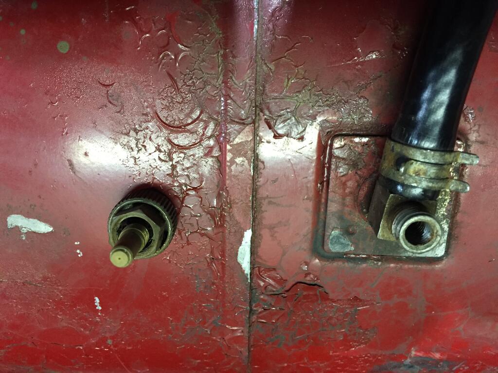

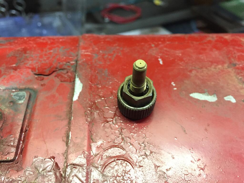

JimSraj 559 #1 Posted December 23, 2021 (edited) Thought I was ready to turn the key on the Raider 12 with the newly rebuilt K301S installed and mostly new wiring. When I started putting gas in the tank I had the tank valve shut until I’d added about a quart or so. Then I opened the valve and a very small stream of gas started to flow into the filter then stopped. Checking the valve showed it to be leaking so I drained the tank, removed it and took the valve apart. A small piece of what looks like the remnants of a leather seal (2nd picture) was found on the stem of the valve. Anyone know if that was leather or rubber? Better yet what I can replace it with? Exact id, od and material diameter are probably important. Edited December 23, 2021 by JimSraj Correction Share this post Link to post Share on other sites
8ntruck 8,259 #2 Posted December 23, 2021 When this happened on my 14-8, took the valve stem to the local hardware store and found a replacement o ring in the small parts drawers. Basically matched the size with the old one. That was about three years ago - still holding. 5 Share this post Link to post Share on other sites
Achto 30,047 #3 Posted December 23, 2021 If you can't find a seal, here is another option. https://www.amazon.com/Stens-120-279-Inline-Shutoff-Valve/dp/B001OK9VZ0/ref=asc_df_B001OK9VZ0/?tag=hyprod-20&linkCode=df0&hvadid=198060922766&hvpos=&hvnetw=g&hvrand=10984613070967050322&hvpone=&hvptwo=&hvqmt=&hvdev=c&hvdvcmdl=&hvlocint=&hvlocphy=9018822&hvtargid=pla-351474322793&psc=1 3 Share this post Link to post Share on other sites
peter lena 9,518 #4 Posted December 23, 2021 @Achto agree with you on that new fresh valve replacement , just the idea of getting rid of the problem , is a should do replacement . always have a fresh new tank valve in my spare parts , any issues , just change it out . detail recommendation , use some dielectric grease on those related o ring to tank fitting / sealing . that grease is super lube rated , for easy installation and no rubber effects , pete 1 Share this post Link to post Share on other sites
JimSraj 559 #5 Posted December 24, 2021 Thanks guys. I tried a couple ‘O’ rings but none would seal when the valve is open. I did order a Stens replacement (thanks Achto) but in the meanwhile, being anxious to turn the key, I packed the valve stem with plumbers valve packing. It worked! She’s running! Found some fuel leaking from the new fuel pump so I’m not able to get her carb adjusted until I sort that out but I’m pretty pleased that my first rebuild worked out. A BIG THANK YOU to all of you that shared advise, knowledge and encouragement along the way. 4 Share this post Link to post Share on other sites
