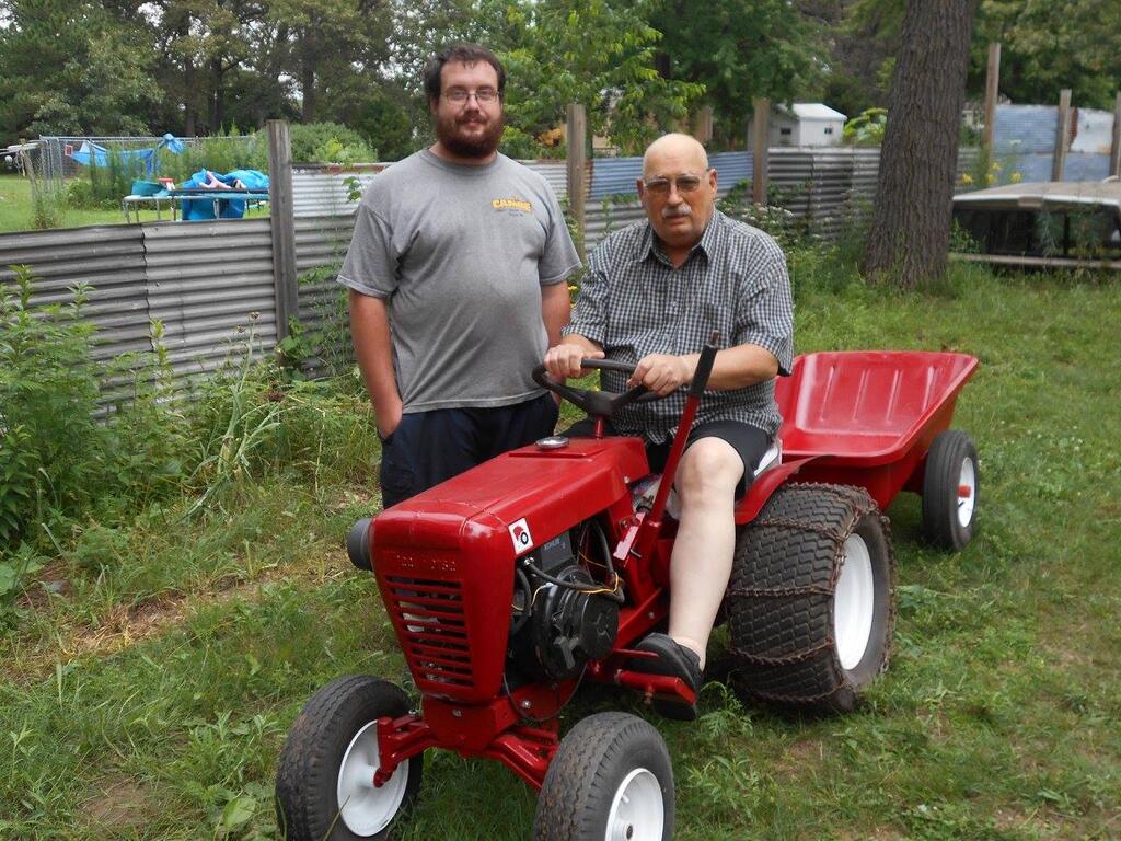

Will a Kohler M8 8hp fit on a 702, looks to be the same engine as the K161 size except the carb and air filter stick out more. The pto shaft is the correct size.

yes a magnum 8 will fit. use the k161 airbox. i also used the m8 relocated throttle and choke controls.

i forgot to add in previous post leave breather tube vent into atmosphere like the k series did.

Pictures of how you ran the throttle and choke cables would be appreciated. Also mine is an electric start.
