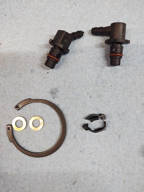

Joe 77 B100 84 #54 Posted January 4, 2022 Well, I got it running but the new fuel pump broken when I was putting it together. You know how you have to fit the two adjustable fuel ports to the side? And you have to use that metal ring to push in both sides at the same time? Well, when I used the metal ring, it broke the pieces it was supposed to just bend enough to insert the ports. Now I have a fuel leak from the new pump. The image shows the plastic ring that is supposed to be in the female part where the ports go in but it broke. I guess I should have paid the $70. 2 Share this post Link to post Share on other sites

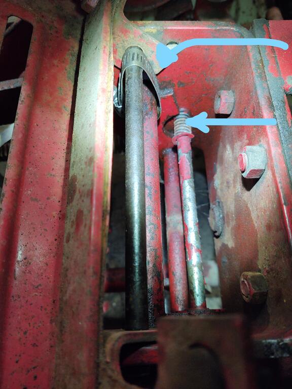

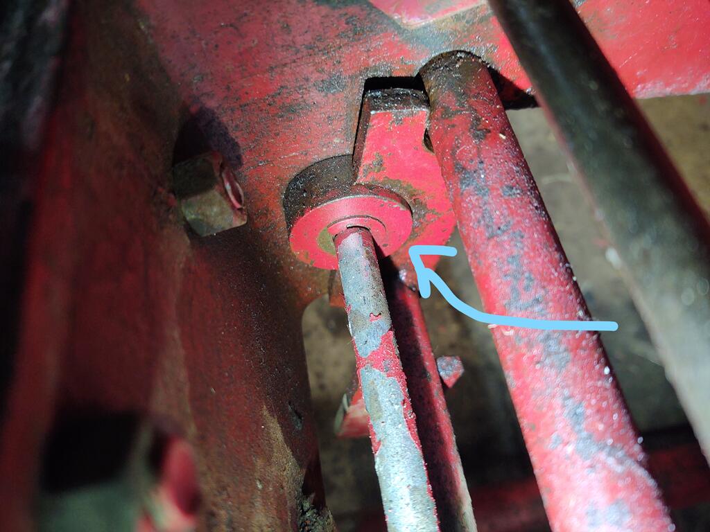

Joe 77 B100 84 #55 Posted January 7, 2022 The second, cheap fuel pump they sent me did the same thing. But, this time, it didn't leak. New issue; can anyone help me out here? I got the mower running and it purrs like a kitten. When I went to put the hood back on, I noted that one of the parts for the snowblower is missing and it doesn't attach to the mower correctly. In this pic, you can see down where the hood and snowblower attach to the mower, there is a round, thick washer that fits into a half-moon cutout on the snowblower to support it. The blue arrow is pointing to it. On the other side, they put a clamp on the bar (above arrow) to hold the snowblower on the other side because that round, thick washer is missing. There is an arrow and spring where it should be. Anyone know what size that washer is OR have a part number for me? I am not sure if it is a snowblower part (I don't think so from a cursory online search) or if is some kind of harness part or part of the mower. Share this post Link to post Share on other sites
Handy Don 17,489 #56 Posted January 7, 2022 See post #5 in the thread linked below. BTW, It is not good forum etiquette to ask the same question in two different topics. 1 Share this post Link to post Share on other sites
