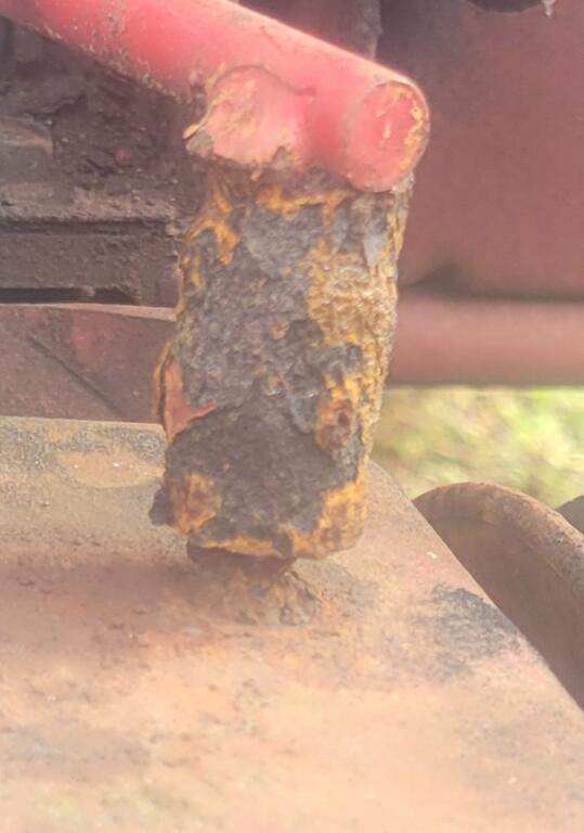

RED-Z06 2,718 #1 Posted December 19, 2021 Really disappointed to find this on my newly acquired 312-8..of course ita in low range. 2 Share this post Link to post Share on other sites

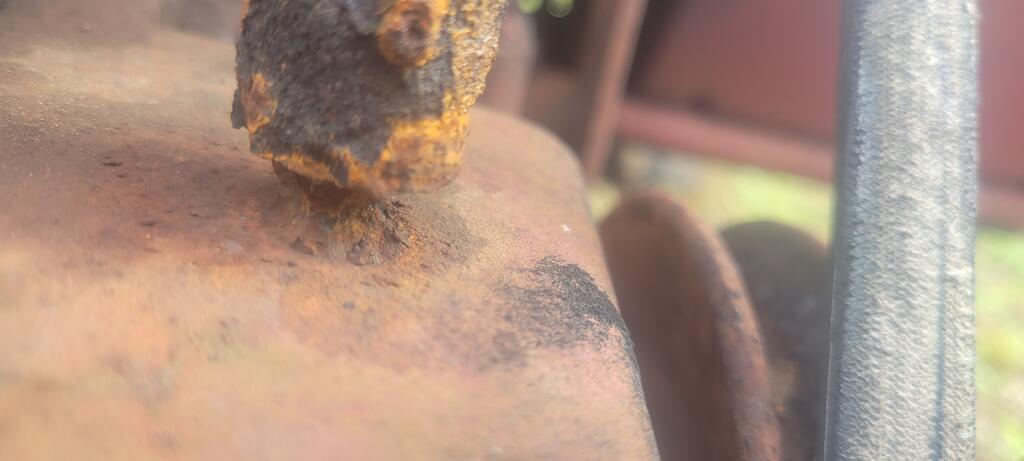

rmaynard 16,886 #2 Posted December 19, 2021 Looks like that tranny sat out in the rain for a long time. If I'm seeing it correctly it looks like most of the shaft is rusted away. You might have to crack her open and see what's going on inside as well. If you weren't so darned far away, I have a nice 8-speed from a '92 416-8 for sale up here in MD. 1 Share this post Link to post Share on other sites
RED-Z06 2,718 #3 Posted December 19, 2021 I had some knock er loose left in an old can...dribbled it on, hit it with the blow torch for about 2 minutes, more knock er loose, then vice grips on the shifter stub...kept repeating this and darned if it didnt come loose, shifts clean between Hi and Lo now...id have never believed it to be possible without snspping that stub clean off. Yeah 16 years in the weather...but get this, no water in the trans, no slurry, no milk...no rust on the dipstick. The shift boot hung in long enough to keep water out. 8 Share this post Link to post Share on other sites

wallfish 19,374 #8 Posted December 19, 2021 Amazing! Well, the gear oil can seep in enough to get those hubs loose too so guessing the gear oil did it's job on the bottom of that shaft too. How do you "beef it up" now so it doesn't just snap off from the leverage of the handle? Or do you think it will last? Share this post Link to post Share on other sites

RED-Z06 2,718 #10 Posted December 19, 2021 2 minutes ago, wallfish said: Amazing! Well, the gear oil can seep in enough to get those hubs loose too so guessing the gear oil did it's job on the bottom of that shaft too. How do you "beef it up" now so it doesn't just snap off from the leverage of the handle? Or do you think it will last? Short of pulling it apart and replacing the shift fork and lever not much. Itll last..i rarely use low range Share this post Link to post Share on other sites
