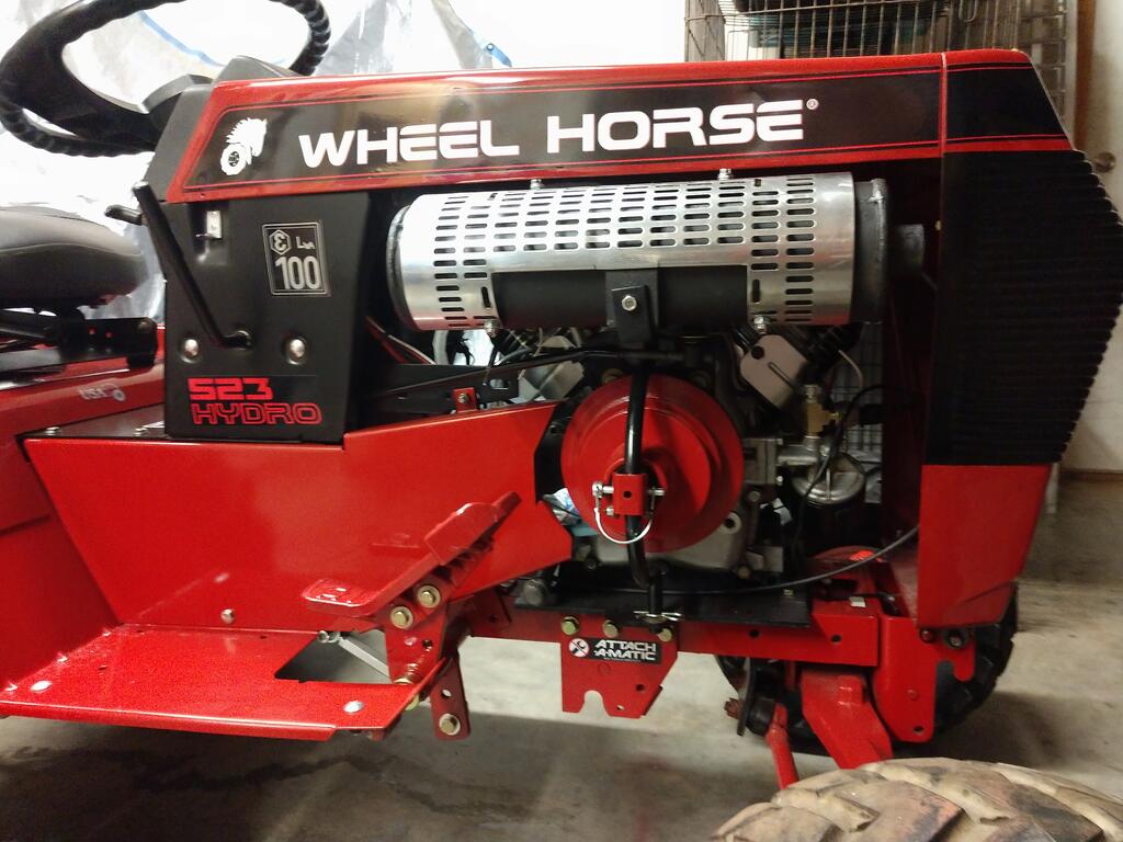

kpinnc 17,154 #6 Posted December 19, 2021 Agree with what has already been said. Might be a simpler fix than you think. I'm no purist- not one of my tractors is all original. That being said, that is a nice looking machine. If there ever was a candidate for keeping original, you already have it. ...and if you have no other options, the Vanguards are good engines. I have 3 of them... 2 Share this post Link to post Share on other sites

kpinnc 17,154 #9 Posted December 19, 2021 (edited) 1 hour ago, RED-Z06 said: I had a deere in that was swapped from an 18hp onan to a 20hp Vanguard, very smooth and responsive but you could feel the lighter rotating mass under load, that massive onan flywheel stores alot of energy I swapped in a 14hp Vanguard on a 520-H for a while, and it struggled far less than my Onan 518-H when mowing with the same 48 deck in heavy grass. The Vanguard never even pulled the governor, while the Onan most definitely did. Both did the job well, but the Onan seemed more sensitive to loading. I would say that the nose of the tractor is definitely lighter- maybe as much as 75lbs so, but power should be no different from comparable HP rating between the two. And the Vanguards drink far less fuel. Edited December 19, 2021 by kpinnc 1 Share this post Link to post Share on other sites
wh5208speed 669 #10 Posted December 19, 2021 14 hours ago, kpinnc said: Agree with what has already been said. Might be a simpler fix than you think. I'm no purist- not one of my tractors is all original. That being said, that is a nice looking machine. If there ever was a candidate for keeping original, you already have it. ...and if you have no other options, the Vanguards are good engines. I have 3 of them... That is a sweet setup. How did you mount the exhaust shield without the tabs that comes on the Onan muffler? Share this post Link to post Share on other sites
kpinnc 17,154 #11 Posted December 19, 2021 4 hours ago, wh5208speed said: That is a sweet setup. How did you mount the exhaust shield without the tabs that comes on the Onan muffler? The Vanguard muffler had a partial shield already welded on. I just used sheetmetal screws to mount the WH one to it. Share this post Link to post Share on other sites
