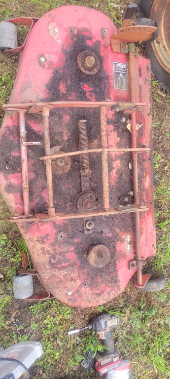

RED-Z06 2,720 #26 Posted December 19, 2021 Ouch...deck is very DOA...left side is busted through...shes scrap unfortunately, might save the roller bar, handle, a few bits if they come off 1 Share this post Link to post Share on other sites
Handy Don 17,462 #27 Posted December 19, 2021 1 hour ago, RED-Z06 said: Ouch...deck is very DOA...left side is busted through...shes scrap unfortunately, might save the roller bar, handle, a few bits if they come off Yep, a goner. 1 Share this post Link to post Share on other sites

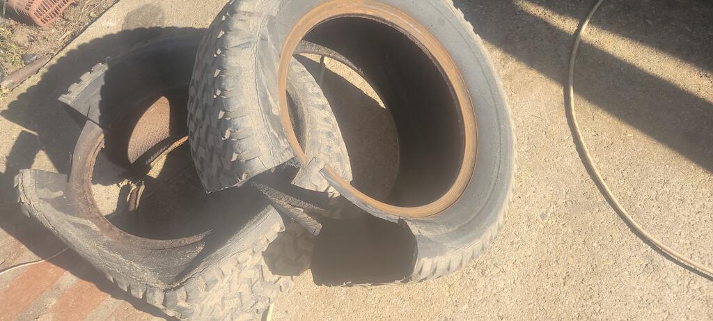

RED-Z06 2,720 #30 Posted December 24, 2021 Welp...got the rear tires cut off, wheels cleaned and ready for the new rears but...delayed delivery by FedEx until next week...so that sucks. 1 Share this post Link to post Share on other sites

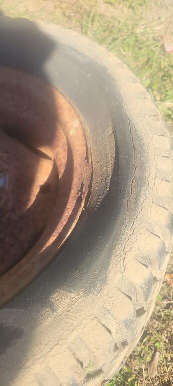

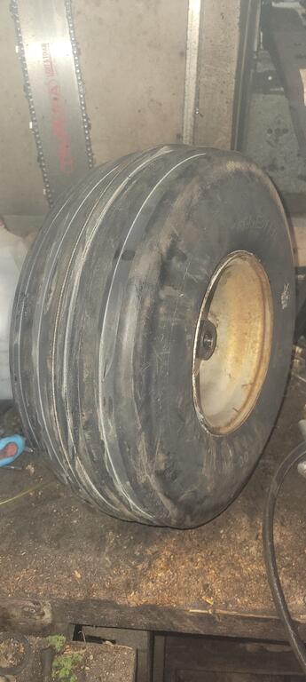

RED-Z06 2,720 #31 Posted December 24, 2021 I set my angle grinder on fire cutting off the rear tires...had to cut them open then split the metal bead with a chisel...totally rusted in place. 2 1 Share this post Link to post Share on other sites

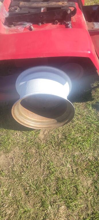

RED-Z06 2,720 #32 Posted December 24, 2021 Seat frame is on, wheels are ready..spacers on, just needs the tires and a seat. Both headlights are burned out...led par36 upgrade time 4 Share this post Link to post Share on other sites

953 nut 69,148 #36 Posted December 25, 2021 8 hours ago, RED-Z06 said: .had to cut them open then split the metal bead with a chisel...totally rusted in place I have had good results with a scraper blade made for a Sawzall. 1 1 Share this post Link to post Share on other sites
Handy Don 17,462 #37 Posted December 25, 2021 18 hours ago, 953 nut said: I have had good results with a scraper blade made for a Sawzall. I like those blades, especially the diamond-edged offset cutter. I have the Fuel model of that M12 Hackzall and it's a worker, for sure and these are going on my list! Thanks! 1 Share this post Link to post Share on other sites

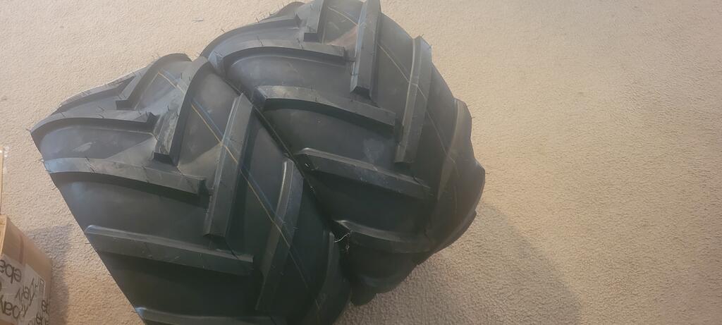

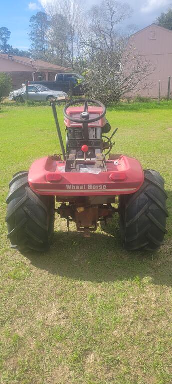

RED-Z06 2,720 #39 Posted December 26, 2021 24x12x12 on a 9.5" (recommended by manufacturer) tucks in nicely with spacers...brand is K9 Power. 1 Share this post Link to post Share on other sites

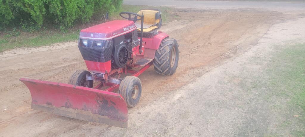

RED-Z06 2,720 #43 Posted December 26, 2021 Blade went on and moves dirt...excellent 1 Share this post Link to post Share on other sites
