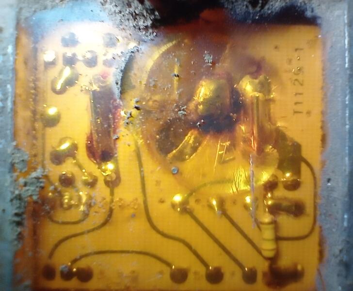

nyquil junkie 225 #10 Posted December 20, 2021 (edited) Fortunately it has a clear epoxy cover to see... yup its burnt. I just got the $14 Amazon special (made of the best Chineseium available) in the mail today so.... repairs underway. eDiT: That fixed it... now it runs at 14.6v at full throttle, 13.5 ish at low idle. Good enough. Edited December 20, 2021 by nyquil junkie 2 2 Share this post Link to post Share on other sites
