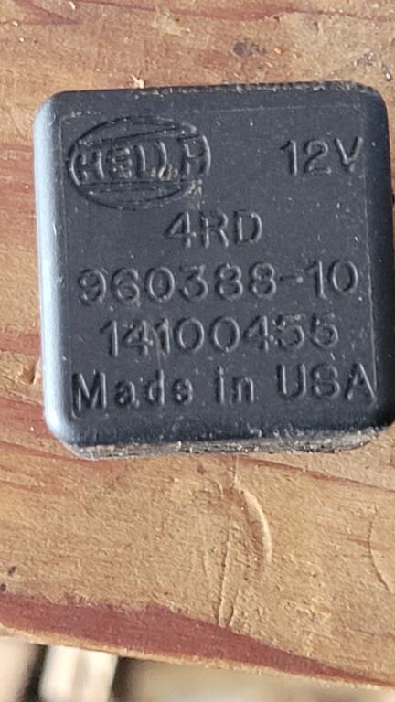

buckhornbob 13 #1 Posted December 15, 2021 I have an older 522xi and have narrowed down a starting problem to the relay - it is quite rusted and corroded inside The print on mine is Hella 12v 4RD 960388-10 14100455 Can anyone tell me where I might get a compatible replacement in Canada. Some USA sites advertise these but want more for shipping than the part costs. Is there a suitable replacement from another manufacturer. I don't know much about these and I could sure use some advice so I don't do any damage to my electrical system om the tractor. Thanks Bob Share this post Link to post Share on other sites
squonk 45,809 #2 Posted December 15, 2021 (edited) Does it look like this? You can find it in many cars in a junkyard. Common relay. Or any auto parts store. Napa # AR204 Edited December 15, 2021 by squonk 1 1 Share this post Link to post Share on other sites

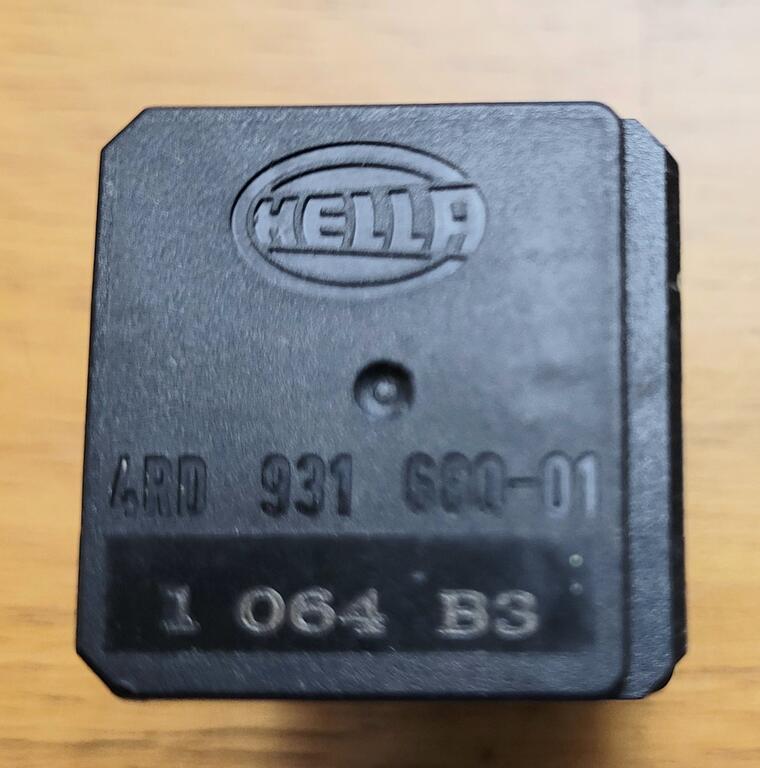

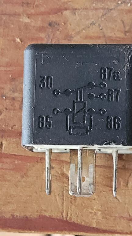

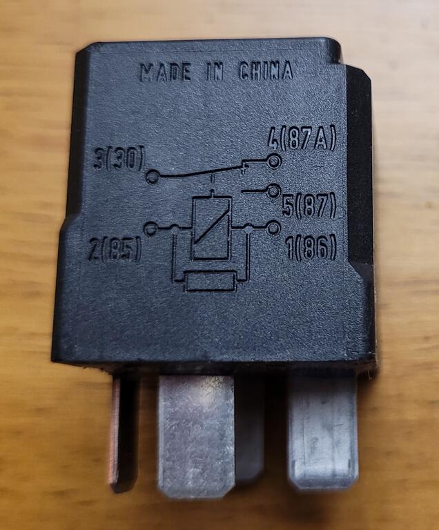

buckhornbob 13 #4 Posted December 15, 2021 Looks similar. Seems like the Napa one should work. A neighbour offered one he had in his shop (the last two pics) but I wasn't sure if the diagram was different. Also, it only fits if it is turned 90 degrees so the stamp on the top is not aligned with the other two relays. 1 Share this post Link to post Share on other sites
squonk 45,809 #5 Posted December 15, 2021 (edited) Yes it's the same relay. The probably put the plastic cover on different. The circuitry and terminals are the same. Look at the white base. THere should be numbers to tell which blade is what numbered terminal. Edited December 15, 2021 by squonk 2 Share this post Link to post Share on other sites
