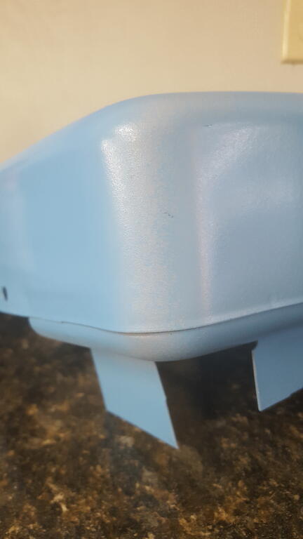

Gregor 4,847 #12 Posted December 16, 2021 One of the pitfalls of painting with a gun, and custom mixed paint. A bare spot inexperienced painters leave. I guess that's what these are for. 2 Share this post Link to post Share on other sites
