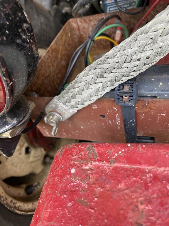

peter lena 9,559 #1 Posted December 14, 2021 an idea for grounding issues, https://www.amazon.com/JJHXSM-Braided-Connecting-Equipment-phy=9003310&hvtargid=pla-1436170297405&psc=1 , source for flexible hood grounding , or use the idea and make up your own . if your chassis is grounded to your battery ground cable bolt , this is a simple addition , to make your lighting brighter , clean connections / dielectric grease , just an idea , pete 2 1 Share this post Link to post Share on other sites
Maxwell-8 4,370 #2 Posted December 14, 2021 They came in extra on my horse, even though it wasn't installed on my raider. 1 Share this post Link to post Share on other sites
peter lena 9,559 #3 Posted December 14, 2021 @Maxwell-8 since enhancing grounding on my 3 horses , my electrical issues have gone away. its a chronic issue on horses, cracked / corroded / chafed wiring ." you have to get angry at it , fed up with constant problems ", eliminate old dried out shorted wiring . think ,I've been there in most areas , rewire , isolate , wire wrap everything , use secure hangers , reroute problem areas , dielectric grease at every make up point , hard wire ground from battery ground bolt point , down to engine corner , clutch pedal area , 4 ga cable , electrical lug at engine corner , 10-12 ga from there to rectifier ,mount bolts , and from there to headlights / taillights. one solid well connected ground leader , from battery ground to lights , this also enhances the dash hook ups . tried it on one horse , very solid , duplicated it on the other 2 horses . consistently works , no issues, pete 1 2 Share this post Link to post Share on other sites

kpinnc 16,222 #8 Posted December 15, 2021 These are definitely a good fix for headlights that have flaky grounds through the hinge pins. 2 Share this post Link to post Share on other sites

Jeff-C175 7,207 #10 Posted December 15, 2021 These look to be VERY thin metal on the lugs, and the crimp... well... that's not really what I call a crimp at all. I'm down with the flat braid ground straps, very flexible, etc, but those... well... they are off my radar. I think those lugs would break and come loose in like NEGATIVE time. In other words, loose before you even bolt them down. THIS is a crimp lug. But who owns a crimper that will handle those? So instead, you squeeze with vice grips and then solder them. If one wanted to purchase pre-made, they would be MUCH better off spending about twice the money and getting some of these: https://www.digikey.com/en/products/detail/falconer-electronics-inc/1-2-03-008/11609860 2 1 1 Share this post Link to post Share on other sites

Jeff-C175 7,207 #14 Posted December 15, 2021 How long do you guys think that gum wrapper twisted around that UNtinned copper is gonna give a good connection regardless of the current? Seriously, those things are garbage, just look at them! Share this post Link to post Share on other sites
Jeff-C175 7,207 #15 Posted December 15, 2021 (edited) 34 minutes ago, RED-Z06 said: not like we are pushing 300 amps thru them No, of course not, all you really need is a low resistance connection that would pass a couple amps at most. That wire could be pulled right outta that lug. It's garbage, even for one milliamp. Would y'all just twist a couple wires together and wrap them with electrical tape and call it good? Ya might as well if you think using garbage like that is a good idea. Edited December 15, 2021 by Jeff-C175 1 Share this post Link to post Share on other sites

peter lena 9,559 #17 Posted December 15, 2021 @Jeff-C175 THOSE BOLT ON ELECTRICAL LUGS , are a great bolt TOP washer , just unscrew the threaded link and add what ever you want . like going from a 4 gage cable to a 10- 12 wire . simple and bombproof . pete Share this post Link to post Share on other sites

Jeff-C175 7,207 #22 Posted December 16, 2021 (edited) 42 minutes ago, RED-Z06 said: How many pounds of dead weight should a ground strap hold🤣 I mean if the ground straps are what holding your rig together structurally you have other problems to address That's not really the point. The point is that if the photo on amazon is accurate, the so-called crimp of that aluminum foil gauge ring lug is totally unacceptable. A proper crimp connection has to provide mechanical strength and crimp tightly enough so as to exclude oxygen (specs and standards typically call this "gas tight") which would oxidize the metals which over time would increase the resistance of the wire / lug interface. Folding thin metal over the wire and pressing flat does neither of those things. Edited December 16, 2021 by Jeff-C175 1 Share this post Link to post Share on other sites
formariz 12,352 #23 Posted December 18, 2021 On 12/15/2021 at 8:29 PM, Jeff-C175 said: Folding thin metal over the wire and pressing flat does neither of those things. I use flat ground straps but they are built a bit differently. The strap actually is inserted all the way to the end of lug then soldered and crimped. Looks like it was then drilled or punched . I think I can tow with these. 1 2 Share this post Link to post Share on other sites
